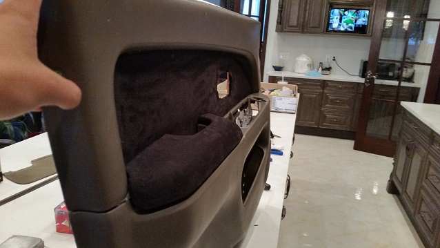

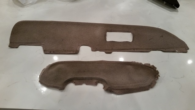

I replaced the old dirty smelly door panel fabrics with suede.

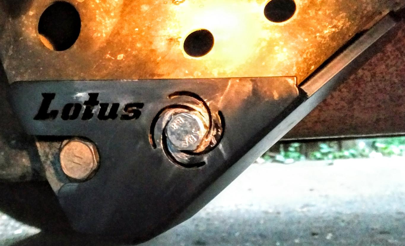

Added the Lotus control arm skids, bought off Amazon prime. They easily bolt on in 5 minutes.

looks great!, I have been wanting to do this for awhile, I was prepared to take it to a shop. Can you provide some details/steps? was it a hassle?

It was a hassle for me because I don't really enjoy doing these types of things. I much rather wrench on mechanical moving parts haha.
Just tear the old pieces off and cut the new ones to shape. Use 3M spray adhesive to glue them on. Since the new pieces are trimmed just like the old ones, wrapping them was easy...
It took me a whole day to complete all 4 doors. It's a very doable DIY project. Total cost was $30, can't go wrong!
