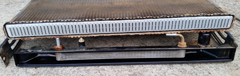

Just out of curiosity, I opened up the radiator at the bottom to see if there was any risk of the pink milkshake happening to me. See pic below. After 150K miles, there was no observable corrosion on the inside oil cooler. Those flat heat exchange fin tubes are very thin, so I can see how just a little corrosion could lead to such a failure.

I'm really curious to find out what this mystery bushing is. It's loose either because your OTR is shot on that side or you haven't tightened the nut to 67 ft-lbs.
