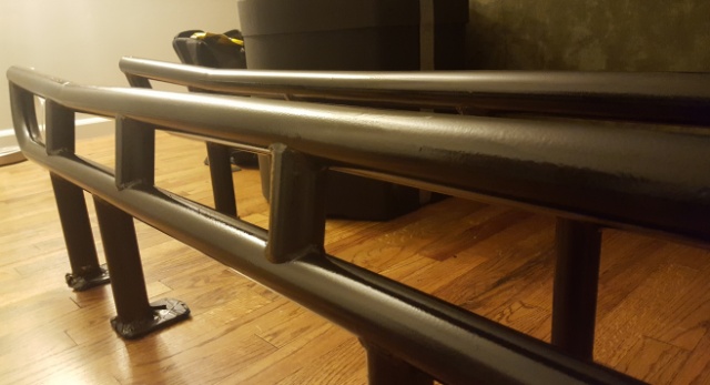

Two coats so far of Rust-Oleum Hammered black over about 3 coats of self etching primer for my Stubbs HD-SKO sliders. I also got a notification from UPS that my Savage cobo skids will be here Friday!! Whoo hoo! Armor is on the way. Now I just need to decide on color for the skids. The hammered finishes look pretty good so I will probably stay with that. But, I might go with a hammered silver for my skids. I am still working it out in my head.

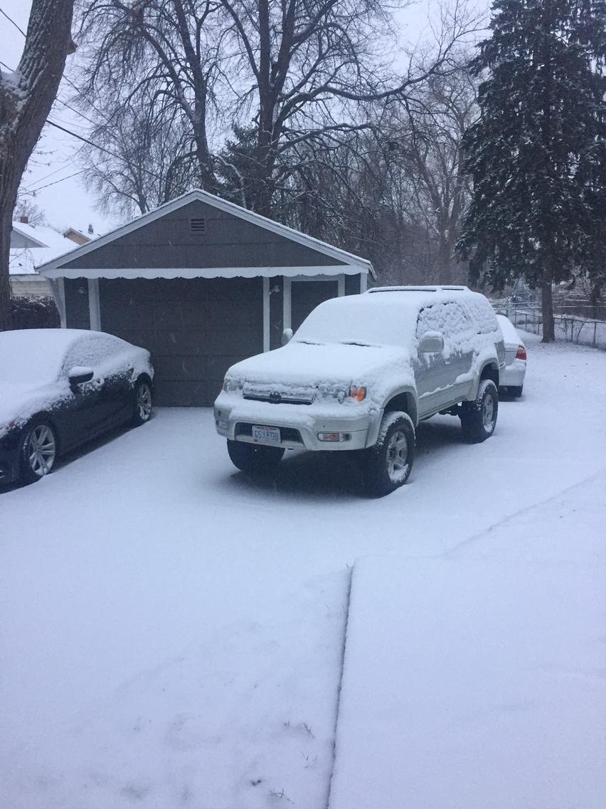

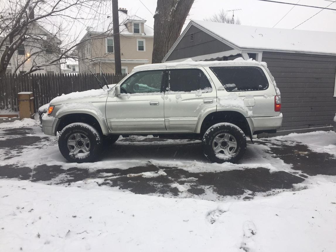

Finally got her lifted and just in time.
Got her up in the air just in time to take her on some snowy roads.
Tundra 5100 (2nd notch) with Toytec coils up front.
LC 7.5/8 wraps (without internal bumpstops) and tokico blacks out back.
265/75/16 Wild Country XTX.
This took me approx 3-4 hellish weeks. I work full-time, plus some, and go to school almost full-time, so I worked on it an hour here and an hour there. I think all parts were factory parts and here in Ohio, they did NOT want to come off. I ended up cutting off most bolts, tie rods, and sway links. snapped spome LBJ bolts so ended up having to take off the entire spindle and doing UBJ when I wasn't planning. All in all, was still fun and would do it all over again.
I had a blown rear shock since I bought it a year ago so now it currently rides like a dream.
Way to handle business man, I have a similar schedule but lack your dedication. Nice work!
Thanks. It's tough for sure, especially for Engineering. Also have another car and 3 bikes so I spend a good deal of time just upkeeping.

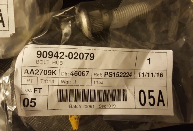

Finishing touches on my Stubbs HD-SKO sliders. It was a bit of a PITA due to it raining over the last few days. That, and I had a couple wheel studs replaced. Discount Tire cross threaded a couple lugstands. One snapped off, the other was damaged, shortened, then cleaned up a little. The job didn't look all that difficult, but it was more about holden them accountable for the issue.
