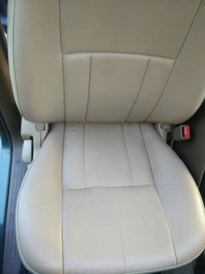

That looks good. What product did you use and what did you use to apply and clean it? Thanks

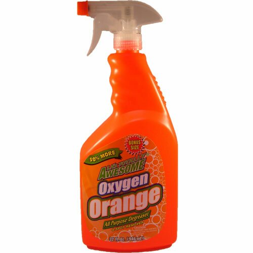

I have used a lot of different car products over the years, but by far the fastest way to clean leather is to use LA Totally Awesome orange. I learned this from a professional detailer some time ago. These are the steps I use:
1. Apply orange cleaner to damp cloth, then just rub the heck out of it until you are happy with the cleanliness.
2. Get separate clean wet cloth, and go over the orange cleaner in order to remove it. You will have to keep refreshing your wet cloth in order to get all the soap off.
3. After the stickiness is gone from the orange cleaner, just make sure it is dry using a dry cloth.
4. You can use any leather conditioner after that, I like to use the brown lexol leather conditioner. Just apply a nice even coat, let it dry for a few minutes then buff of it off with a clean towel. Then your done.
It is actually pretty quick, it just takes some work, but I have tried lots of leather cleaners, and nothing works like this orange stuff. It is $1 at my local dollar store. Hope that helps!

I'm amazed how good these seats look after a cleaning. These are 19 year old seats out of a 97 SR5. IMG_20170201_151604.jpg
