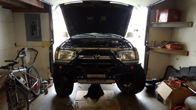

There were forces afoot that tried their best to prevent me from doing some basic maintenance today. The weather was not cooperating today. I wanted to knock out an oil change. I got a few bolts into skid removal before it started to rain. I nosed into the garage as that's about as much really fits in there.
This would be my first after adding the Savage skids. I figured that this would not speed things up. It didn't.
My hats off the Savage Off-Road. Normally, you only need to remove the engine skid to have access to the oil drain plug. I had to drop both front skids due to the friggin Toyota filter being stuck on there. I walked to the store and picked up a few oil filter wrenches and like accoutrements in hopes to free my progress blockade. Let's just say they all pretty much suck, but the pliers were the only thing that ended up working. A giant PITA.
Also swapped out an old radiator cap for a new one, filled the washer fluid and found / fixed a crack on the side of my air box, post filter! Eeek! I wonder how long that had been there... New air filter should be here tomorrow.

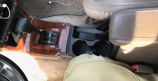

Discovered a button that I can't figure out what it does... It's in the center console above the drive mode switch, across from the window switch. It's a momentary rocker switch (operates like windows/sunroof), looks OEM.
Anyone have any ideas? It's in place of the blank in the picture below.
Will post pics when I get back home this evening.

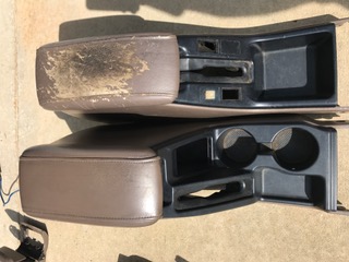

Out with the old, in with the new. I couldn't wait until the weekend so I swapped out the 2002 cup holders/console after work today.
BTW, I have a 3D printed cup holder now I don't need. I bought it this Christmas and realized I finally got a good deal on the 99+ cup holders.
Looks great! Now you just have to be on the lookout for the little rubber insert that goes in the cup holders.
