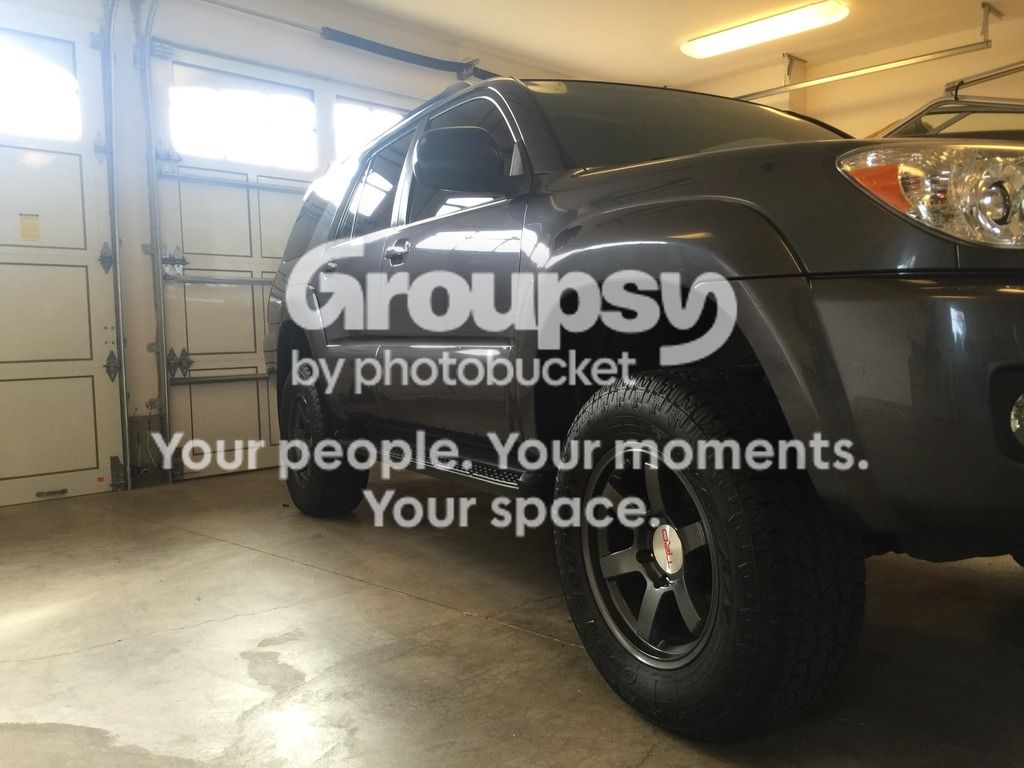

Ordered my set of General Altimax Arctic Tires today from Discount Tire Direct. 265/70/17. Figured I'd upgrade to 33's once summer comes around. Got them for 404.00 shipped to my house. Heck of a deal. Mount them Thursday and I'll get some pics
Replaced complete upper and lower control arms and outer tie rods on Sunday and got her aligned on Monday. Very nice :lookout: At 150k there seemed like a number of ball joints were bad and I know the bushings had seen better days. I ended up not replacing the inner tie rods since they felt solid.
