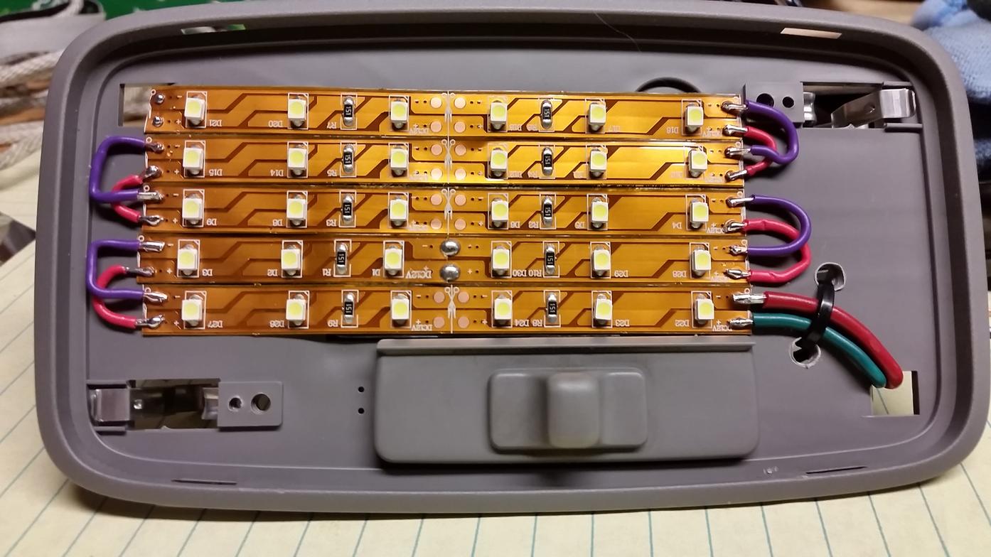

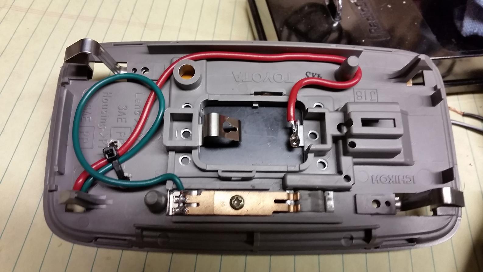

Put together a couple led lights using some "left-over" strip lights from a kitchen under cabinet lighting setup I did to make the wife happy this weekend.
Pretty easy to do. The strips just stick right to the light housing. I did add a small thin piece of lexan where the original light opening was to smooth out the surface...you can see the black lexan in the opening on the backside photo.
I had some leftover 20ga wire from an alarm and remote start setup I recently installed so I made a bunch of jumpers and soldered it all together. It's hard to find 20/2 stranded wire on a Sunday around here.
The negative lead was soldered directly to the switch because the material that the light mount is made of did not want to take the solder.
Probably not as cheap to buy the stuff and make this yourself vs buying the premade 48 Led light panels but if you have the tools and are doing a bunch of other led lighting around the house it's pretty simple to make. I did a rush job and did it in about 30 min after I was setup and hot with the solder gun.

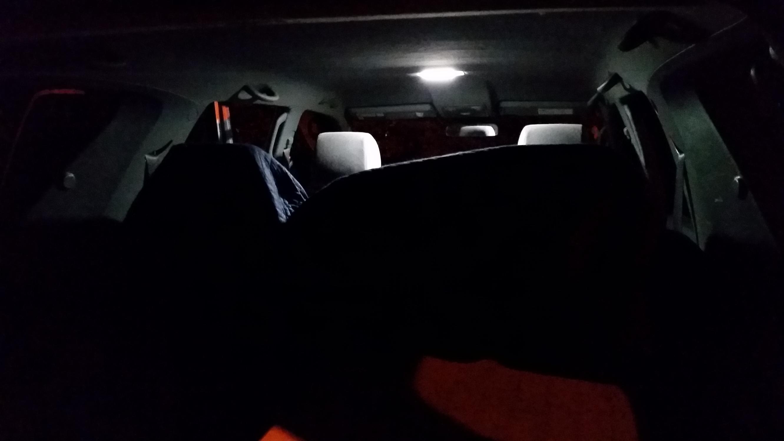

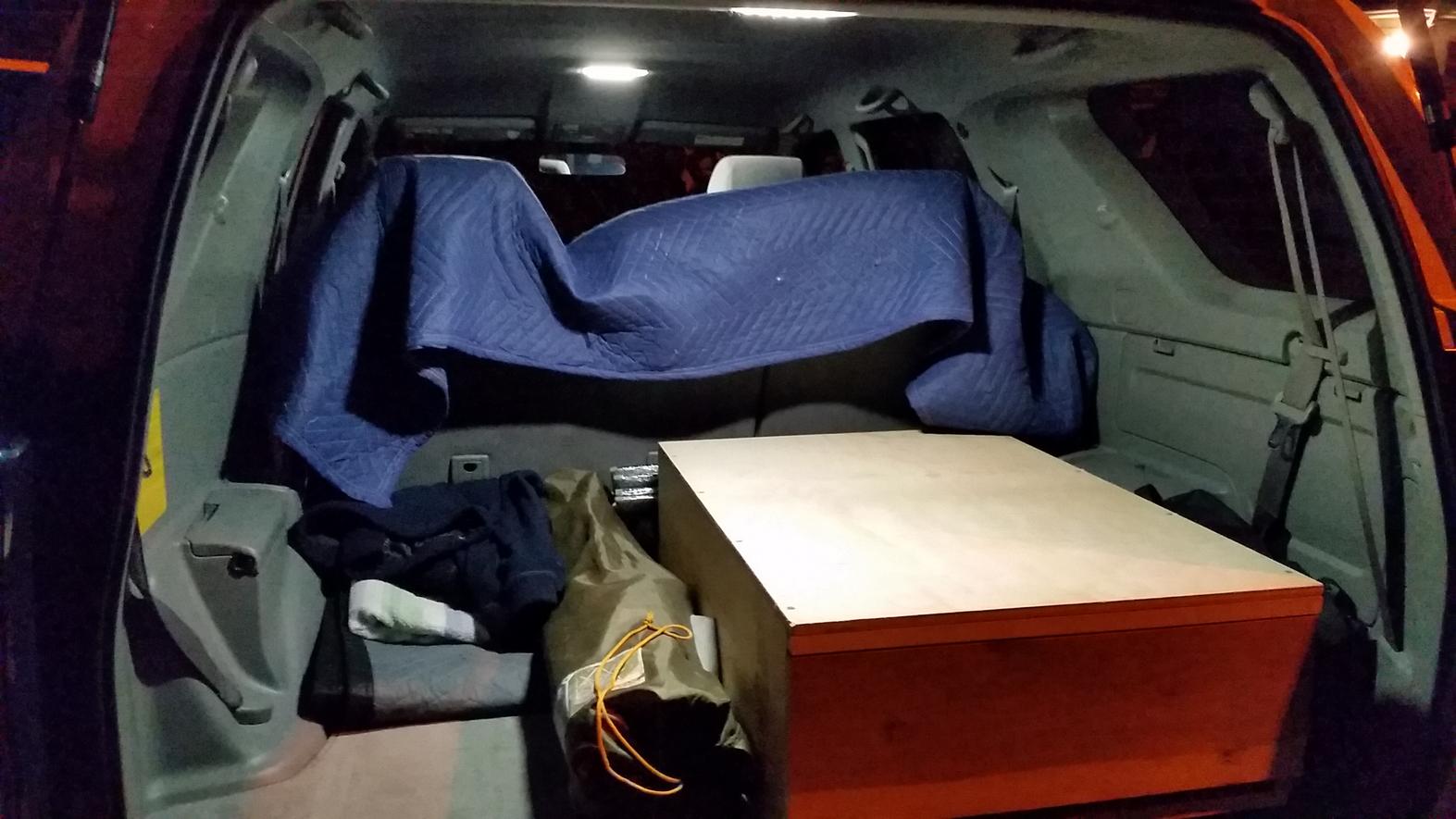

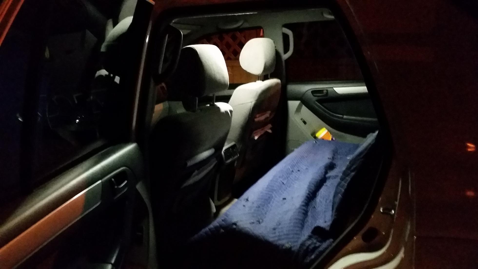

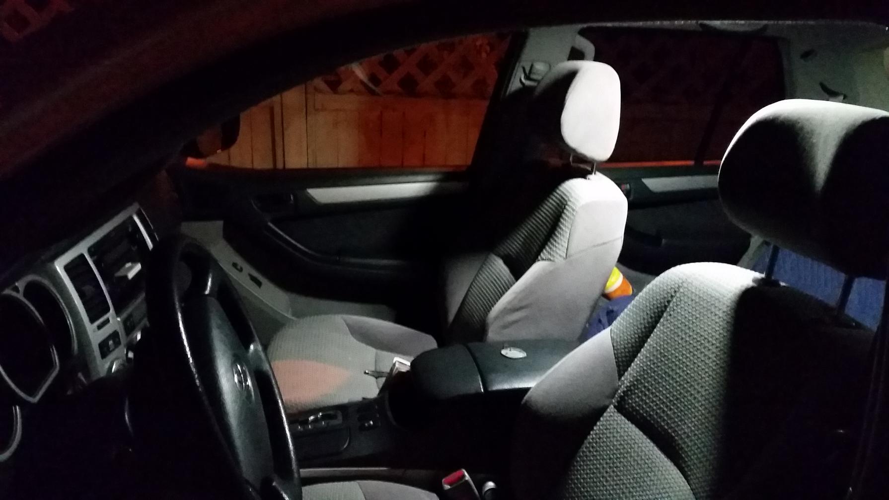

It's hella bright compared to the standard lights. Going to wait a few weeks to check longevity of the lights before I start modifying the door lights.
There is a street corner light making the orange glow.
Cargo light turned off.
Moving blanket for the dog.
