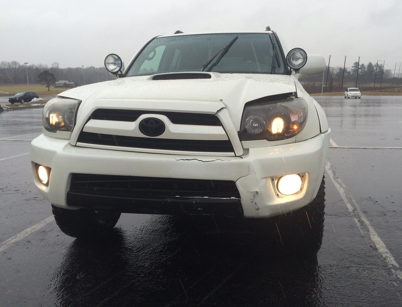

Finished the wiring for the 03 -> 06 headlight swap. Wired the '06 parking light/DRL and turn signal together with LEDs. It is flipp'n bright :first:
Looks good! The 06 headlight swap is probably next on my radar after sliders. Did you go with OEM housings?

Yeah, the TYC ones

Yeah, the TYC ones

Cool, I've looked at the TYC ones on Amazon, or going with the Spyder ones which are already blacked out. Just have been curious about the quality of the optics in them.

There is a rubber seal between the hood and the headlight that wasn't properly aligned. So far that's my only complaint.

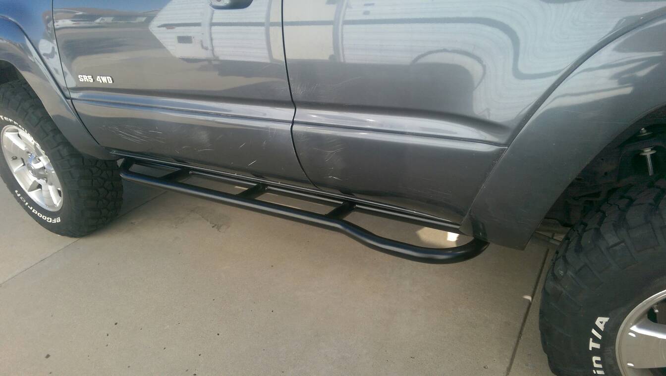

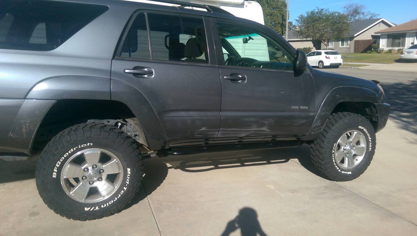

Repainted the rock sliders after the beating they took a couple weeks ago

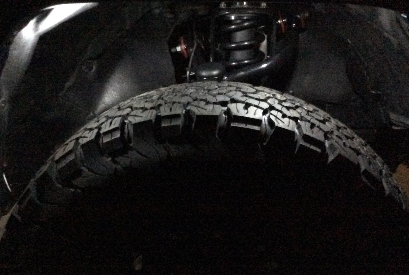

Installed rock lights all the way around
New UCA's
New Inner and Outer Tie Rods
New Splash Guards all the way around
New Tires went from 265/75/16 to 285/75/16 big difference
Gonna have to be doing some more chopping/cutting or .5 BL.
But waiting on those decisions until my
New 4" Lift Spindles show up tomorrow, and see where those put my stance at and possibly tire rubbing areas ....

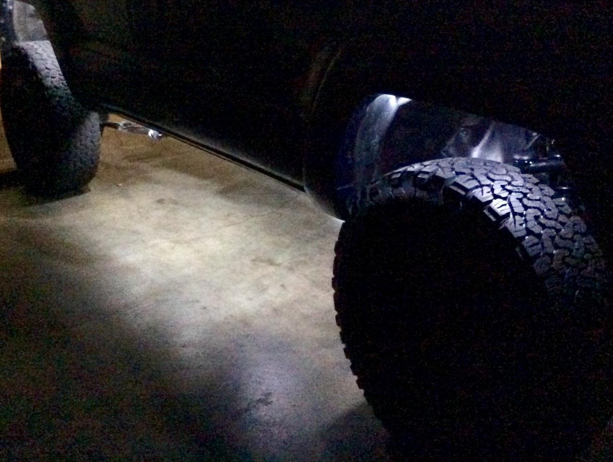

These came out so *****in the pic don't do them justice. Exactly what I wanted for camping,wheeling at night, modding in the garage but most of all when breakage happens on the trail and its dark a flip of the switch and walla!!

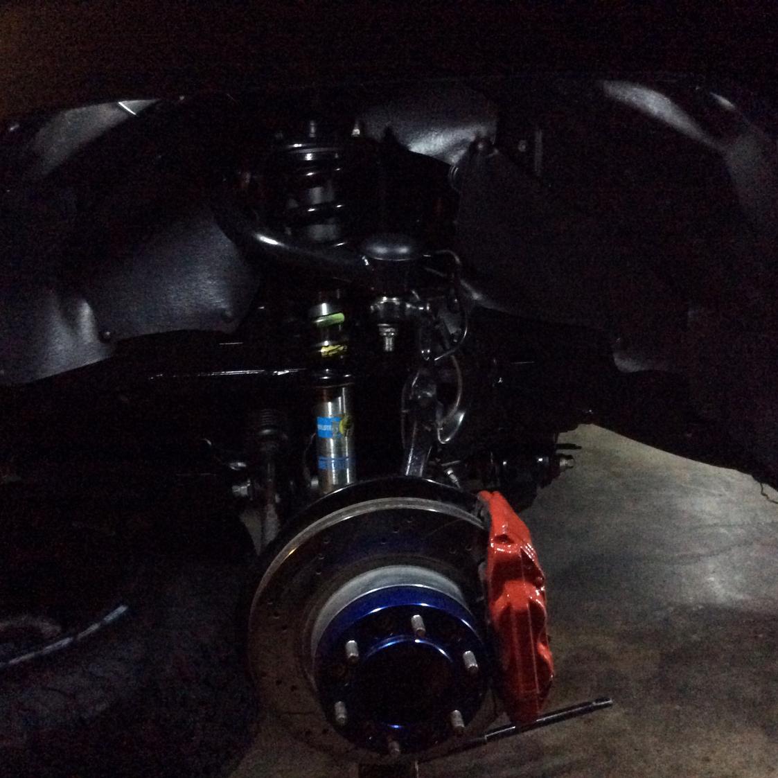

New UCA's
