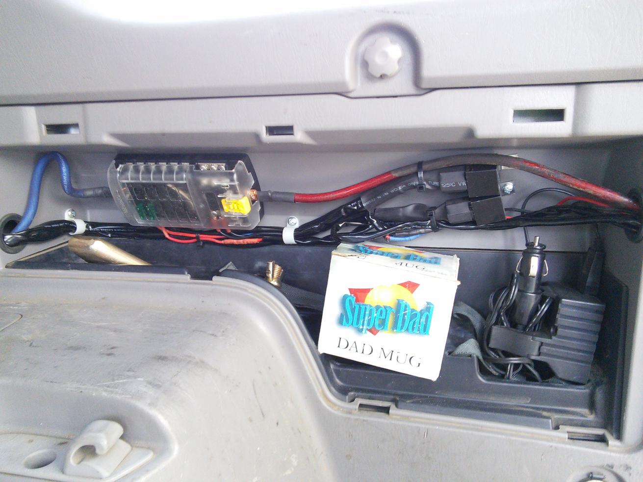

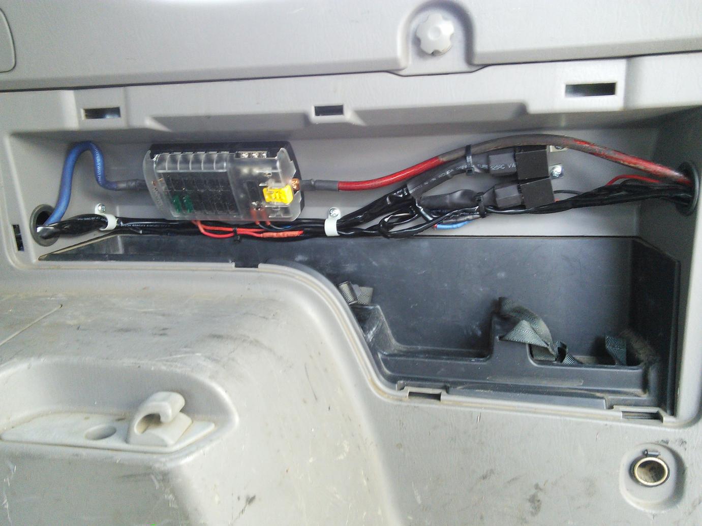

Well after a year of having my cubby hole all cluttered up with my roof rack lighting wiring,finally organize the wires and attached everything to the sides out of the way. Now I can get to my other items without fishing through the spaghetti mess. All this cause I needed to reseal one of my pod lights, had moister in one.

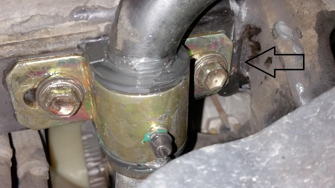

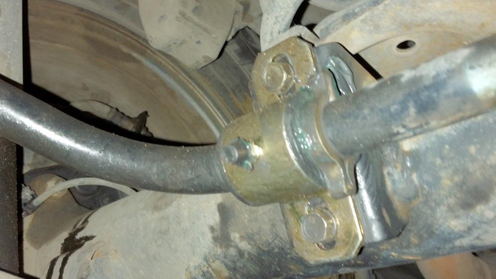

I also installed sway bar Prothane greasable bushings & brackets - the fronts had to be slid all of the way forward to avoid frame weld seam so they wouldn't bend when tightened.

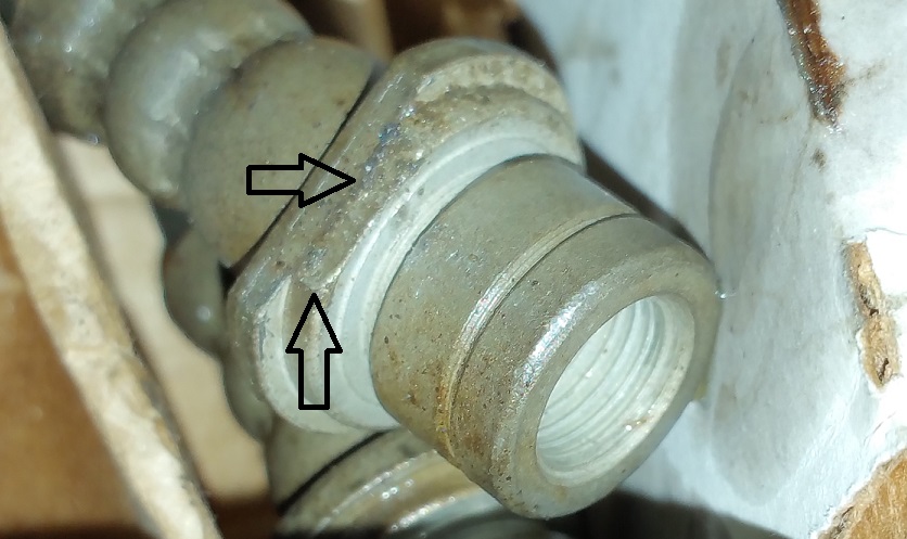

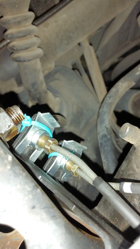

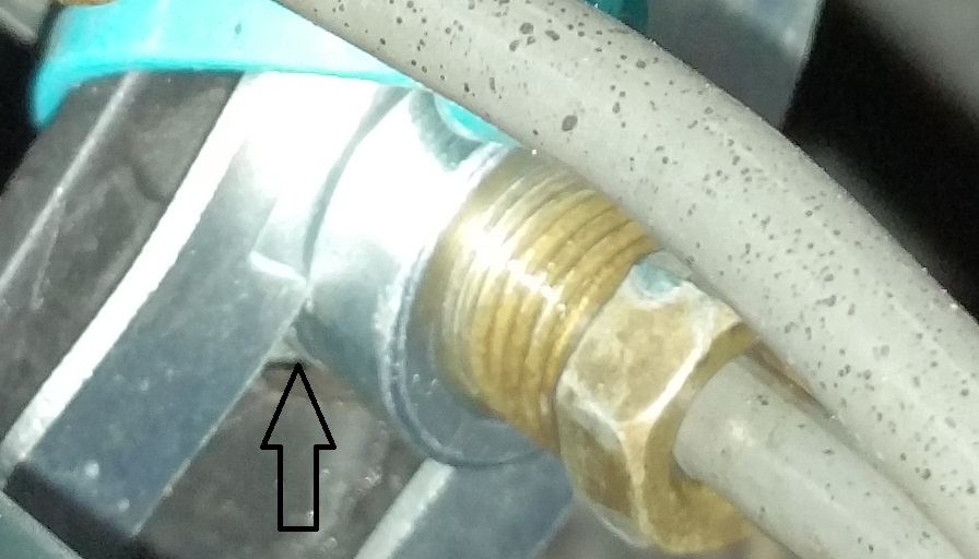

To all who are looking to do SS brake lines or extended brake lines, don't buy ToyTec SS rear extended brake lines UNLESS you are happy with lines that do not fit into factory brackets or thread as well/deep either - the Centric brake line kit on Amazon do fit the OEM bracket perfectly though for the fronts (these have the lip that fits OEM bracket) - and the threads seat exactly the same depth as the OEM.
Great Fit for Front - Centric 950.44007 Brake Line Kit $38.94
Do not fit brackets - slip through oem brackets - ToyTec FJRL14 Extended Rear Brake Lines (07+FJ & '03+ Runner)
Total: $79.17
You can see the OEM fitting has a lip that fits snugly in the OEM bracket - the ToyTec's do not have this lip - they are essentially just a 17mm nut that actually slides through the bracket - see the gap? I zip tied them to the bracket to keep them from rattling / sliding through the bracket holes.
