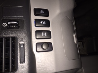

JL 500/1 bass knob
Installed a bass knob on one of the button blanks..for my 500/1 w/ a 10W3
:drummer:
That's very clean. Damn I wish I had a traction control button like that! All I have is a center diff lock. Any reason why yours has all three of those ?

bass knob...vsc button
did you use the JL bass knob? I've been wanting to do this, but when I take the JL knob apart I just don't mess with it.
Yea, JL bass knob, RBC-1, for my 500/1 (version 1), came out pretty clean. I just drilled a button blank and used needle nose pillars to clean up the plastic pieces on the back of the false button.
Mine is 05 Sport edition 4wd v8.
My runner is a 08' SR5 4wd V6...I did a quick search and I guess the 08'-09' 4th gens come with the VSC (vehicle skid control) off/on button. I didn't know that..I almost bought an 06' limited :banana:
Hmm interesting. My vsc turns off when I lock the diff but not traction control. Makes no sense so going through mud the wheels stop spinning once the computer notices. I got stuck because of this. I found a way to turn everything off by unplugging a connection near the brake fluid reservoir.
