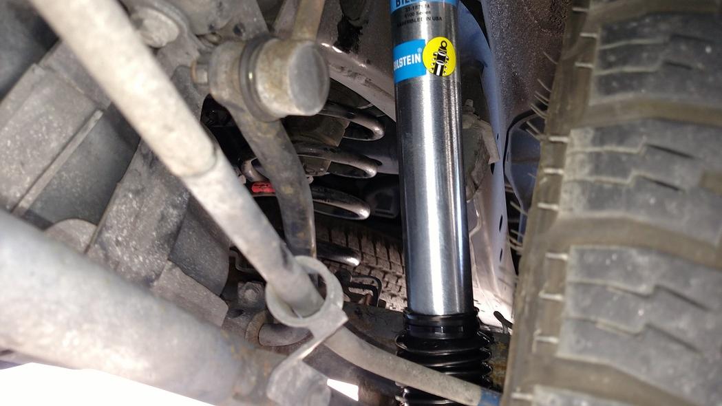

I don't see how if properly mounted and secured the shock shaft moved and punctured the wheel well. Somethings not tight or you maxed your shock out and it had to move or explode.
I've got these over near where I live right by the bank. They're the new reinforced speed bumps.. They're actually pretty damn high you have to go REALLY slow in a car. I hit going 5mph.. The whole back and front will jump literally
It's the rear. Everything was done correctly. But I was going about 35 mph lol. I went back to look g the speed bump and originally it was a cement hump basically. And then they added the rubber looking:plastic ones. Basically just dumb on my part for going that fast over it. As a result I just got new shocks anyways. Pro comp prorunner series.
That's what I think it completely compressed and it just had to go up. and this was a Bilstien shock from an FJ trail team. Could have been the problem there but it was a little o-ring style clip that held the bushing in place, and I just don't see how that kept the bushing in place for so long. Since I replaced the shocks already the next thing is coils so I can get rid of my stock ones with a 1.5 inch spacer. Thinking of going with the toytec super flex HD coils. But I don't always have weight in the back

something still isnt right. I've jumped mine off a dune at 50mph and my shocks didnt puncture.
I think if I had bigger bump stops it could have prevented this, going over a speed bump to fast and the bushing clip on the shock have out and the shock extended out and popped this hole in the body.
For this to happen, the whole assembly would have to move, what, an inch-inch and a half? Was the bottom flange collapsed? I don't think you would have that much movement even if the bottom bushing completely gave up, unless the bottom flange or washer collapsed.
Just for kicks, what do your body mounts look like? Is there a chance they compressed too much and allowed your body to come down on the shock?

Yeah it hit super hard and I felt the axle hit the bump stops.
Honestly they feel better than the Bilstien 5100s I paid $120 through 4 wheels parts for both and lifetime warranty on them, anything happens they replace them free
