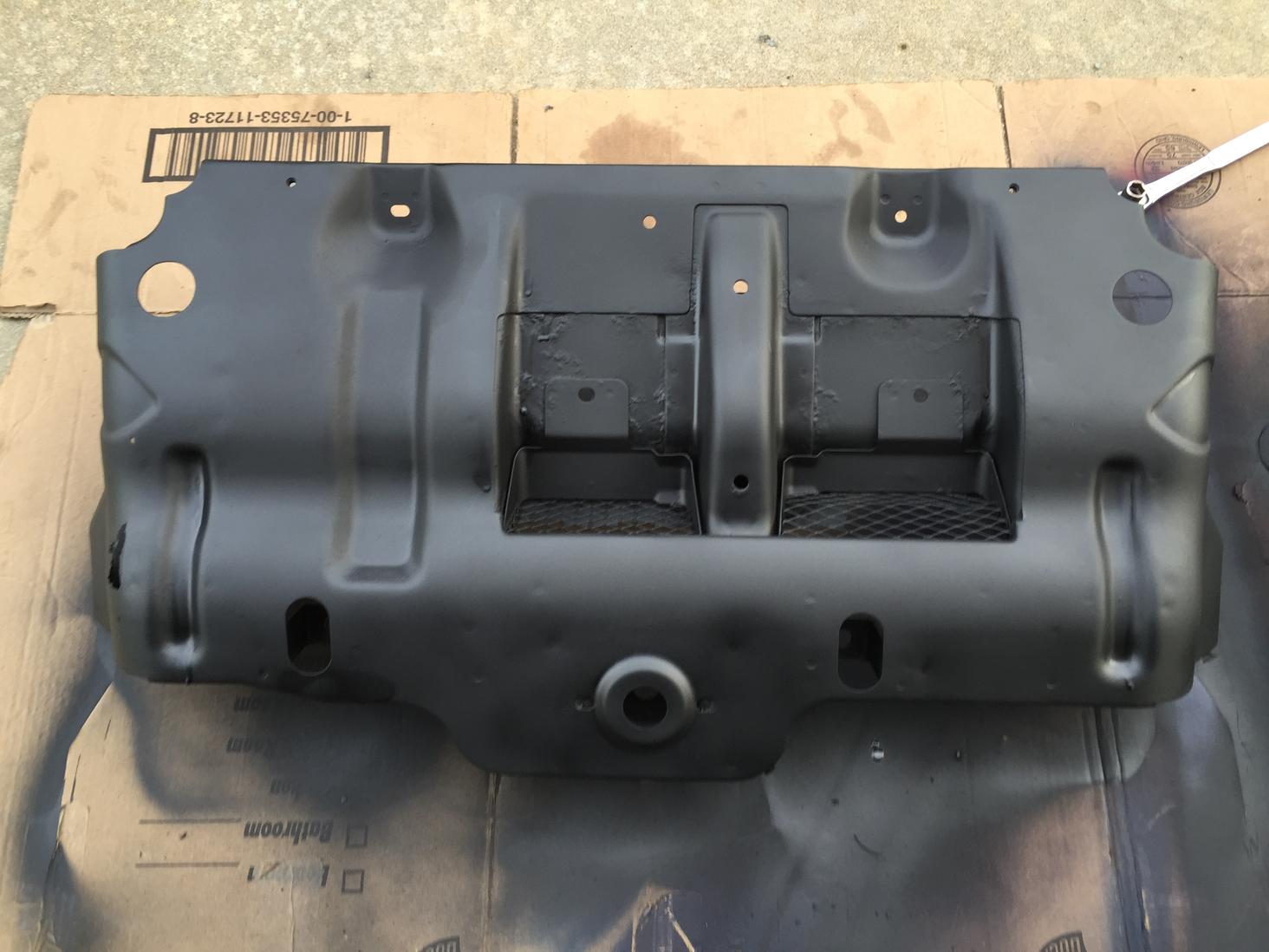

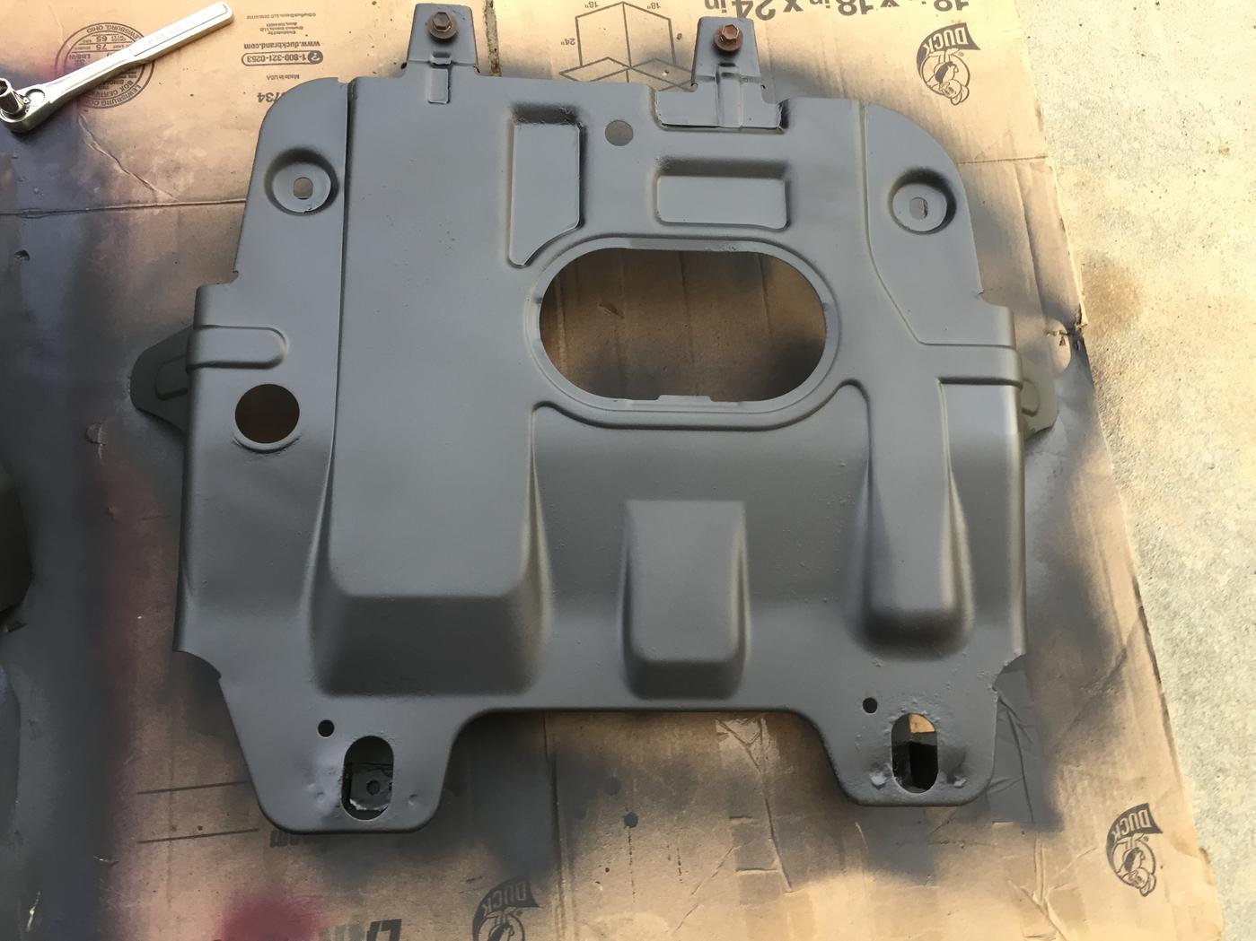

Restored stock skid plates
Decided to restore my stock skid plates today. Used degreaser, wire wheel, rust/paint remover wheel, paint prep spray, and rust oleum rust reformer. I'm happy with it.

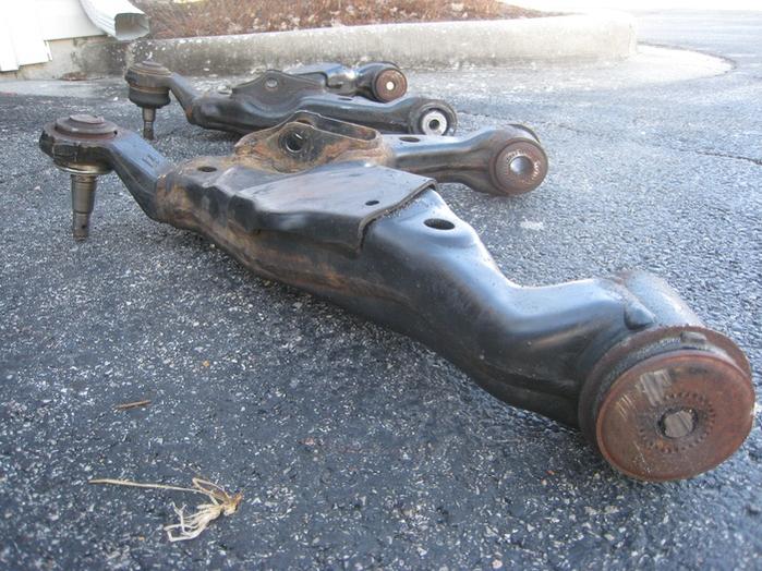

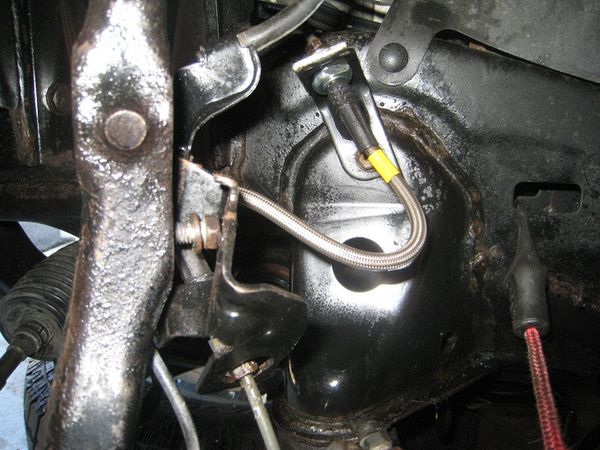

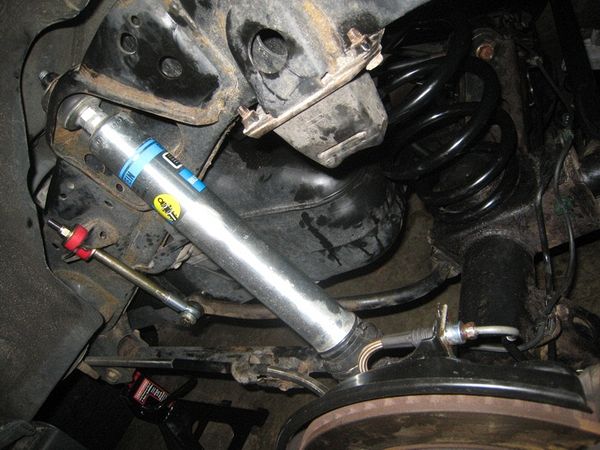

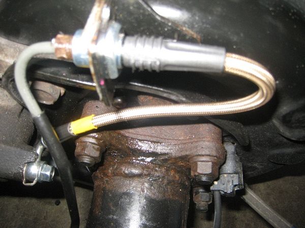

After 21 days on stands, I got her back on the street today. In all, I replaced...
1) Lower Control Arms (to OEM)
2) Outer tie rods (OEM)
3) All brake lines (Stop Tech) Also led to a great bleed/purge.
4) Front shocks (5100's to .85)
5) Rebooted both CVs (OEM kit from Amazon)
6) Rear springs to ICON 2"
7) Differential needle bearing (to ECGS bushing)
8) Replaced FD wheel bearing
9) Replaced rear sway bar links (ones shown here)
10) Drained/filled radiator
11) All seals encountered along the way (OEM)
My initial plan was to recondition my LCAs, but after I tried removing the LBJ under a lot of heat and PB blaster, decided to see how bad the alignment cams were. As I suspected, they were seized and ultimately met Sir Sawzall. The bushings looked pretty bad so, combined with the nature welded LBJs, I abandoned the recondition and went to replace. If anyone out there needs a set of old OEM LCAs to recondition at leisure, drop me a PM. I'll hang on to them for a bit longer before they meet their fate.
I didn't make a good photo documentary along the way, but here's a few pics and the finished product at the end.
