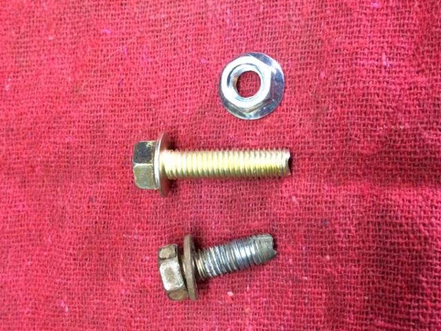

1) I fixed the oops "I cross threaded/stripped the nut on my rear sway bar bushing bracket" from yesterday with a grade 10 M8-1,25 X 30 mm bolt and M8-1,25 flare nut. (image below). You can see the damaged threads on original bolt vs. the new bolt. Ironically, the new longer bolt must have chased the threads in the welded bolt on the sway bar bracket mounting plate ''cause it tightened up with no problem, where the original spun like a top. I added the flare nut as added security, but it probably wasn't necessary.

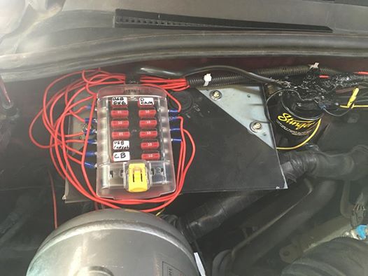

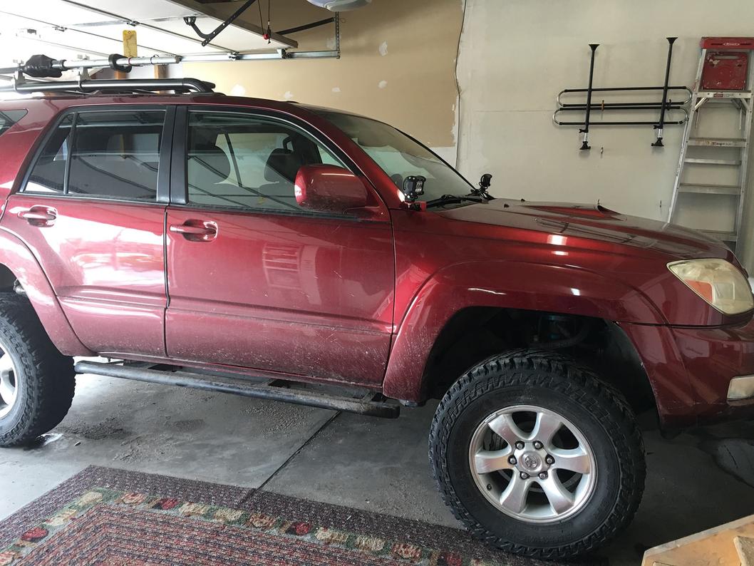

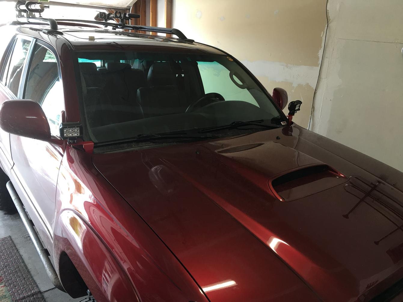

Very productive Spring Break for the 4Runner. 1 inch body lift -done. Ditch lights -done. Accessory wires moved from glove box Blue Sea fuse box to Switched Blue Sea fuse box - done. Driver side rock slider removed, frame weld ground flush with frame, painted, rock slider installed with all 3 mounting bolts instead of just the 2 I have used over the past years. It was a good week turning wrenches, no gremlins trying to frustrate the work.
