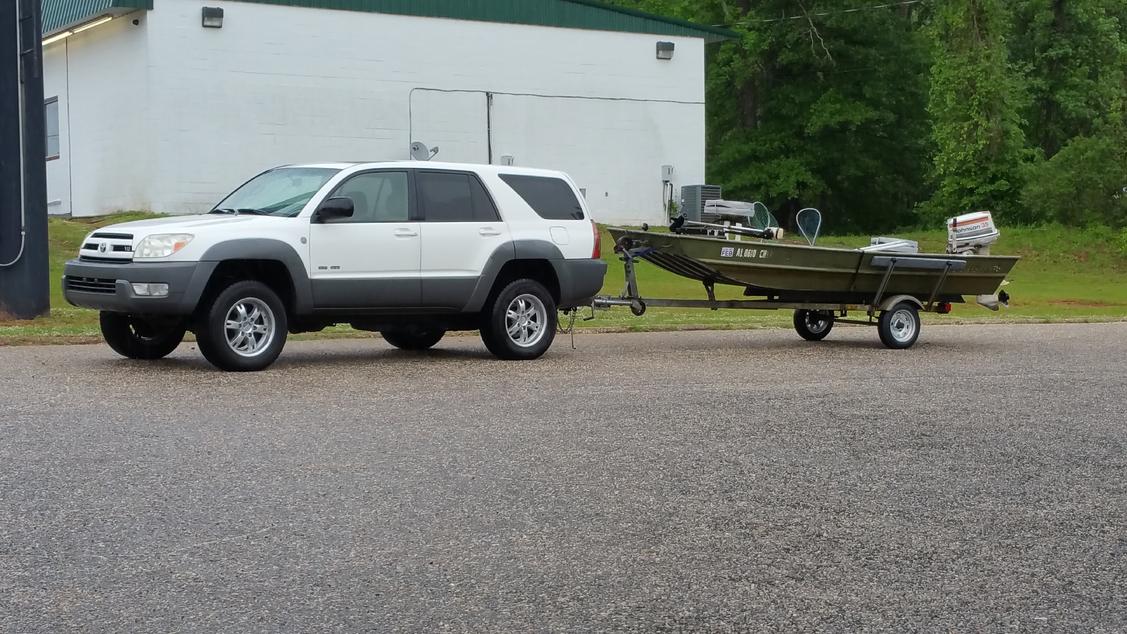

Well it wasn't today, but me, my wife, my son, and my wife's step sister went to our camp house on the tombigbee river over the weekend. The water was really really high, so we were not able to stay unfortunately. We called it a loss this time, but intend to go up again in a few weeks. The bass won't know what hit them :fish2:
And yea, the truck was loaded down pretty heavily in the back. So was the boat.

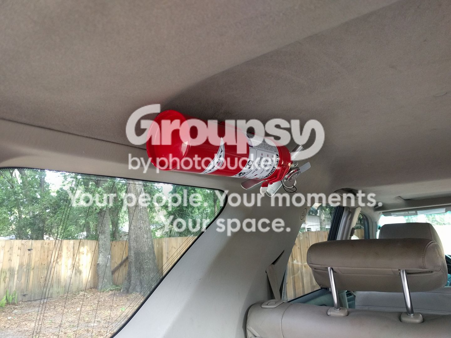

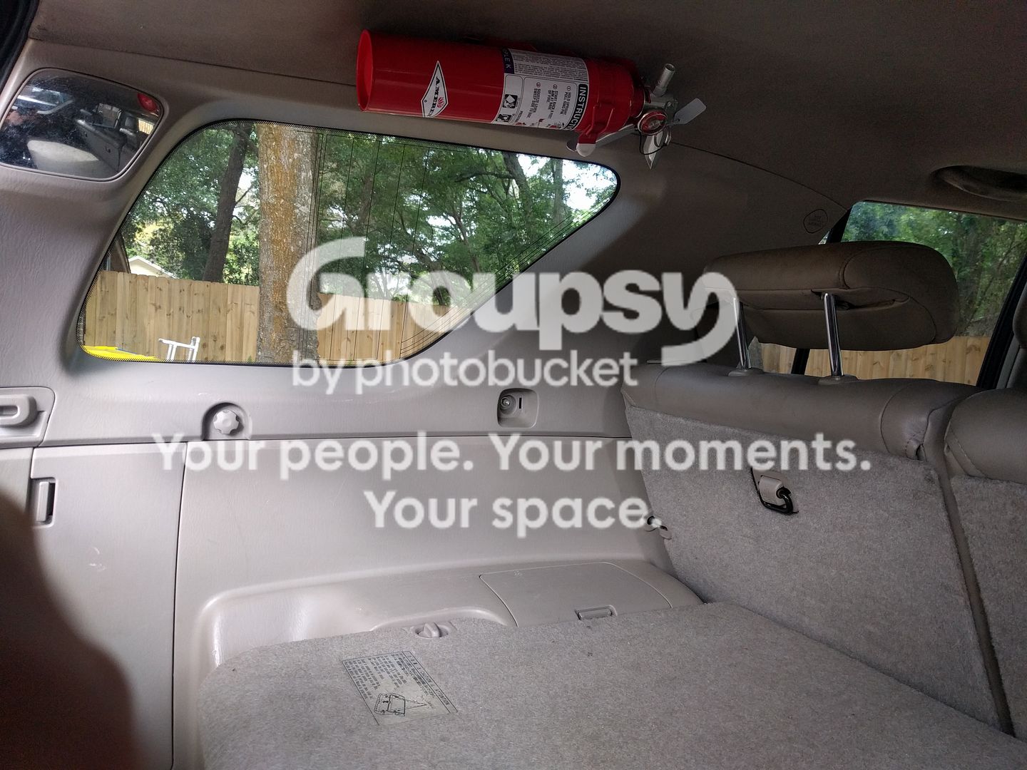

Added a purple K fire extinguisher. Removed the clothes hanger and bolted the fire extinguisher bracket to the two bolts for that. Doesn't seem to move around while driving and no vibrations or rattles.

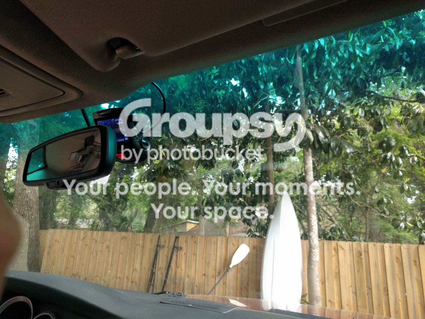

Dashcam hidden up under the rearview mirror, hardwired into the map light power. Comes on and starts recording when the truck is unlocked and shuts off 30 seconds or so after the truck is locked.

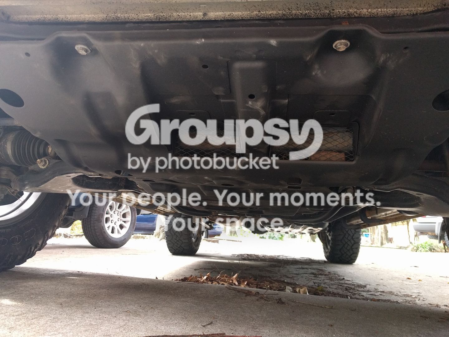

Took a wirebrush to the skid plates and painted them with spray on bedliner

Hey man, how did you bolt the fire extinguisher to the clothes hanger clip? I have a smaller fire extinguisher that I would love to put up there full time. Are there any special brackets you bought or anything?
Everyone should have a dash cam. I got into a car wreck last year where the guy lied and said he had a green arrow and I ran a red. I had a green and he failed to yield and turned in front of me. If it hadn't been for the independent witness behind me that stopped it would have been my word against his.
I don't know about the fire extinguisher mounted like that, though. I'd be afraid in a hard enough impact that it would become a projectile aimed at my head.....

I used one of the stock holes on the bracket, then I drilled a second hole to get the right spacing for the holes on the truck. I just used to the clothes hanger to mark the bracket at the right spacing.

Yeah I got it after I witnessed a hit and run a couple cars ahead of me and realized I wouldn't want to try and remember all the details if someone hit me.
I thought about that, its a pretty solid metal bracket and I positioned it that any force propelling it forward pushes it into the top part of the mount. I'd be more worried about the random stuff I put in the backseat or the cargo compartment that isn't strapped down

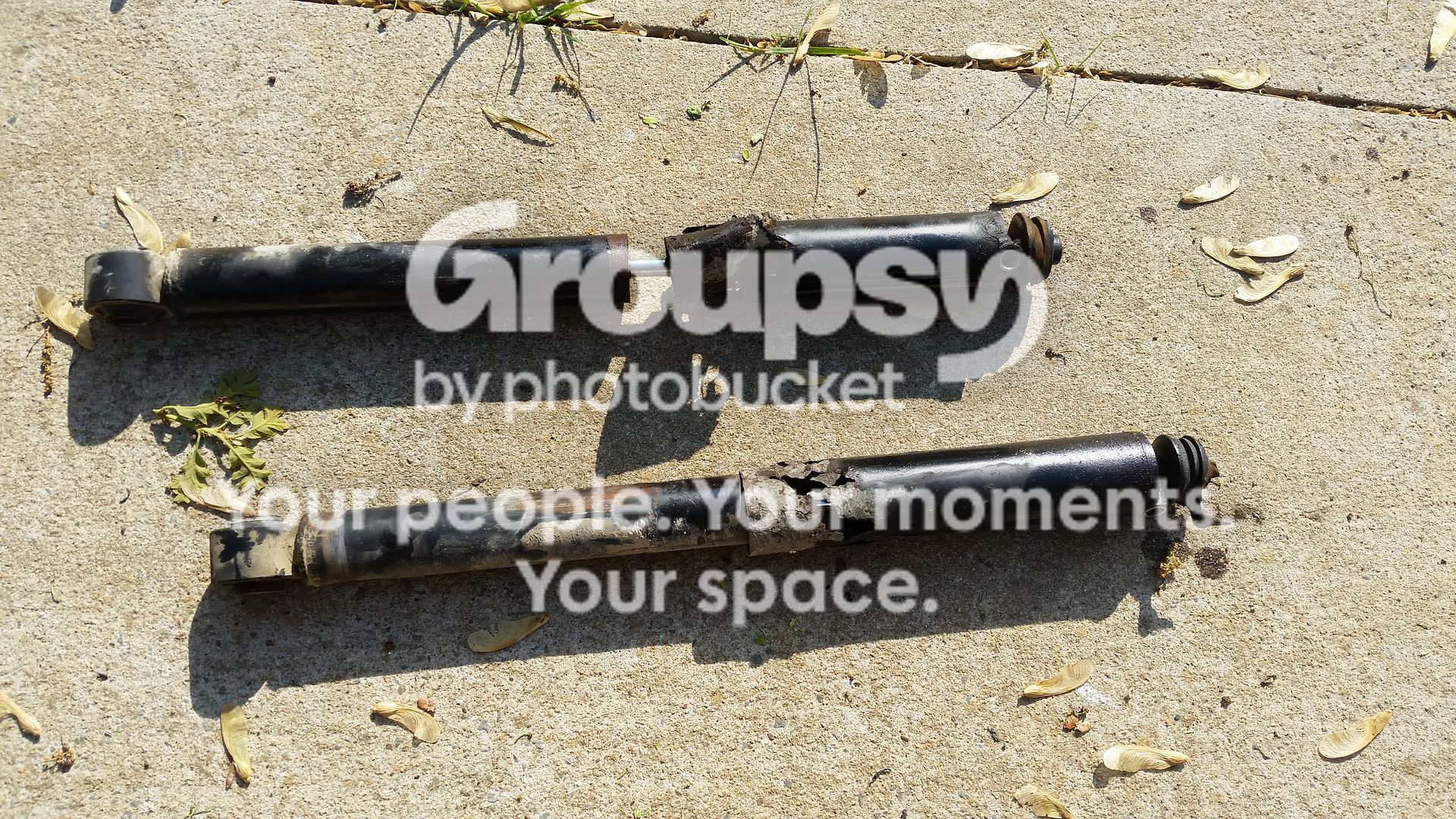

And this is what my old XREAS shocks looked like. YIKES. :wow:
20160420_174122.jpg~original

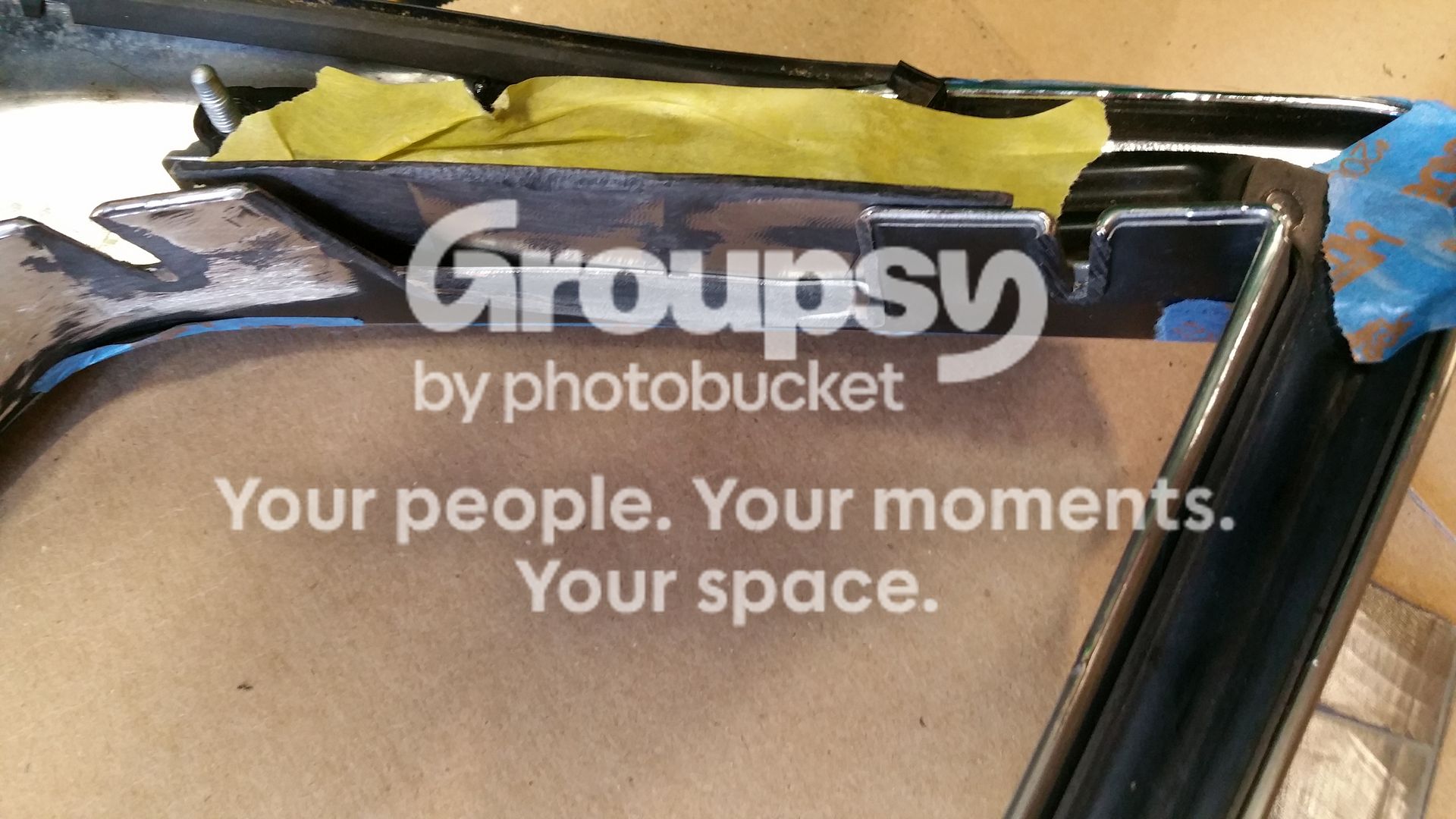

working on my satoshi grill and trying to find out how im going to do the next step. dont know if i should bond the fill plastic in the photo to the back side and fill the front with bondo or if i should cut the fill piece and put it in the gap. dont really want to work with fiberglass if i dont have to
20160420_191030_zpseikcdfah.jpg~original
