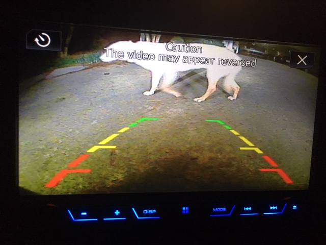

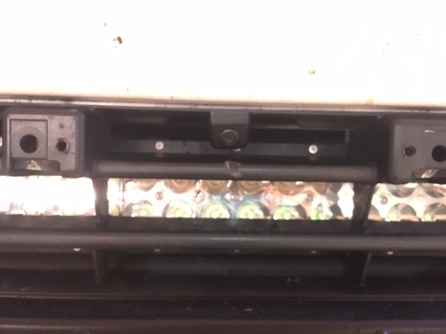

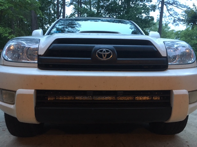

Installed Front Camera
Got a cheap camera off of amazon and figured I would test it on the front. If I like it, I'll order another one for the rear. Luckily my pioneer head unit supports 2 camera inputs! Also captured some wildlife aka my old dog. Install took longer than I expected but then again I had to take apart everything to get to my head unit for the thousandth time.
When I get a lift I'm hoping this might prove useful for seeing rocks and other obstacles on the trail directly in front of the wheels
I installed it just above my lightbar which is behind the lower grill

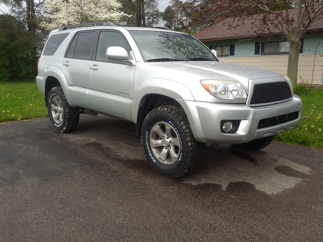

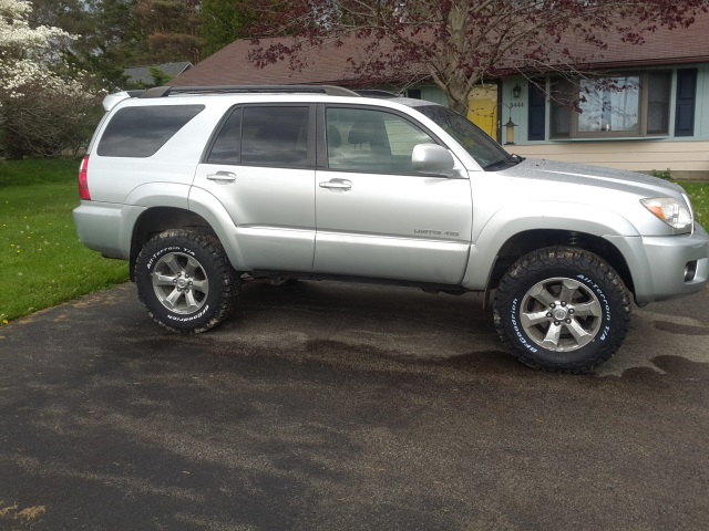

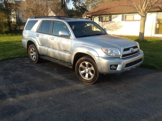

Installed lift - Bilstein 6112s and ICON springs in the rear (5160s coming tomorrow).
New OEM brake pads and Premium Centric rotars
re-booted CV axles
pics tomorrow. im tired. :P
pre-lim numbers are showing i gained about 4" in the front and 3 3/8" in the rear! holy cow! i set the 6112s at the top notch and the ICON springs are supposed to be 2" lift. My suspension must have been extra saggy
PRE LIFT # (center of wheel to fender)
Driver Front: 19
Driver Rear: 20 5/8
Passanger Front: 18 7/8
Passenger Rear: 20 5/8
POST LIFT:
Driver/Passenger Front: 23
Drive/Passenger Rear: 24
Tomorrow off to get an alignment, install rear shocks and extended rear sway bar links. Then shopping for some new shoes! Still deciding on what to get.
275 70 17s or 255 75 17.
I'm currently running 265 70 17s. Do you think E rated tires are too stiff for a DD?
