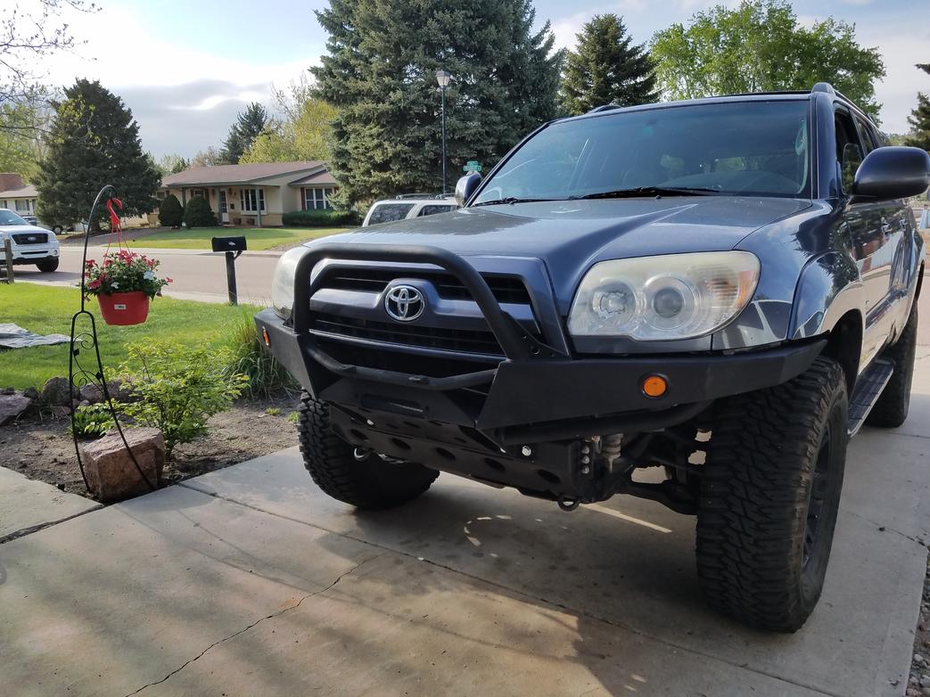

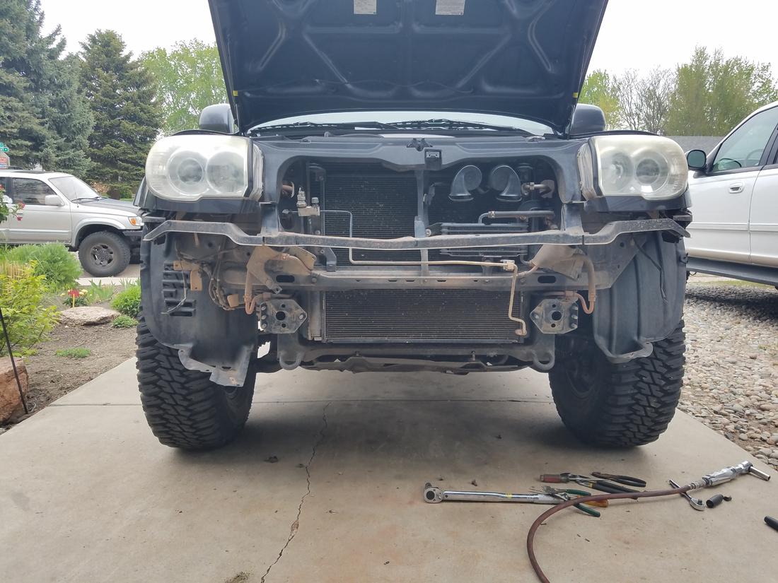

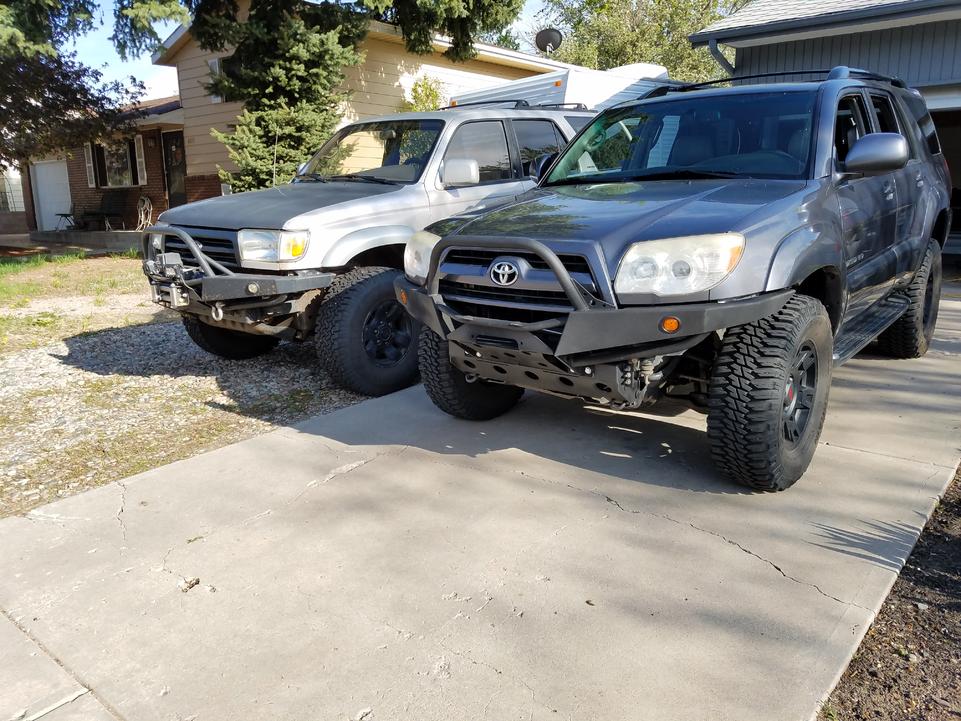

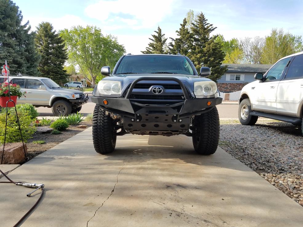

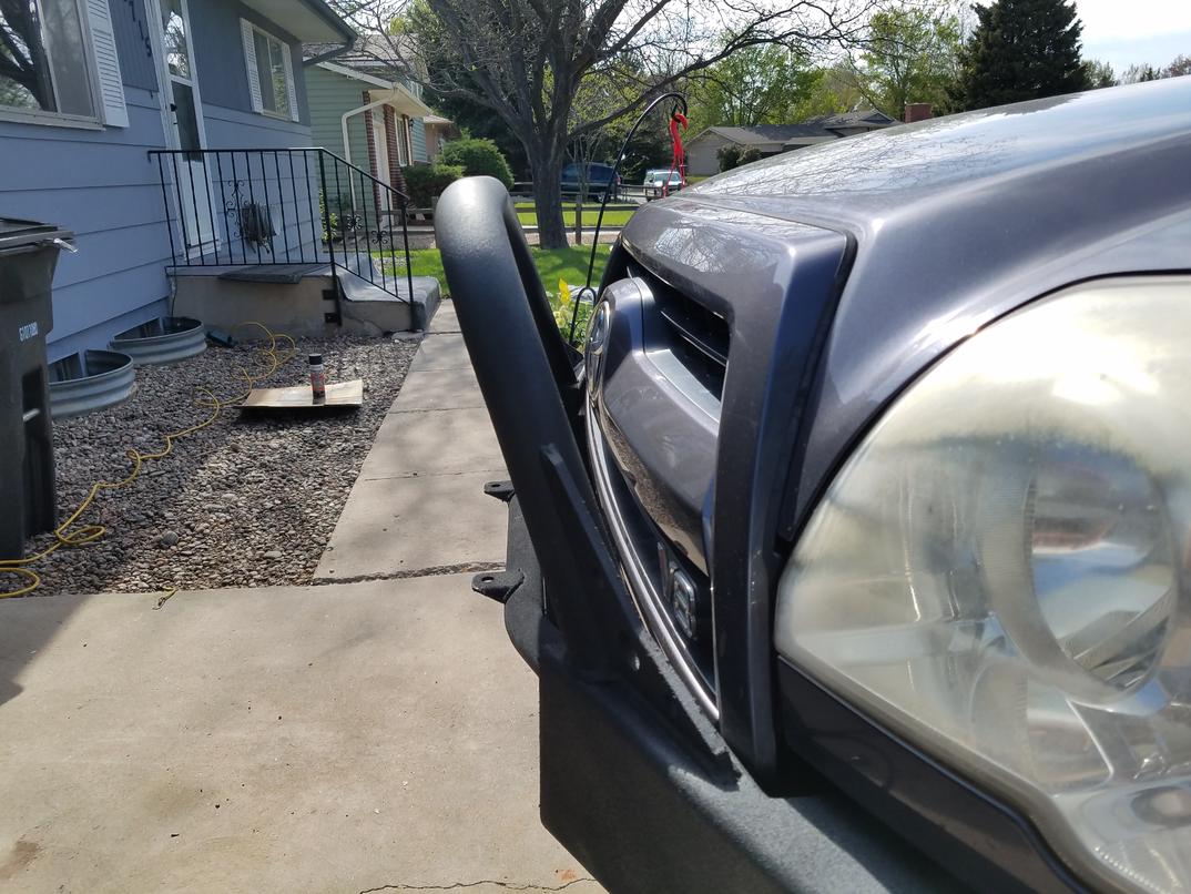

Installed AOR Plate bumper on my brothers rig.

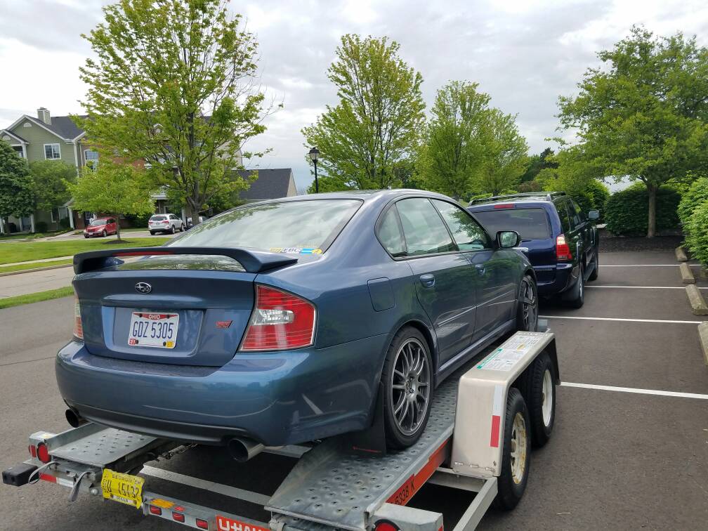

Towed my Subaru from Cincinnati to Indianapolis for a track day at Putnam Park.
Had a torrential downpour in the middle of the event which turned the track into a skating rink. Laps were slow but very exciting without traction!

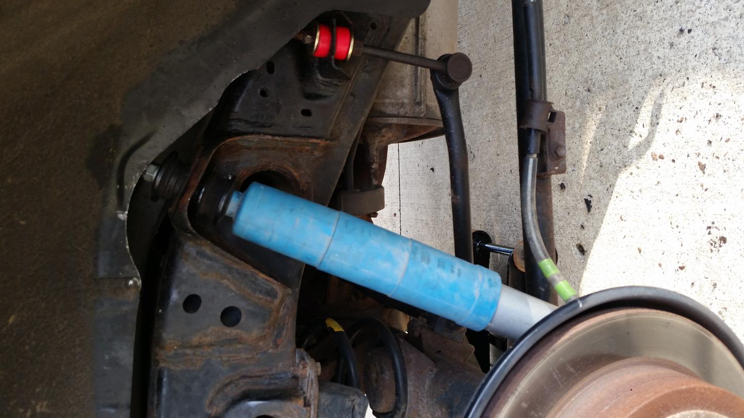

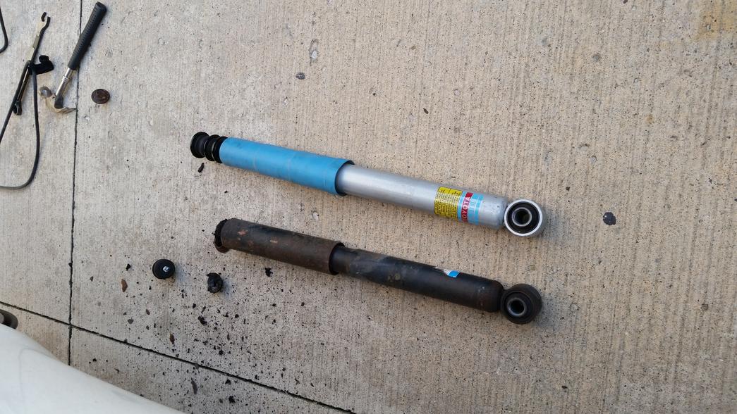

today I spent an embarrassing 6 hours replacing my rear shocks and trying to replace my end link bushings.
I immediately stripped the hex part at the top of the shocks to keep everything from spinning (2 days repeated soak in pb blaster). so I tried everything from trying to snap the shock to wedging the metal shaft. no go so I bought a Sawzall and finished in a reasonable time.
I also got the passenger end link bushings swapped to the energy easily but the driver side nut stripped immediately. I'm not sure how to get that off without cutting the end link so any advice?
quick pic of the completed shock and bushing.

End links are like $20, just replace it.
You could get a special wrench that can grip stripped nuts, but you don't have a lot of space there to work with.
I've had good luck with strong locking vise grip pliers and stripped nuts. The other option is replacing the end link.
