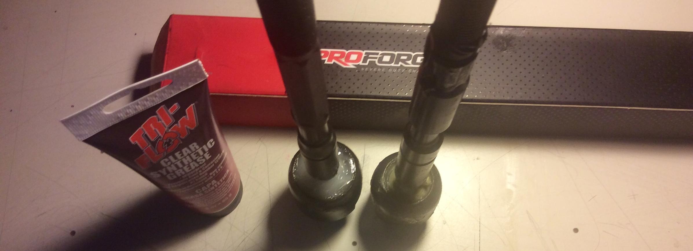

Installed new inner tie rods and decided to try a new brand, new for me. Last time I went with Moogs and they were whatever, didn't last long neither. But this round I went with ProForged which I was shocked to see and feel how much bigger and beefier they are compared to the Moogs all around as you can kinda tell in the pics. So all the first impressions and comparisons are great.
I also removed the grease that came packed on the tie rod and repacked them with Tri Flow Grease

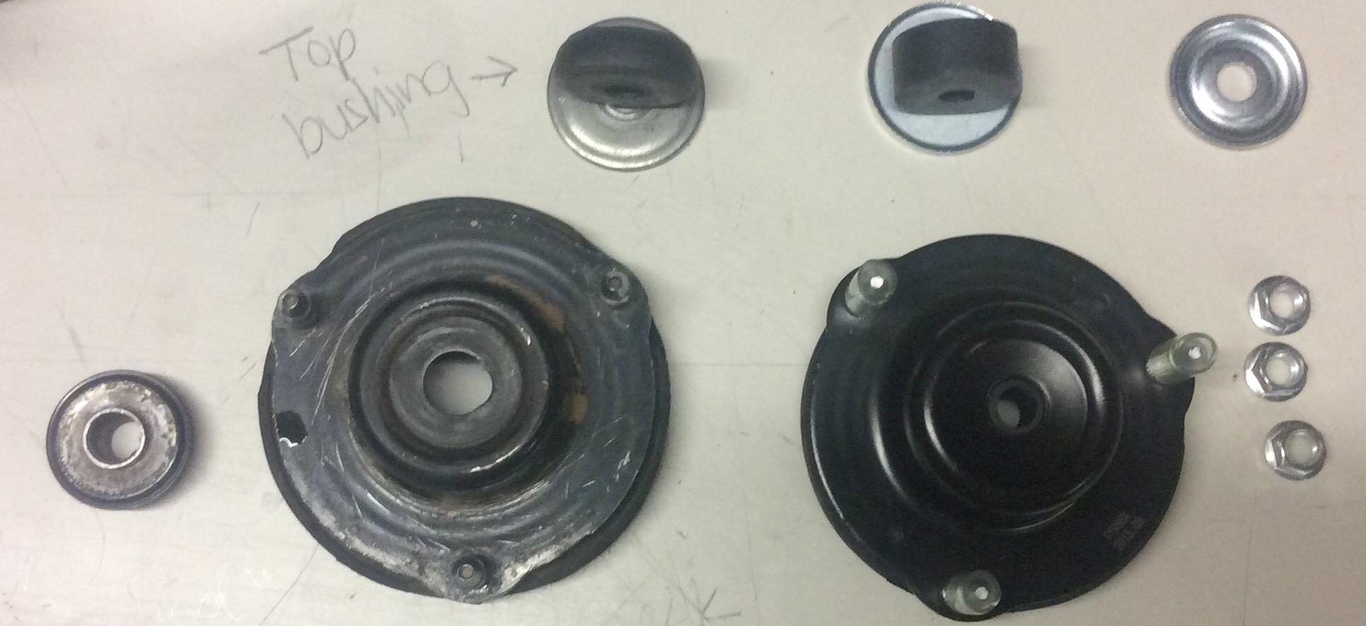

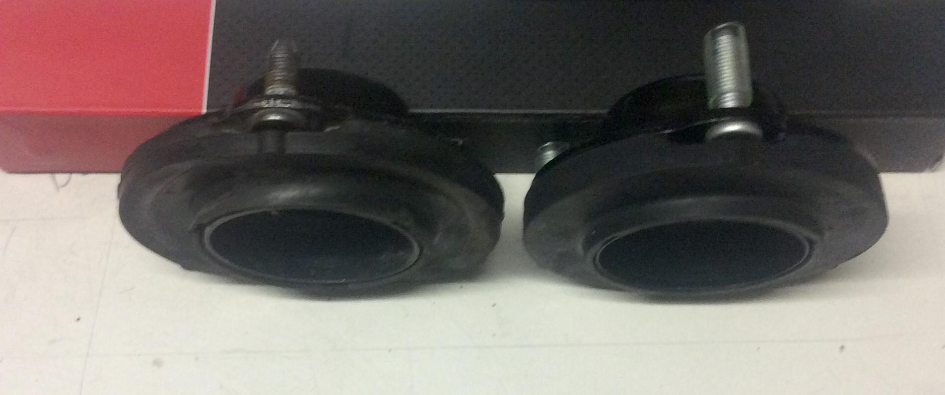

Also replace my blowin top hats and rubber shock mounts. Install two new complete KYB top mount kits to replace the original oem ones after 262k on them lol. As you can see in the pics how blowin out the shock stem hole is in comparision to the new one. So it's just been slopping/banging around in there and the supposed to be "attached" top hat bottom bushing was not so attached and just fell out upon removal and the top hat rubber shock mount was completely cracked and pancaked.
I will say this by far ...out of all mods, upgrades, and repairs, this has been probably one of thee most noticeable and cheapest best feeling upgrade/replacement I have done. What a feeling seriously and the best part my rig is quiet now when going in/out of the driveway and over bumps and dips!!!
I would like to thank [MENTION=101553]t-man[/MENTION] for always preaching this to others by recommending that you should order complete top shock mount kits whenever replacing/installing new shocks ..,for this reason right here. Wish I would have listened/looked sooner. Thanx brotha

Issue with aftermarket inner tie rod ends is they don't have as much droop compared to OEM. So when you wheel they will slightly pull out the socket and loosen up. I've tried three brands before going back to OEM.

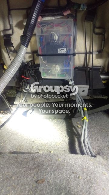

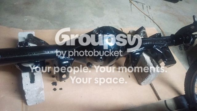

So, while it's apart for gears and lockers I POR15'd the rear axle. Got the switches for the lockers installed and the relay box I made mounted to the bottom of the drivers seat since there wasn't room for it under the dash or behind the kick panel. I put the Locking and Unlocking let's in the box so in the future if I have any issues it will be an easy troubleshooting tool.
That's exactly what the moogs did and I was noticing the same thing in comparison to the oems but didn't realize it's the aftermarket tie rods in general.
Good to know thanx for the heads up..
