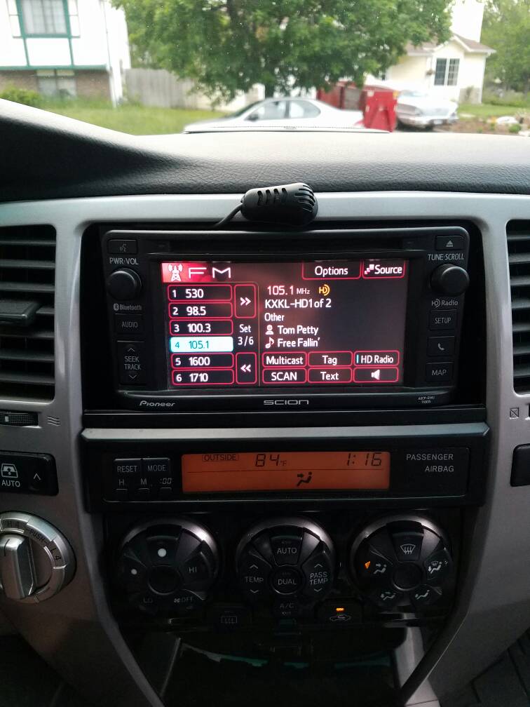

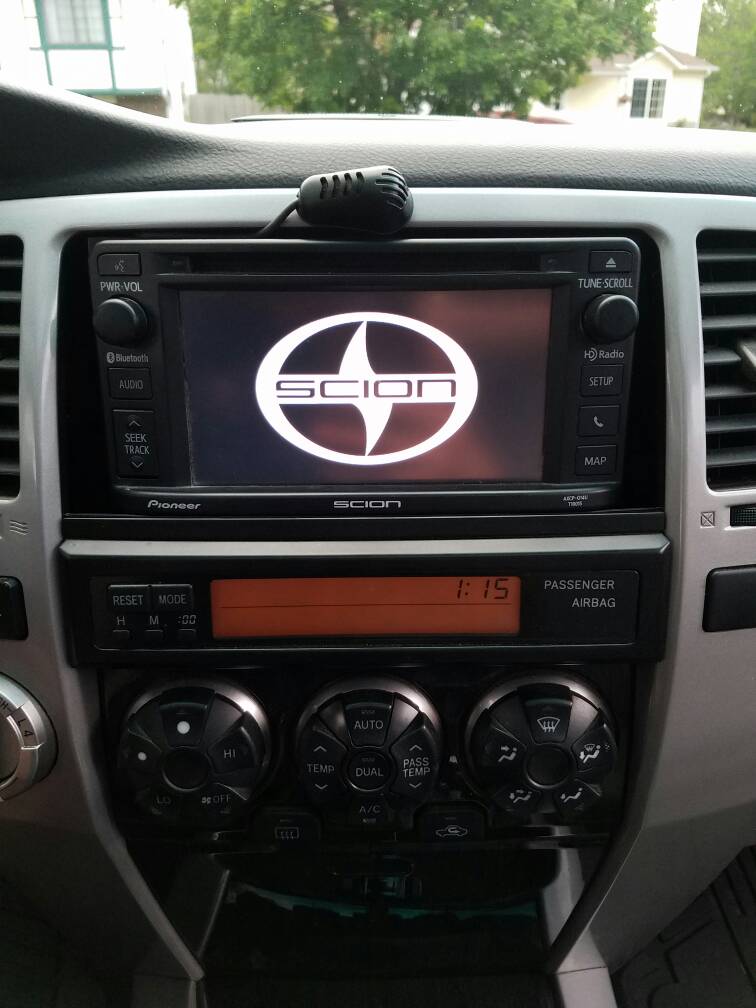

Changed out the stock JBL Hu for the Scion T10015!!!
Still working on the bezel.
Steering wheel controls work perfectly and OMG I can't believe how much the sound quality improved.

did you need any adapters to install this? or is that plug and play with the JBL system.

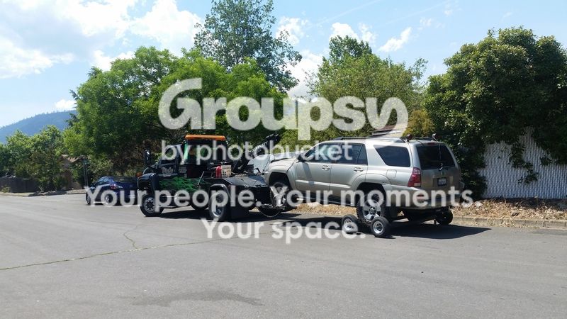

Got rear-ended while parked at a grocery store...damn old people and skinny pedals...actually pushed the 4runner into the driving lane by 6 feet!
Destroyed his car and just made me angered...and the man doesn't have insurance...time to shop for rear bumpers and hatches!

Yes you do need adapters, especially for the JBL system:
--PT546-00120-CH 28 pin harness-Accessory Harness Adapter- Steering wheel controls, etc.
--PT546-00120-AD (You'll only need the part that plugs into the antenna)
--if you want bluetooth PT546-74120-MC
--USB- PT546-00120-US (USB connection if you want that option)
Then if you have a JBL system, you also need:
Metra TYTO-01- Converts the analog output of the head unit to the digital signals the Synthesis amp is looking for.
71-1761- Reverse Wiring Harness- Allows you to plug the converter into the Scion head unit without hacking up any vehicle wiring.
In this link you will find all of the info needed.
http://www.toyota-4runner.org/engines-suspension-wheels-tires-audio-accessories/56441-ultimate-scion-headunit-stereo-thread.html
Sweet, good work man! this and your review of the sound quality, i may just pull the trigger on this.
forgive my ignorance, but did you retain the JBL amp? i thought you had to use that TATO converter or whatever if you were going to retain the JBL amp? this is what was holding me back before.
if i can get this to work...anyone be interested in an e7009 w/ red backlighting?!!

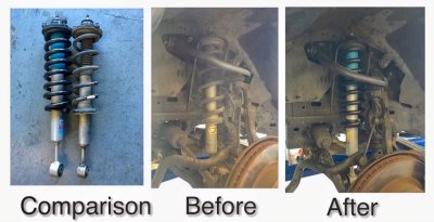

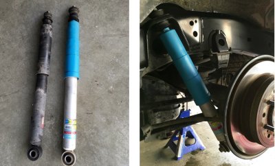

Shocks & suspension swap
Courtesy of my SoCal FJC colleagues, got a set of 2013 FJC front & rear shocks/suspension for my 2004 4Runner. The first suspension upgrade from stock after 12 years @ 120k+ miles. Pending installation is the rear coil spring.
They say, if it's broken - upgrade. But if it's free, swap it. Thanks to my generous colleagues.
