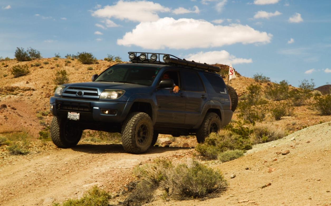

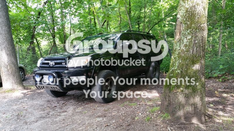

Installed the lift.
Definitely need tires now.
I am gonna keep an eye out for the trd springs. Do you know what years are the progressive's? I just lifted my buddies 11 and it didn't have them. The spacer is from a company that's long gone. I just add about 20psi to make the fj's stiffer. I judge by he way my son bounces bag there. It's not bad and I'm just waiting on a deal on metal techs or icons. My bumper is just making me start all over again
Just got it switched back
I dig it brotha.,gotta try different set ups I do the same s***. Don't like it change it back, the only way to find out for yourself and the rig.

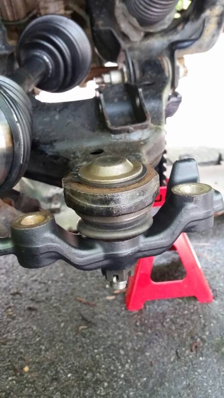

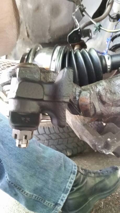

Got the new lbj's installed.

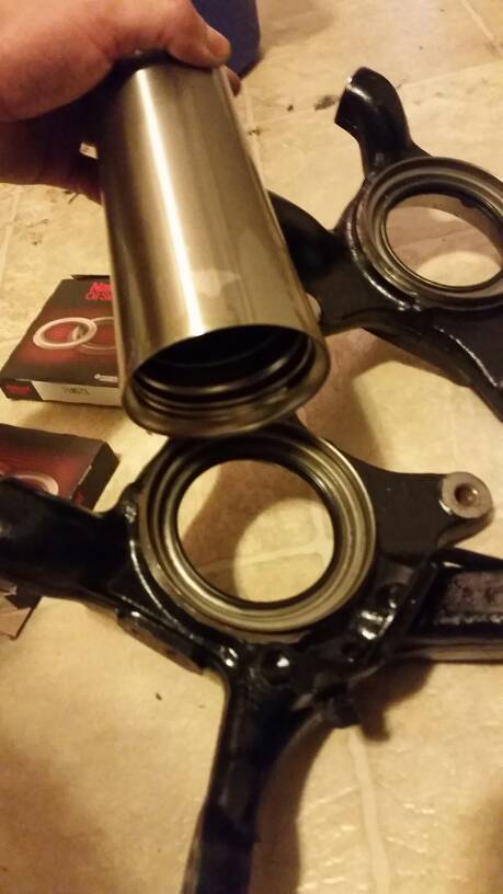

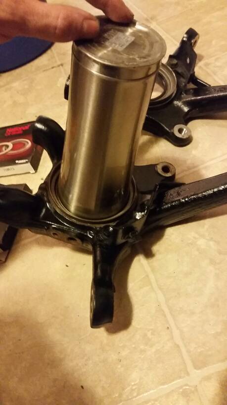

These oil seals for the knuckle were a pain to install without a special tool. Found a metal coffee cup which was a perfect fit to tap them in

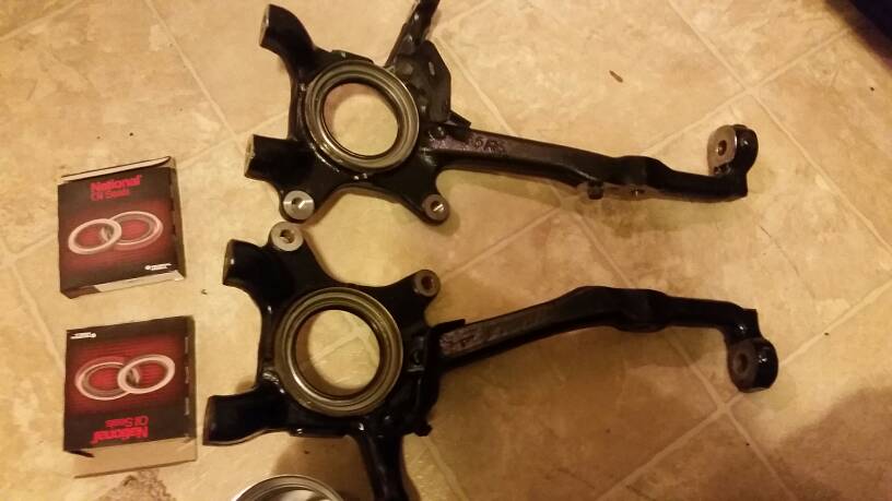

You might noticed I gave the older left hand knuckle a fresh coat of gloss black paint. These are going on tomorrow morning.
New hubs and wheel bearings coming in Monday.
