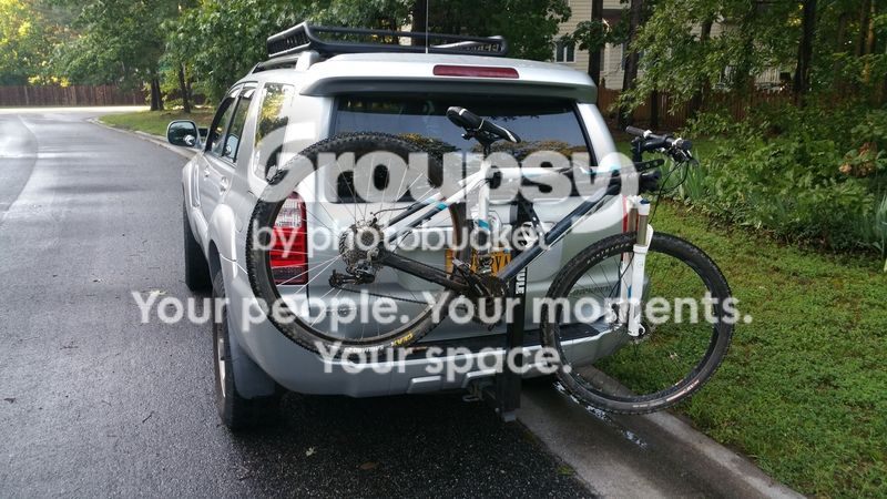

Today I pulled out the camping setup after a weekend in Watkins Glen NY then copy catted some of you guys on here for a cheap bike mount.

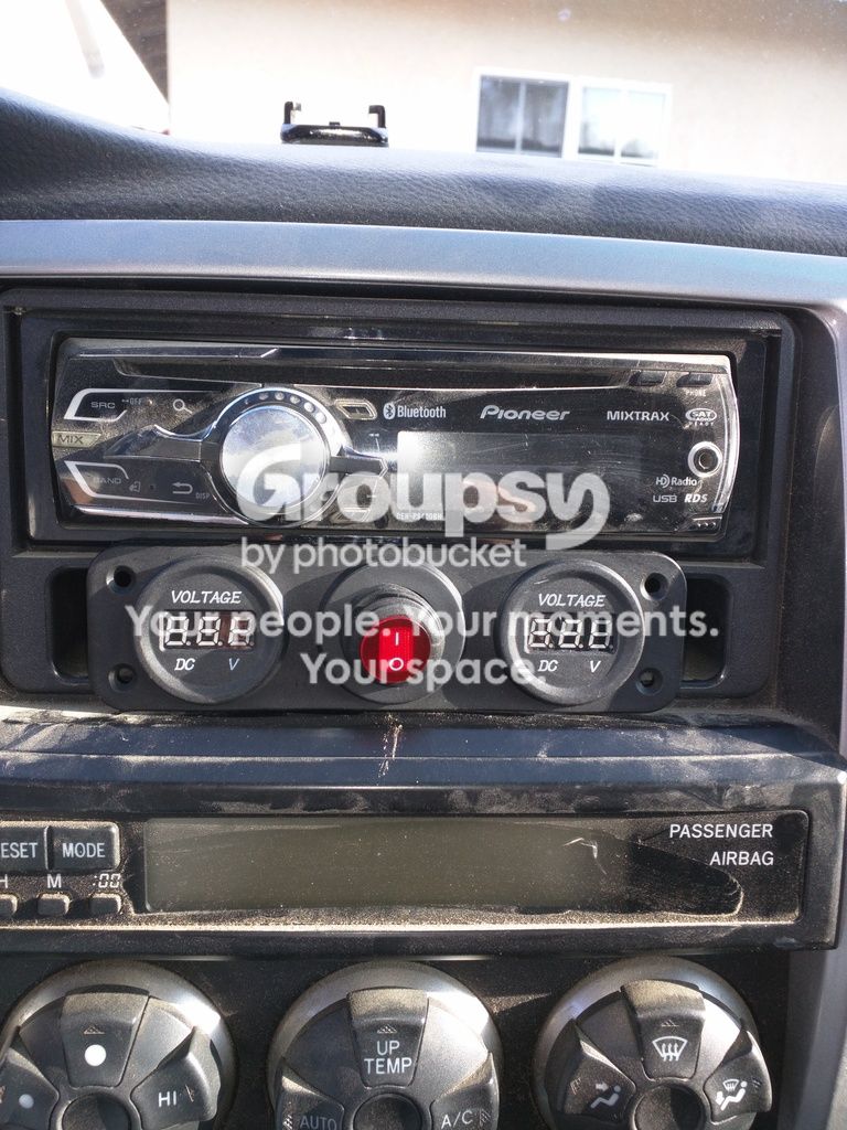

Picked up a dual voltage panel so I can monitor both batteries in the cab. I have a voltage panel in the back for the house battery while the fridge is running, but I wanted something up front so I can monitor both batteries. Probably make a panel to fit there instead of using the stock panel so it fills in the hole better.

i also have a fork mount like you but mounted on plywood and can fit two bikes. great mount and safe inside the truck. just picked this thing up for free and cut the hitch down to fit great with my truck if i go on trails

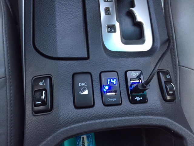

Installed Mictuning USB ports int he centre console. Voltmeter is an added bonus.
Went with blue since I'll be changing all the back lighting shortly to match.
No more lighter adapters.
