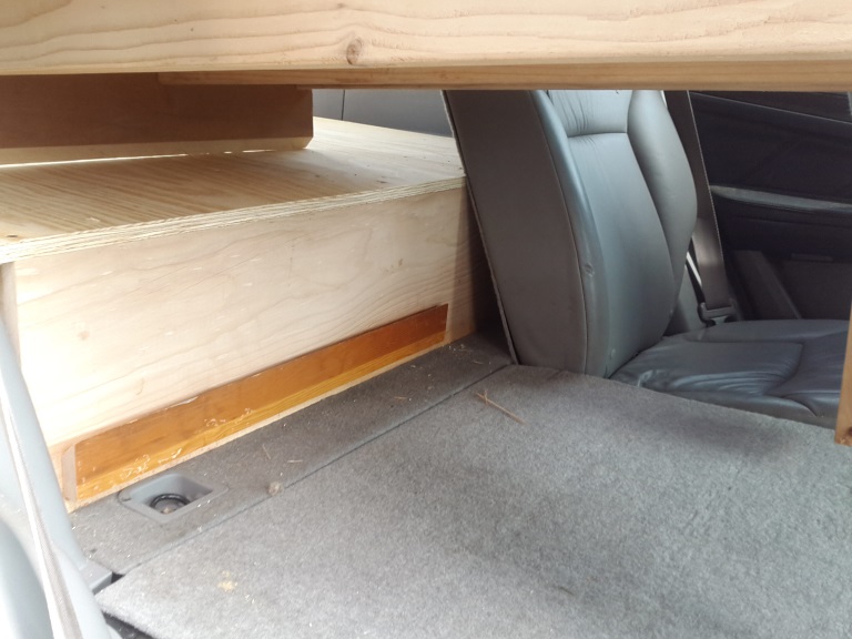

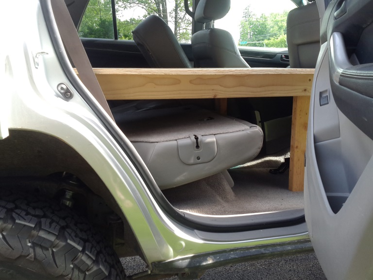

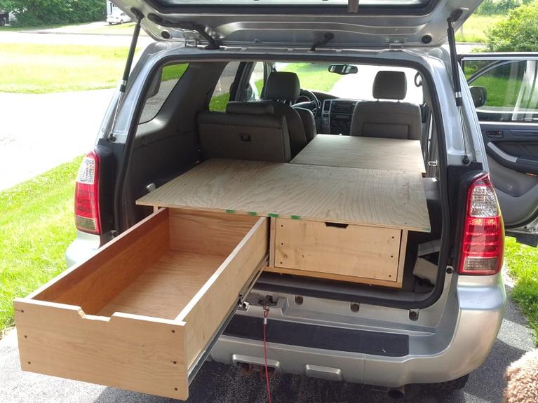

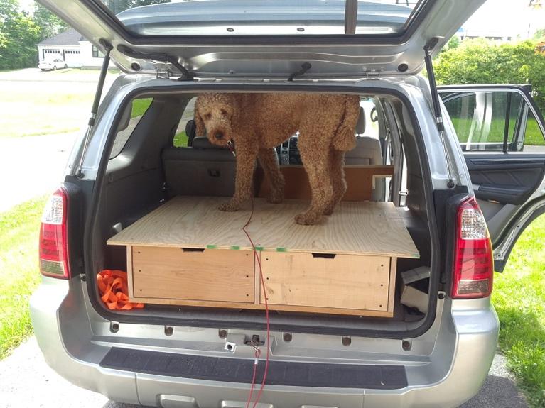

Finished up my drawers and removable sleeping platform. I need occasional use of my back seats so I built a removable platform.
The forward end sits on a pair of vertical 2x4s.
The rearward end connects to the back of my drawer box with a French cleat.
Quality control says head room does not meet expectations.
