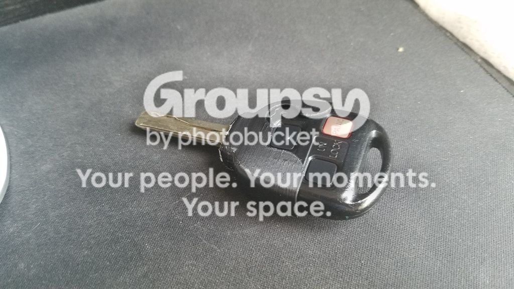

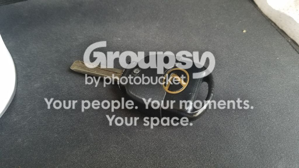

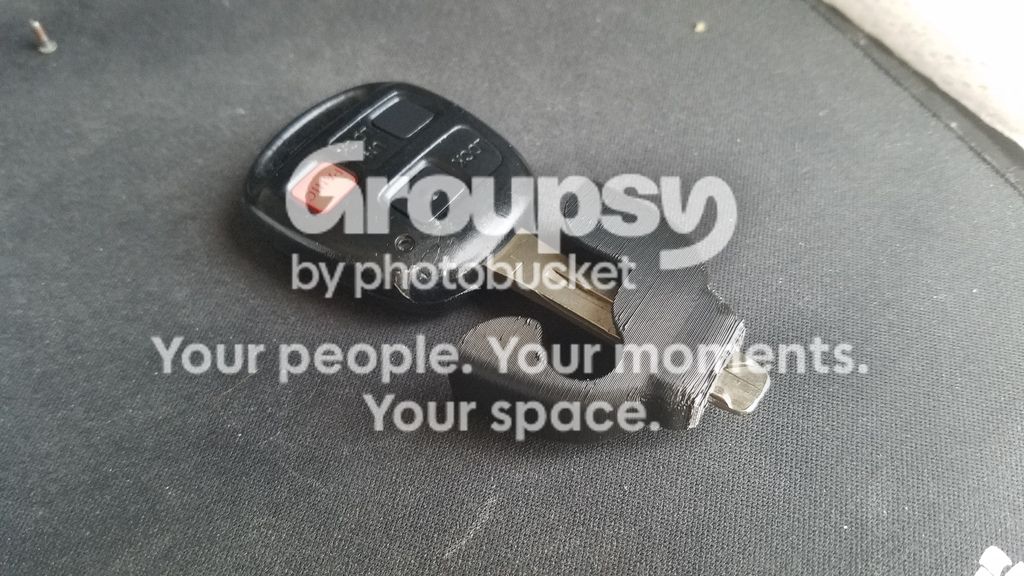

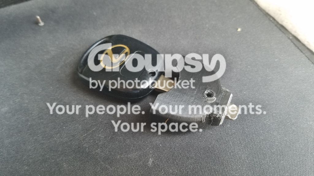

While not 4th gen related, I know there's GX470 guys that browse this forum, plus it's something that could be applicable to 4R's should there be a need.
Apparently the GX470 key+fob assemblies are notorious for cracking right where the metal shoulder of the key is molded into the plastic housing. I modeled up and printed a form-fitting brace that reinforces the key, even if it is already cracked like this one was. May try doing something similar to reinforce the weak keychain loop on the 4th gen fob, but that'll be a bit more difficult as there's no screws I can take advantage of to fasten it.

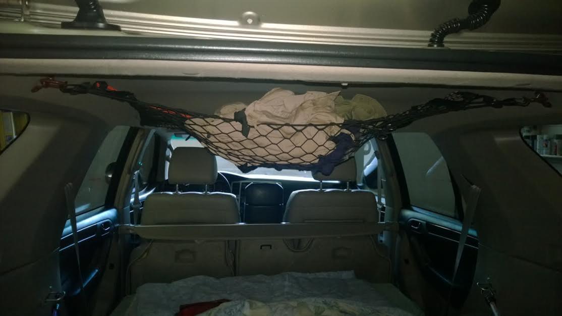

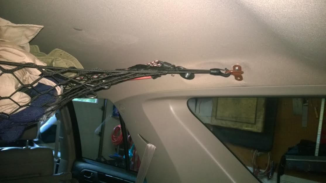

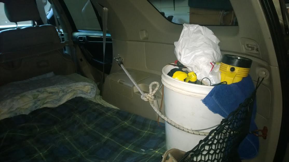

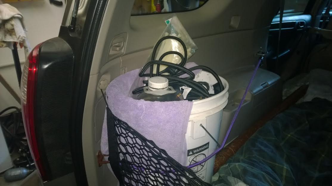

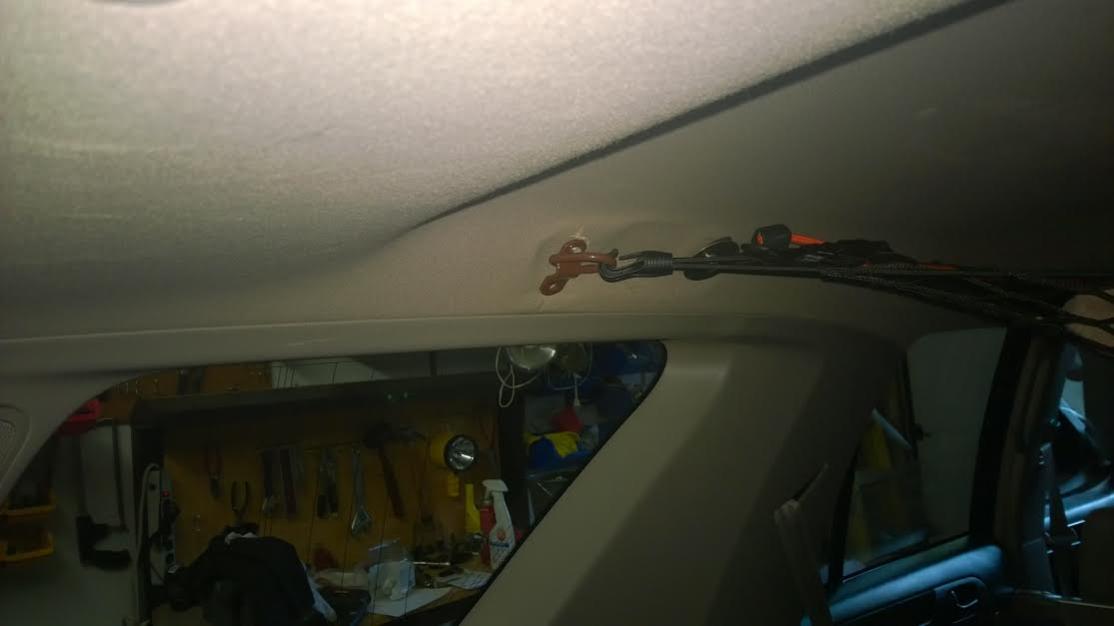

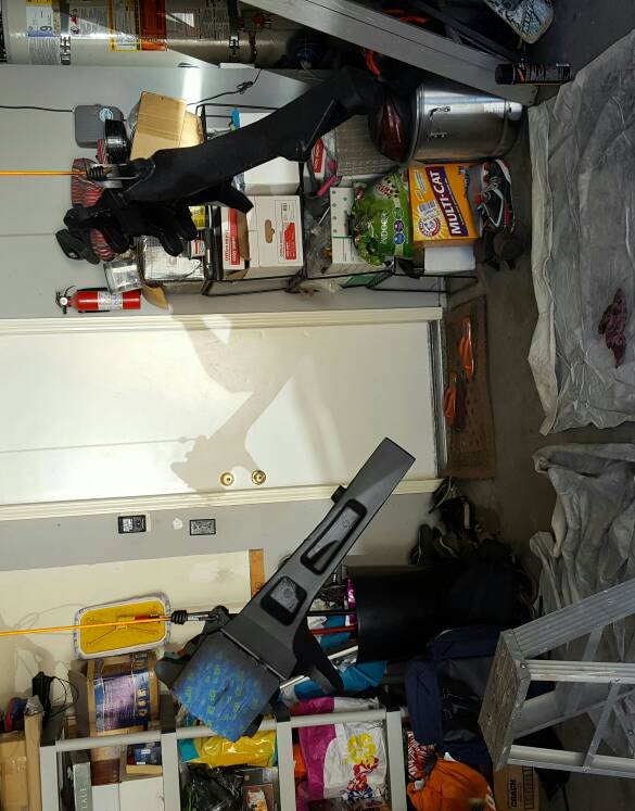

My version of the OEM cargo net up top, thanks for the idea. I know it's not purty, but it's effective and that's all I care about. It needs some work though, I'd like to get the D-ring anchored on the bottom. The 5-gallon buckets with the D-rings added in are stable. Critiques are needed and welcome. Do not shy away from giving a flaming critique. The brown tube on the driver side is the antique Heddon bamboo 9' fly rod. I love those old bamboo fly rods, search and find, there are a lot of classic bamboo rods that are better than the new ones.

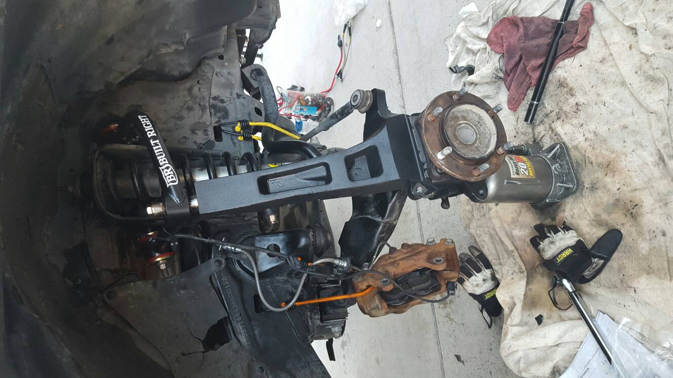

Put some 4" spindle and SS exteended brake lines.
