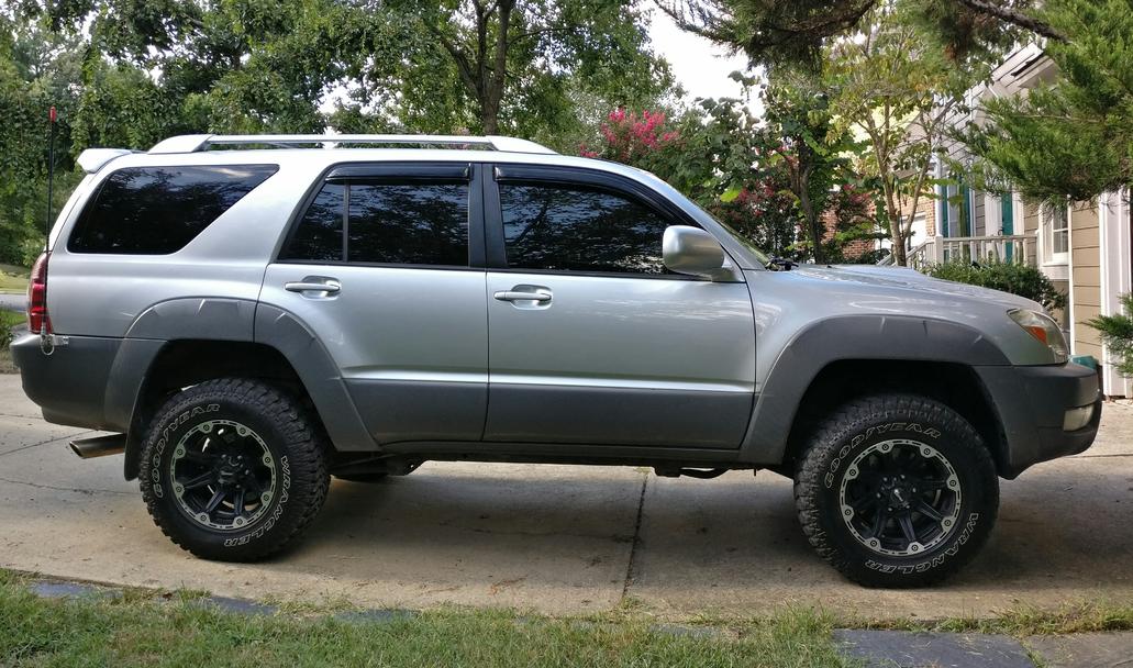

Got my tires and body lift installed. Already had the suspension lift done.
Front: OME 884 on Bilstein 5100s (set at .85)
Rear: OME 895 and Bilstein 5100s
Spidertrax 1.25" spacers front and back
1" Toytec body lift
Nitto Trail Grappler 285/70R17 (C load rating)
Suspension Lift only on old nitto crossteks (245/70R17)

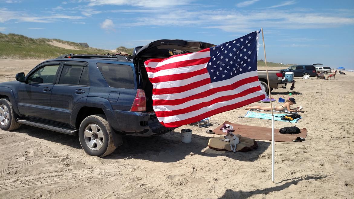

OBX, 4WD required. First time here, my 4Runner hasn't even blinked. Love this.

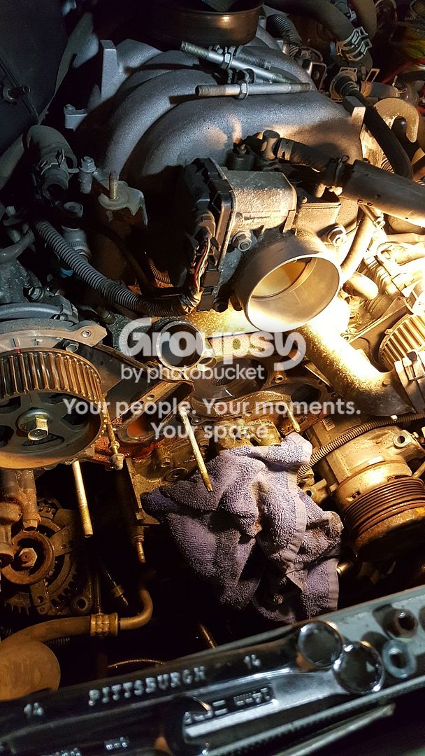

Timing belt job. I must say, out of all the vehicles I have ever done, this 4r v8 is the most time consuming job ever. And to top it off ,rust and rusty bolts had add another 4 hours to it. Never again.

Be thankful you don't have to do it on something like this (my 3000GT). This is the reason I bought a V6 4 Runner instead of a V8. Notice the timing covers on the right side. It's a DOHC V6. Pulling the engine is the easiest way to do the timing belt because of how tight the workspace is.

What makes the timing belt jobs on these so difficult? Is it that it's DOHC? It seems like it's in a fairly easy-to-get-to spot

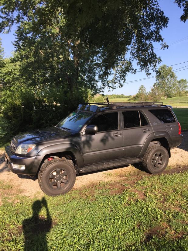

Purchased this 2003 v8 sport edition with 147,000 miles this week. Seems to be in good shape other than the drive line clunk. Replaced my recently totaled 2005 v8 sport (RIP)
