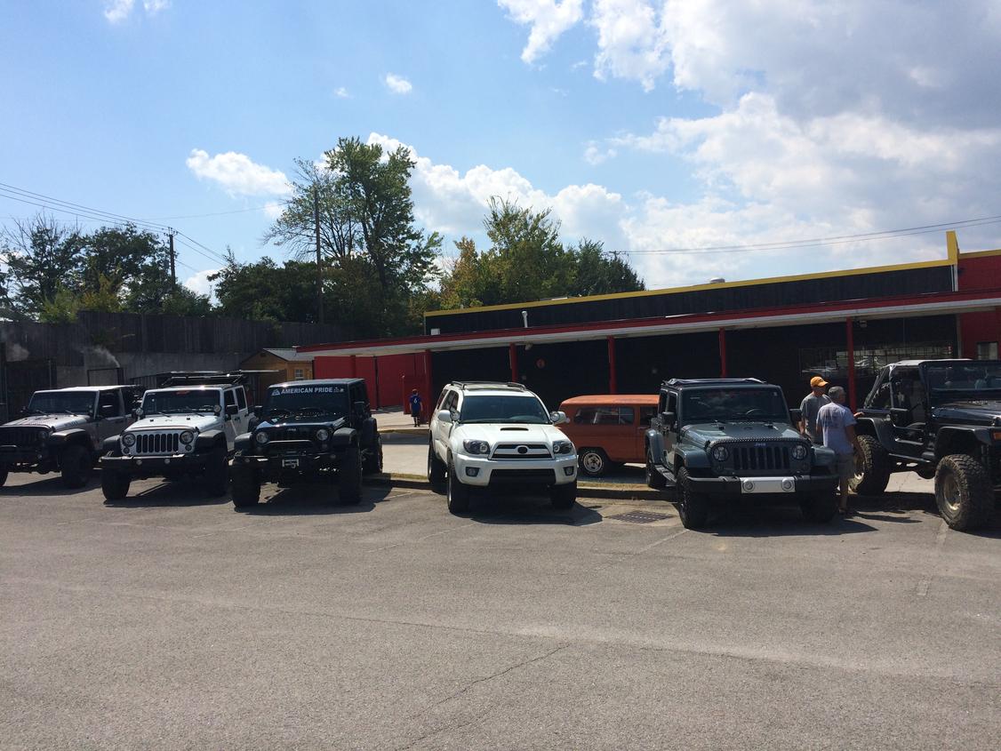

Today I crashed a jeep meet

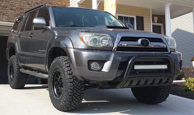

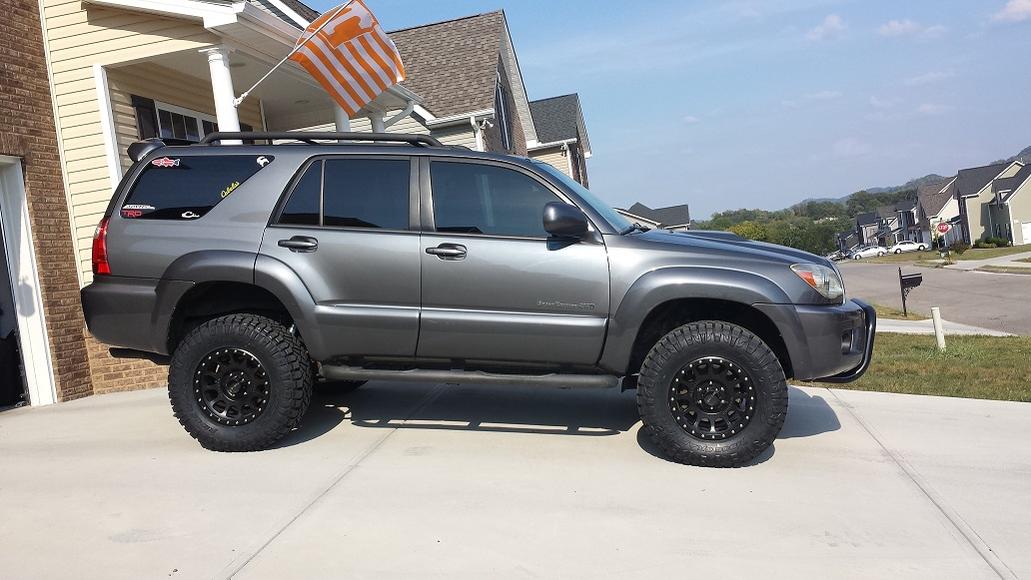

New lift installed 2 weeks ago using the no spring compressor method. Front: OME 884's with bilstein adj. 5100's set at "0" and no top plate spacer. Rear: Toytec Superflex w/ bilstein 5100's. New tires put on 2 days ago, they are Nitto Ridge Grappler 285/70r17.

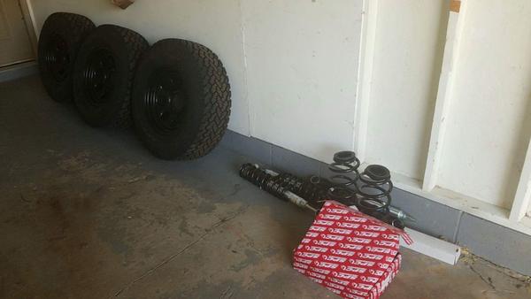

Got my new tires mounted on my wheels. Almost ready to put everything on!
General Grabber AT2 285/70/17 on black rock steelies
Bilstein 5100s, OME 895 and 885, SPC UCAs, RAS to coil, and diff drop
Also has Fat Pats 2" body lift already installed

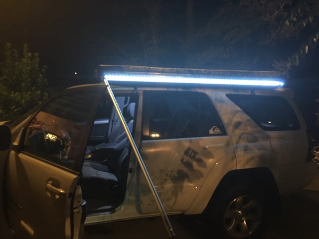

Got my ARB awning mounted to the stock rack, built some brackets. Overall pretty simple. Going to see how well they hold up and change them if I need to. But overall I'm stoked.
Oh and pro tip. I got a battery powered led strip from eBay for like $9 shipped....and its 200cm which is basically the length of an ARB 2000. I like that it's battery powered so you don't have a cord going all the way to a cigarette lighter like others that I've seen. [emoji1303]
