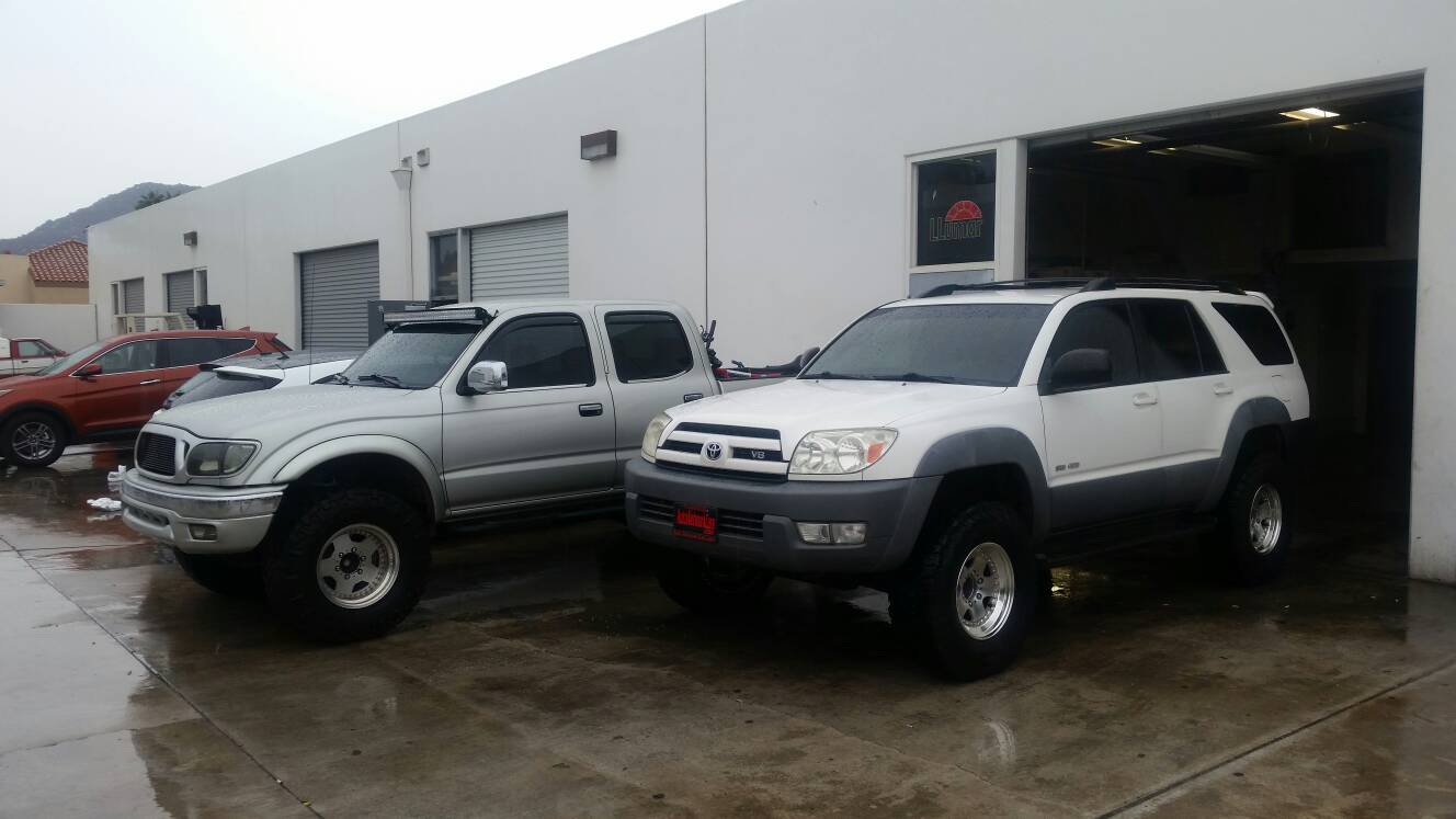

I'll be damned. You make the 3rd white with cladding I've ever seen. Looks good. What do you have done to it?
Just tint, 16s and 33s, daystar lift front and rear, and 5100 bilsteins on the 2nd notch. Looking at rack and ladder next, and paint the cladding silver

I wanted to paint my cladding at first too. I've grown to love it though. Can't wait till I can shorten my commute, and put the bigger tires back on. Either way, cool truck.
