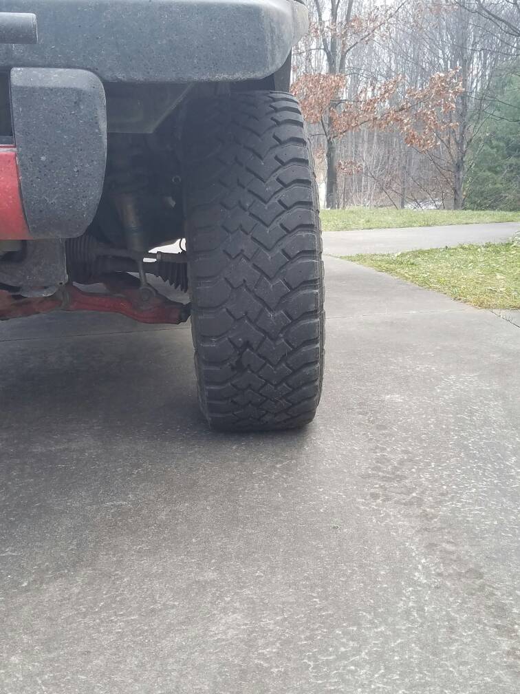

So a couple people on here (sorry, I forget who to tag them) mentioned that my spindle may be bent, and this could be causing my wheel bearings to be going bad prematurely, which was why I replaced it. Well I know it's hard to see in the pics but the drivers tire is cambered over quite a bit now with the new one in. No alignment tabs were touched, and I had an alignment not to long ago, also the tire looked like the other side before the swap. It is now also rubbing on the uca at full right turn and under compression. I'm going to loosen the balljoint and pull it over a little until I can replace the bushings in the uca's and get a new alignment.
Also, I think the passenger side wheel bearing I got from the salvage yard is bad. Trying to determine if it's the drivers side tire digging in cause the camber is so high, or noise from the passenger side caliper that is half frozen, dragging and getting replaced in a few days, or the wheel bearing. Need to jack the front up and see if there's any play.
