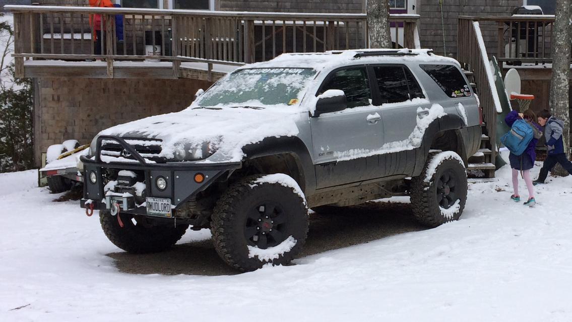

Got the new wheels and tires on today!
Wheels have a zero offset wrapped in 275/70r17 KO2 tires.

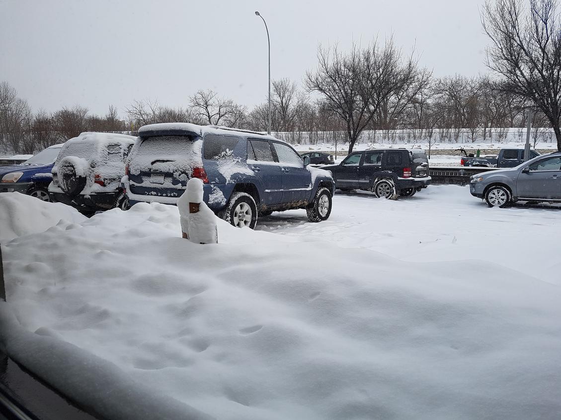

Awww Your snow is cute. This was the last 24 hours.
Wow! You've got quite a lot this early in the season. We don't usually see snow until Jan, and between Jan and March we will get several feet. In 2015 we saw 17 feet! It varies quite a bit for us, being coastal and all. Have fun with all that white stuff! :)
Its been a blast so far. We got roughly 14 inches over a 24 hour period. alot more to come over the next few months.
