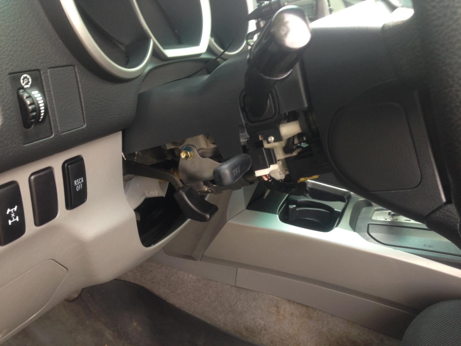

I didn't take any pictures during the install, but here is the final product minus the lower cover, the bottom cover on the telescopic models has a long rectangular hole that allows for the adjustment lever to be accessed.
The second and third shots show the range of adjustment.

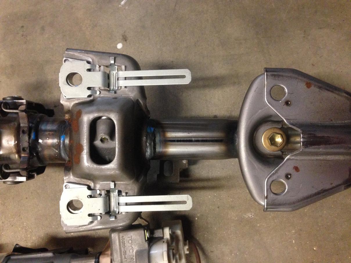

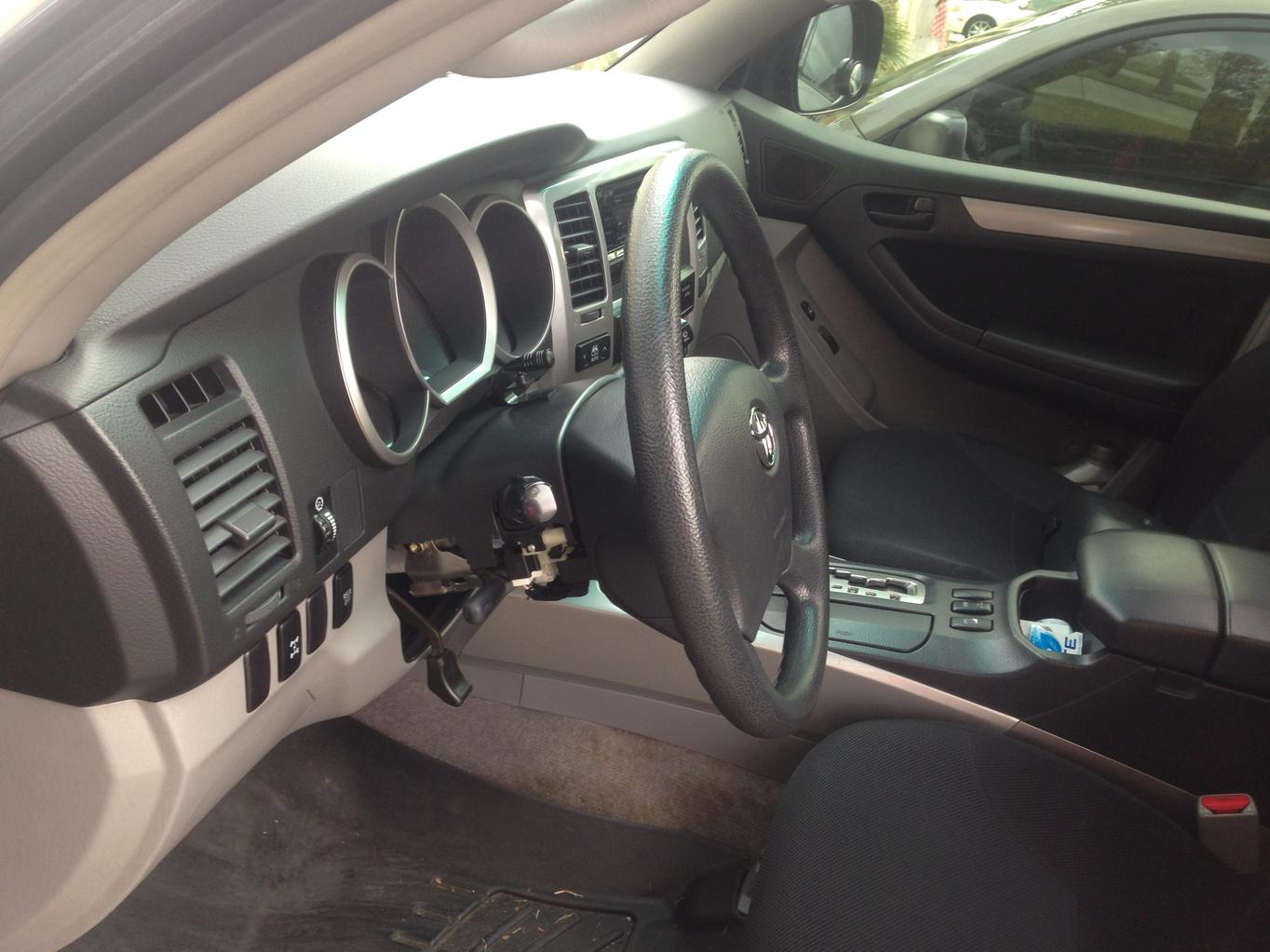

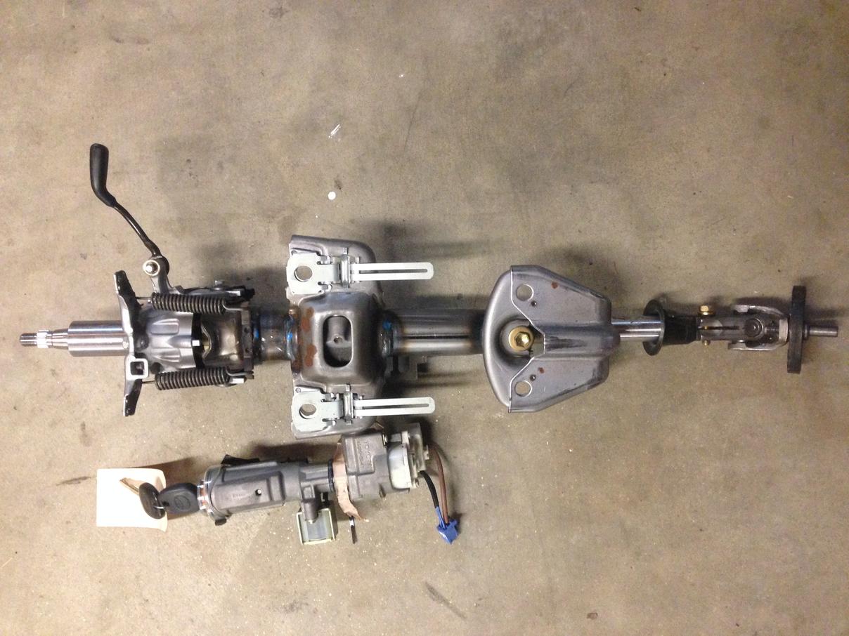

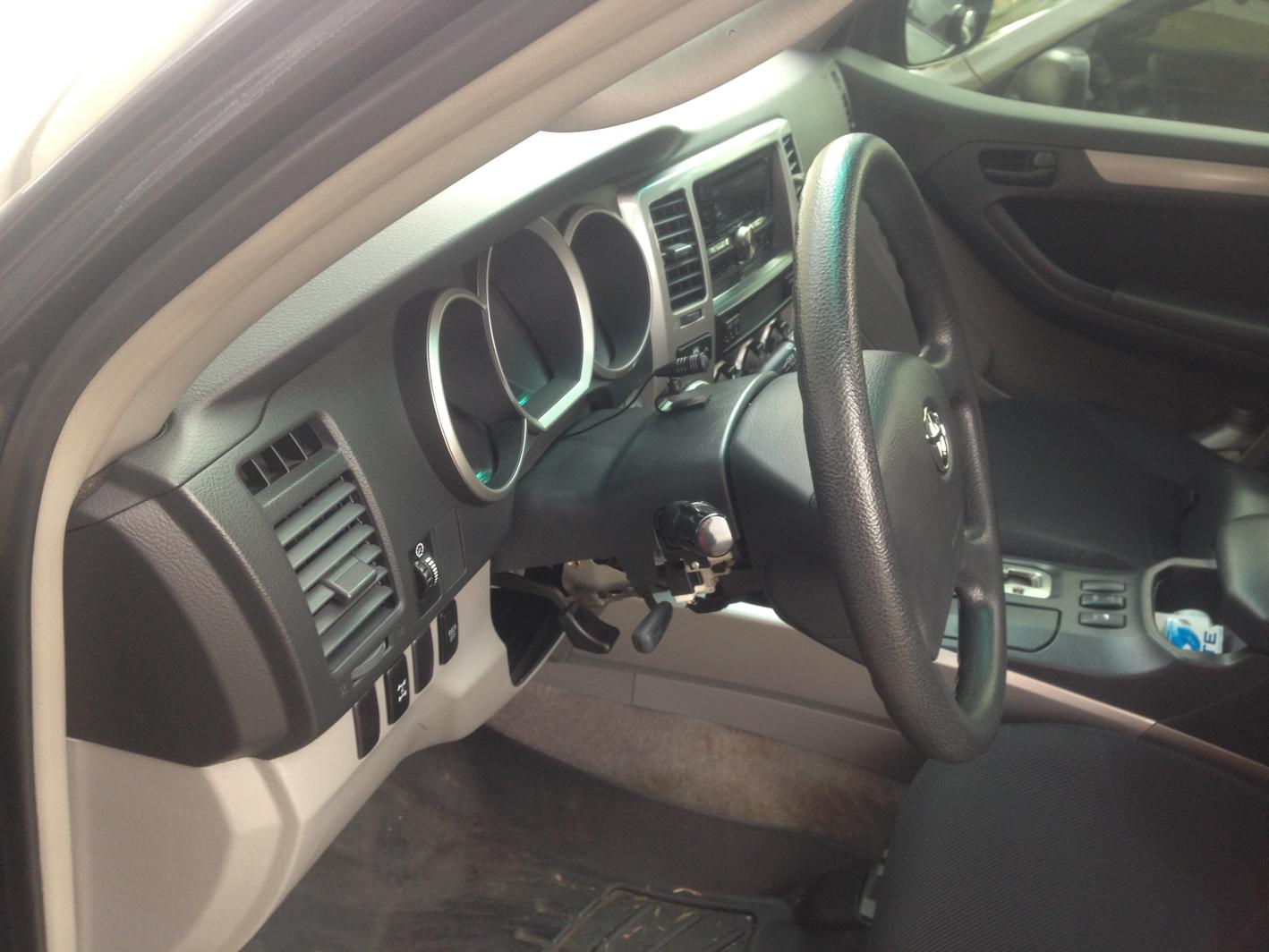

The swap was really straight forward. After doing some research on the subject I read about another member on this site that had a shop swap out pieces of the column to convert it to being telescopic.
If I remember correctly that was about $1000! Ouch!
So after reviewing the parts schematics between the two columns it looked like it was going to be a pretty easy swap, I sourced a complete column from an 04 Limited 4x4 on EBay and went to work with the swap.
After the steering wheel and lower dash cover were removed I removed the combo switch cluster. There are 4 nuts holding the column in place and one bolt at the end of the column where it attaches to the steering shaft coupler.
Yes the pictures below are of the old column but all the mounting points are the same. The third picture shows the gold bolt that is at the end of the shaft.
