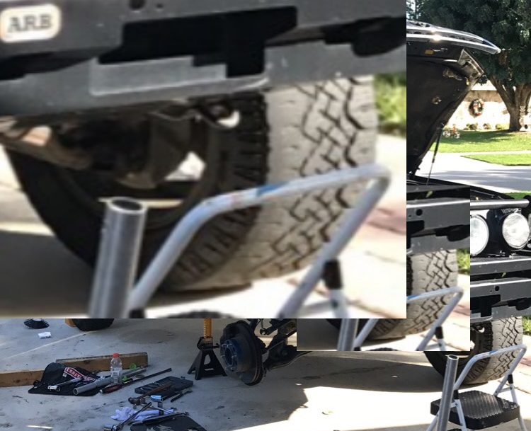

Looked underneath the front of my Runner, and discovered grease coming out of the CV boots, after I put a 2/1 lift on this weekend. Not what I wanted to see! :redbrick:
You more experienced guys have any advice?

Check out this recent thread. If they are leaking from the clamps, best to reclamp with the marine style worm drive style...
http://www.toyota-4runner.org/4th-gen-t4rs/229961-replace-cv-axle-tighten-clamp.html
Last post in this thread talks about what parts to order from McMaster Carr.
http://www.toyota-4runner.org/4th-gen-t4rs/113514-cv-boots-leaking-3.html
If they are leaking because they are torn then you'll want to replace axle or reboot. Rebootings cheap, not too bad of a job, and great time to swap out to the worm drive clamps.

Thank you very much! So this leaky CV symptom is very common once you change the angle of the joint?
Seems the grease took the path of least resistance, which was out the smaller side. Again, I appreciate the feedback, and I'll be picking up some of those marine style clamps.
Yes, they may have been leaking even a little before you lifted it and you just didn't notice. Might just be spinning them up at that higher static angle. Either way, push that boot back, clean the shaft well, and reclamp. Those will be fine.

You are 100% correct! I looked at a "before lift" picture last night, and saw that there was some grease residue in the same spot. I guess those clamps just need a replacement. I ordered those clamps from McMaster yesterday, and luckily they are right here in Robbinsville, NJ, so I should see them here today.
Thanks again! You guys are schooling me up on this 4Runner fun quickly.
