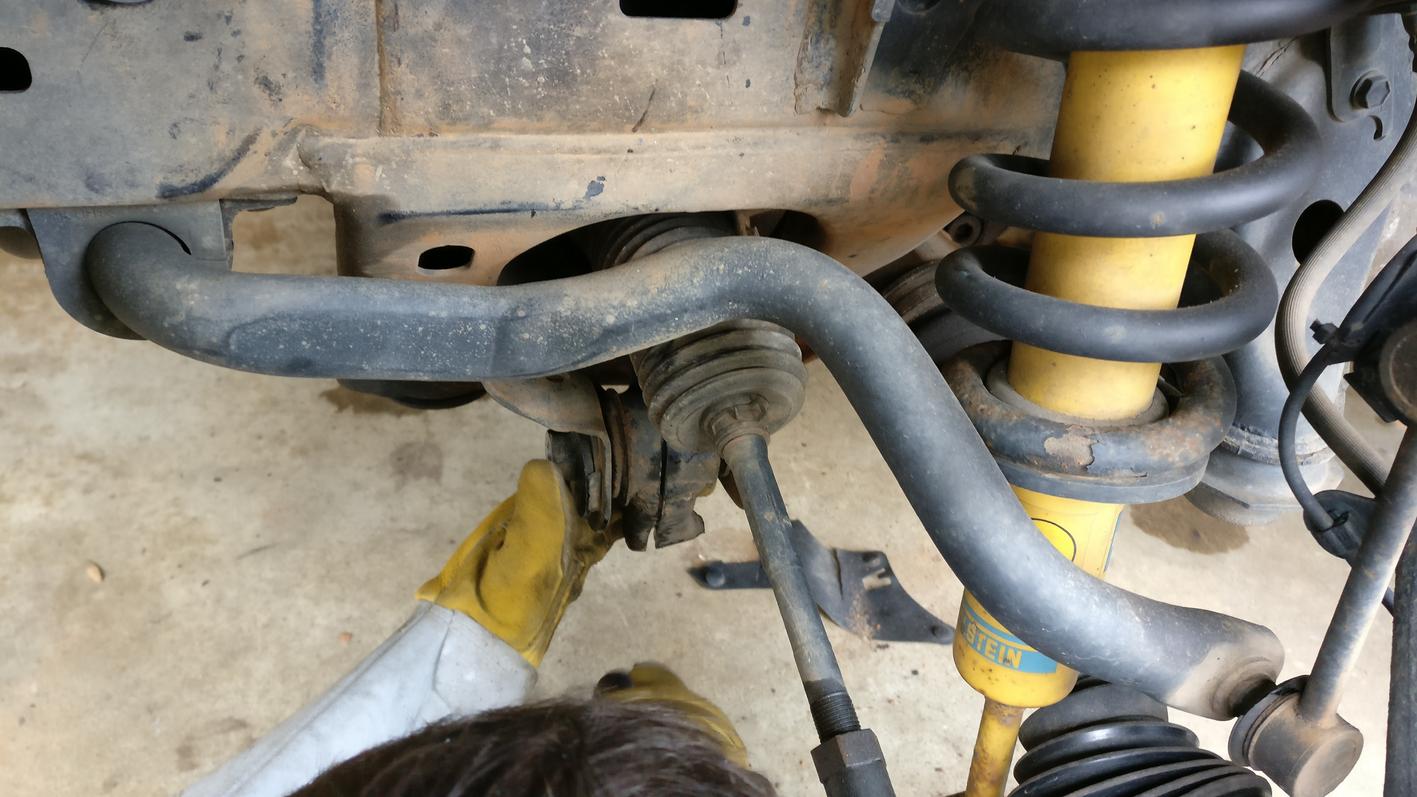

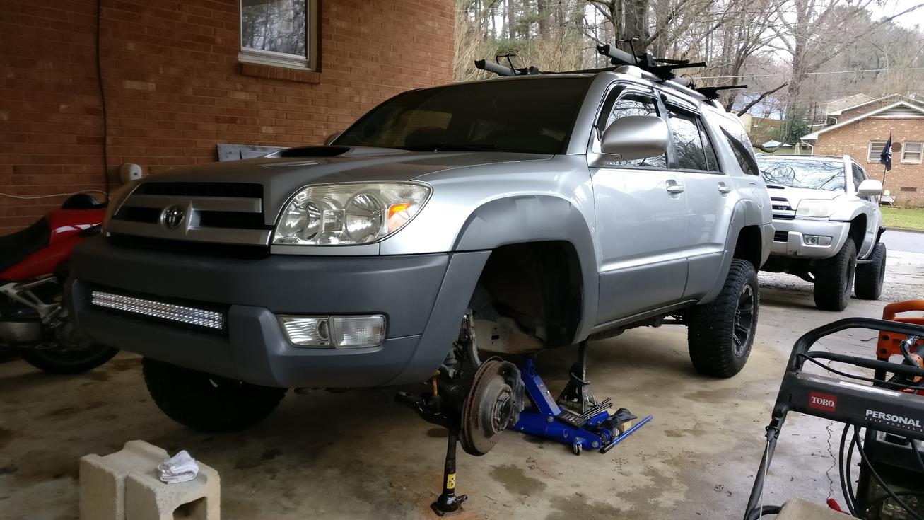

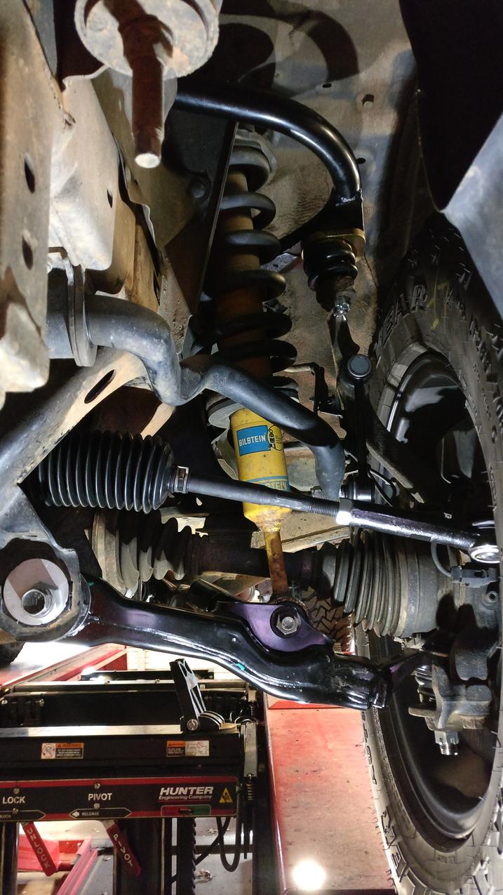

With the help of [MENTION=104973]BusinessHippieRH[/MENTION] (okay he definitely did all the hard stuff... well pretty much everything actually.. but I at least learned a lot! haha) I now have new upper and lower control arms, inner and outer tie rods, and sway bar links. This was a much longer process than we thought it would be. Took a few days with waiting on parts (had to cut out the old arms due to the typical seized cam bolts, and order new Toyota cam bolts)
Parts installed:
SPC UCA's - $480
Ebay Front end kit, $217. link: GX470,4Runner,FJ Cruiser,Control Arms Sway Bar Links,Tie Rods $5 YEARS WARRANTY$ | eBay
OEM cam bolts - ~$200
Sawzall + many blades... ~$100
Alignment from nearby shop - $150
Torque wrench and pickle fork - rented from Autozone

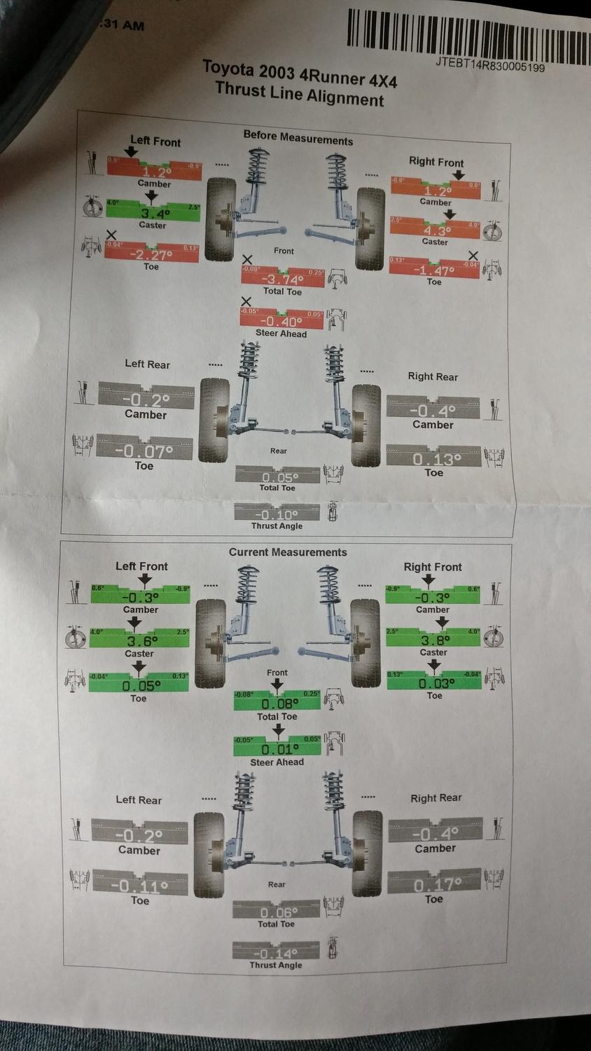

Truck rides great now, alignment specs attached. Got it back together just in time to drive it in its first snow storm. Lots of drifting was done! I also coated the underside in Fluid Film to try to prevent more rusting with this salt.
I am hoping that the cheap parts last well... $800 for OEM Toyota lower control arms (NOT including cam bolts, sway bar links, tie rods, etc) was just not a possibility. Tie rods are my biggest worry.
Same kit [MENTION=101553]t-man[/MENTION] has, so hoping for the best since I think his truck sees more abuse than mine at the moment haha

Charged me an hour of labor on top of typical $70 alignment fee since everything was terribly out of whack with the new parts and the adjustable upper ball joints. Took him over two hours to do everything. (I stood and talked with him the whole time since the mechanic was cool.) Seems to be the going rate when aftermarket parts are involved.
