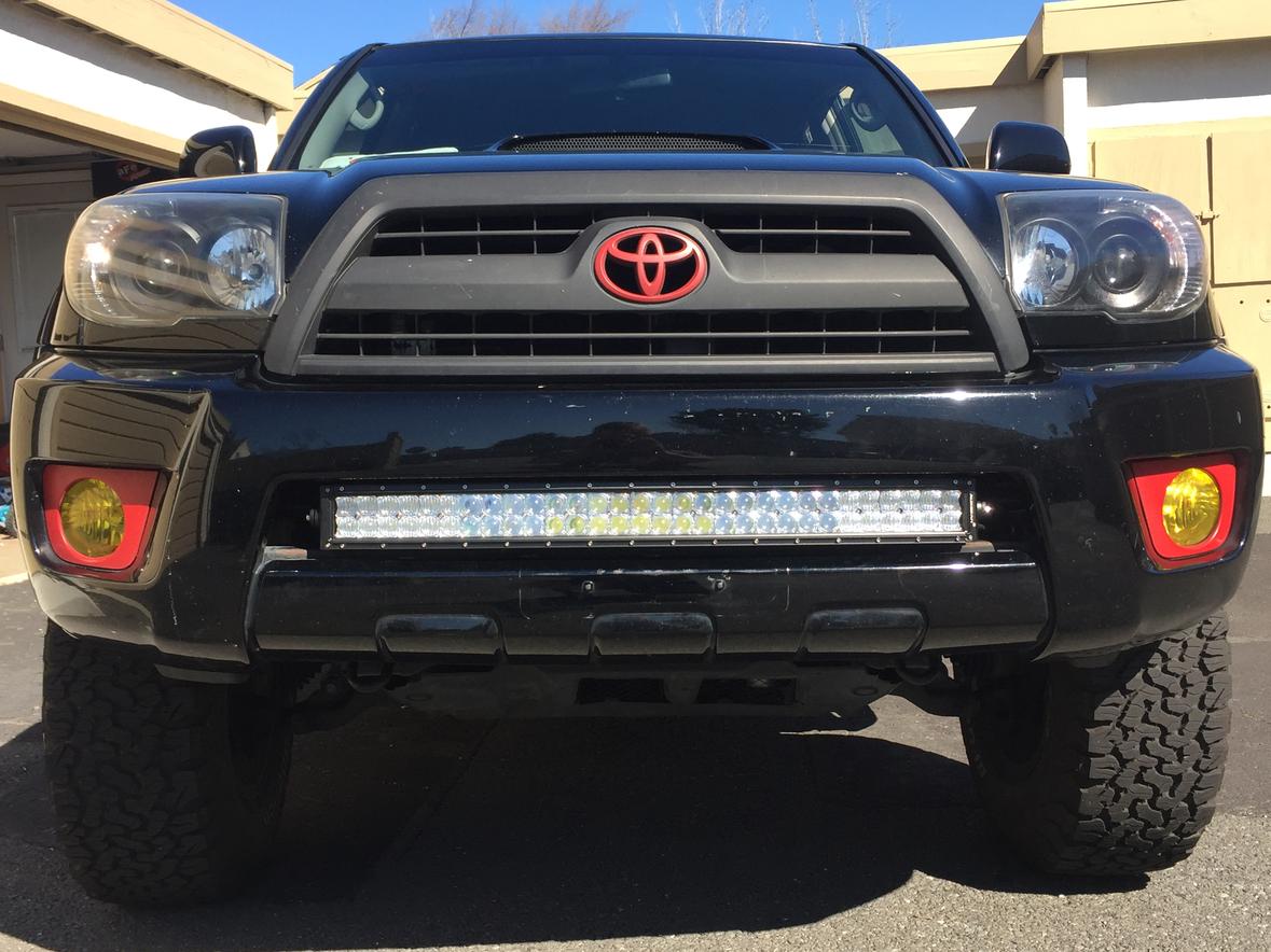

Changed my oil, greased my zerks, got balance/rotation done. Installed 32" curved bar. Still have to finish wiring. Just a test fit and fill that damn hole.

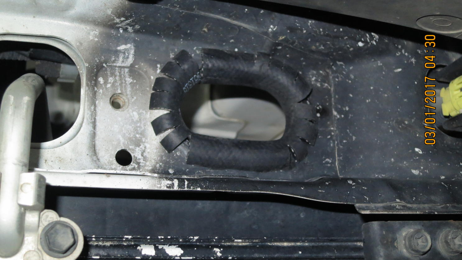

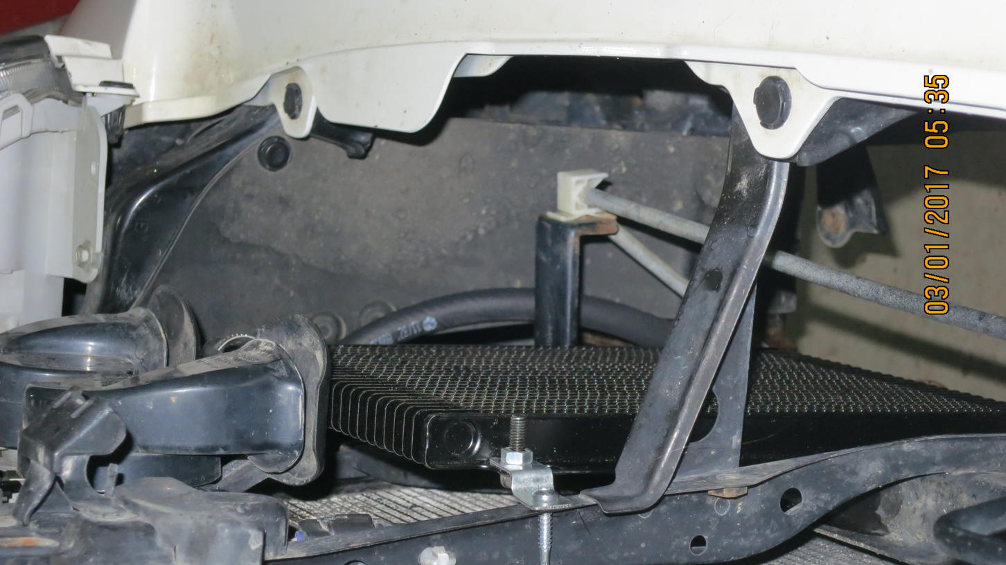

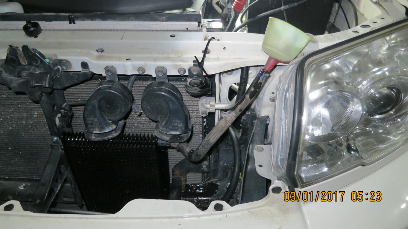

Got up early and finished putting the oil cooler lines in, only lost about an ounce like everyone said. I notched the rubber hose to use as a grommet, then added about 1/4 cup of trans fluid to the line and the oil cooler. I took about 1/2 hour but it did drain the funnel. Then changed the DRL back from the LED I put in, they just blinked too fast, and no efficient fix. Then came in for breakfast! Two of the pics turned 90 degrees.

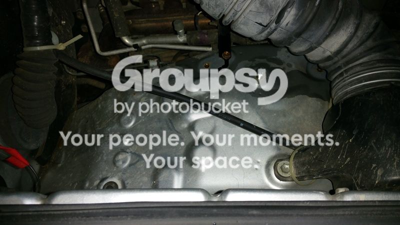

trying to find out how to mount my air compressor
FB_IMG_1488321296387_zpscbnrffzi.jpg~original
20170228_180634_zpsrhkxvvks.jpg~original
I was going to put mine in the same spot, but I decided to do a dual battery setup, so I have to find a new place for my compressor. I'm starting my rear bumper build today, and might incorporate the compressor in the back somewhere.

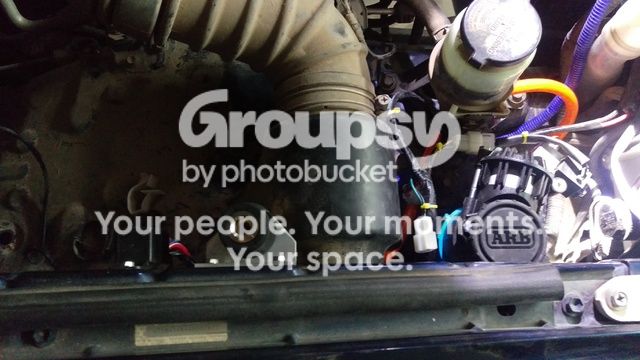

I mounted my ARB behind the passenger headlight. Tight fit, but it worked out well and I still have room for my dual battery setup. I don't know if yours would fit that way or not, but it's worth checking out.
Sent from the Far Side
do you have a tank it fills or do you use it as direct air? Also, wheres the damn hose insert for that on that model? I cant seem to find a good pic of it, i want to do similar.

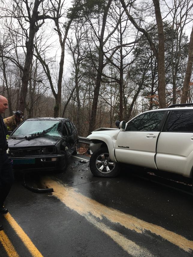

Today the 4th gen community might have lost one. Teared up a little bit as they hauled her away. Be carful out there guys and girls
Currently no tank. Got my front locker hooked up and the connection for the hose is mounted on the side of the engine bay.
Oh Crap!!
Looks like it's damaged enough that the insureance company may total it.
What happened, did the other driver cross left of center?
Hope no one was hurt!!!
