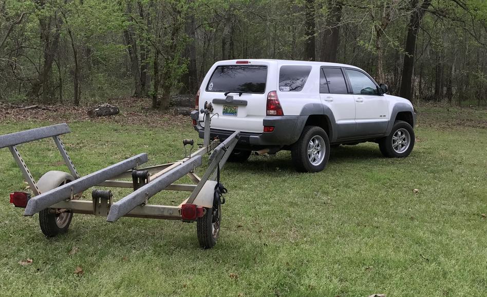

Hauled a loaded boat, 5 people, a dog, and a cargo space full of supplies to our camp house. The 4Runner never skipped a beat. Can't help but to think my wife's 5th gen would have fussed a bit with 3 hours of hills.

where did you get those sway bar end links from? I just replaced the frame mount bushings and need to do those next, wasn't able to find any with the red bushings
They are skyjacker extended rear swaybar links.. I forgot the part number but it's the ones for an fj on Amazon
Sent from my SM-G935V using Tapatalk
Got a set of Goodyear floormats from Costco for $13.99 (clicky).
They don't compare to weather techs, but I almost get complete coverage for the driver and passenger side. I only get a sliver of exposed carpet by the doors. More than happy for the price. Just needed to trim a corner on the driver side mat for the dead pedal.
The rear mats are tiny, but they work for me as I rarely use the back seats.
I was wondering to myself the same thing. I have been checking the threads a couple times this past week to make sure the locknut wasn't creeping up on them. You think I should tighten the locknut down some more? I wasn't sure how far I should squish those bushings down.
Yes. Tighten down until the bushings starting to squeeze and you see a little bulging. As soon as you see them bulging slightly from you tightening, stop. That's where you want to be. That gives it the right amount of tension for the sway bar links to have that bouncier smoother effect that they were designed to give. If you tighten them down correctly like above and still don't have much threads left, I would use a drop of loctite just to ensure things.
It's not a major component but I wouldn't want my new links falling off somewhere down the road, especially while I'm offroading or what have you
