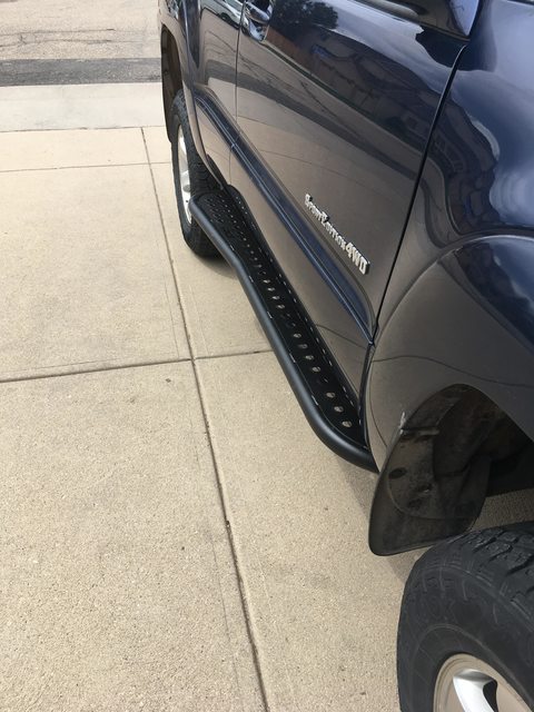

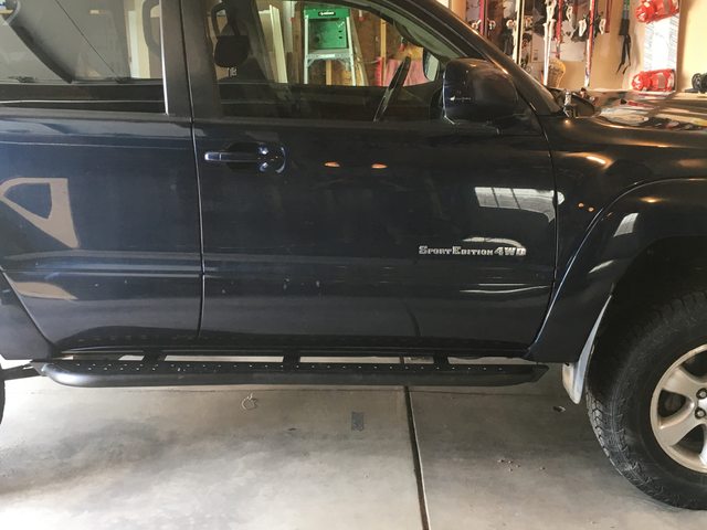

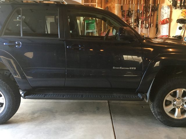

I installed my RCI sliders and swapped my ski racks for 4 bike trays in prep for Moab vacation starting on Thursday! Now I just have to drive through a late season snow storm with my camper in tow to play in the desert! We're hoping to run Fins N Things and/or Top Of The World!
