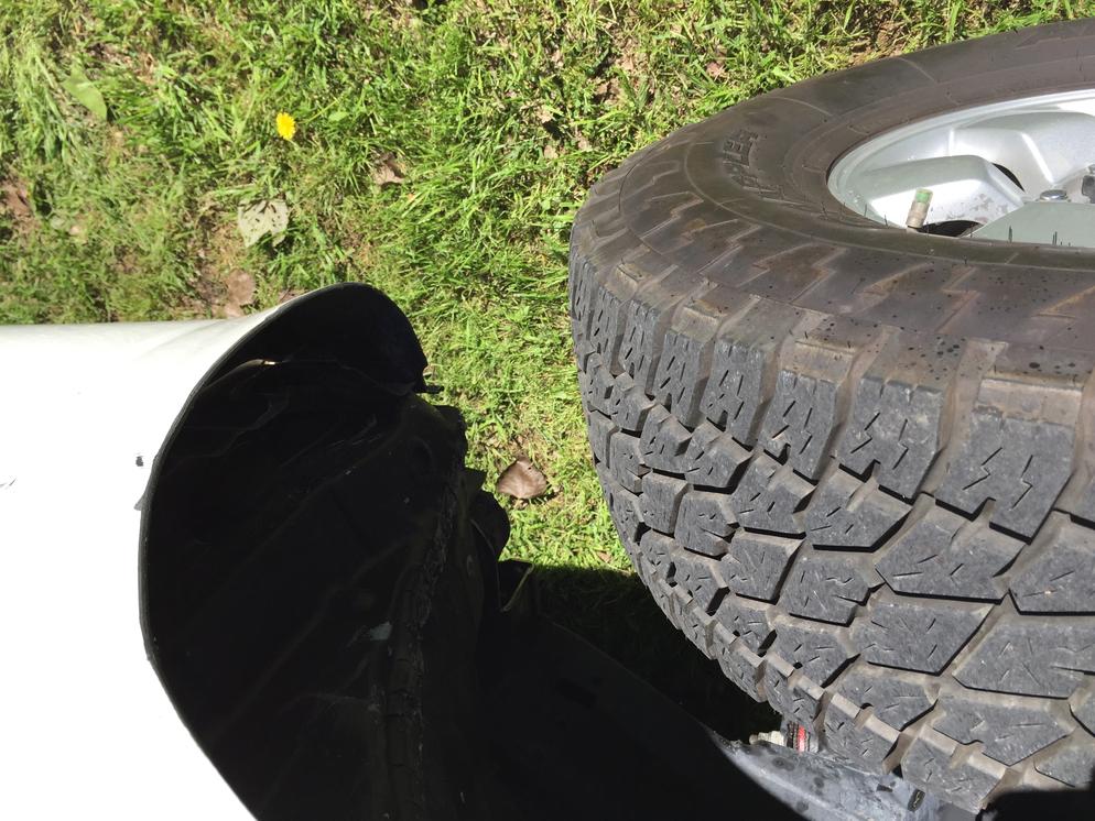

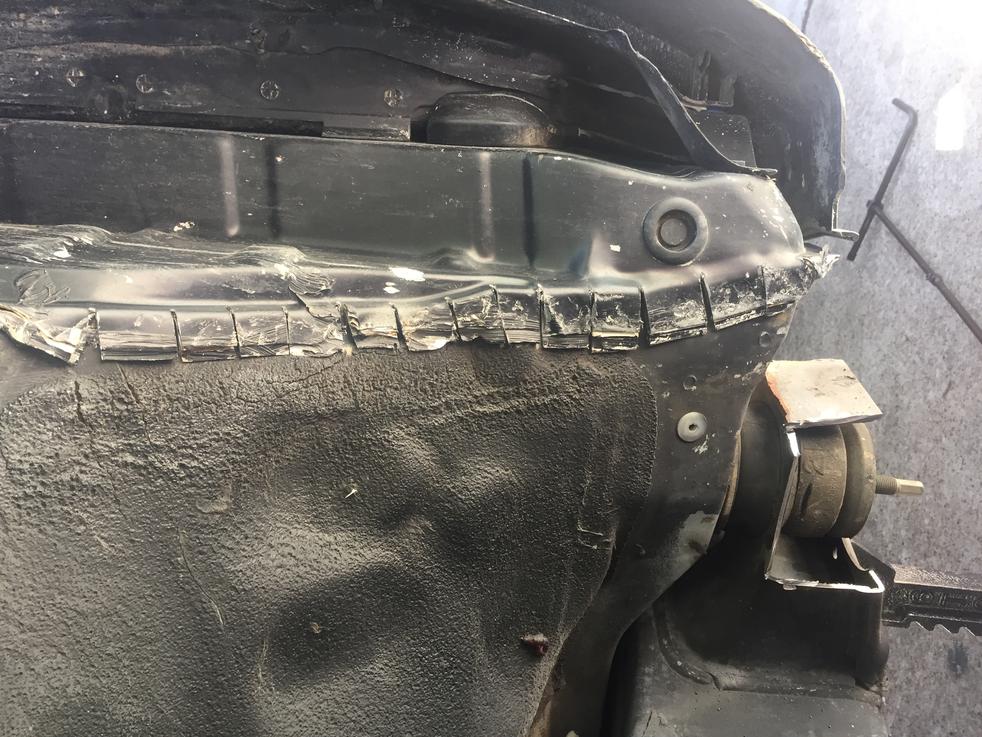

More body mount chopping and pinch weld flattening

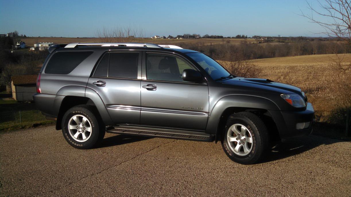

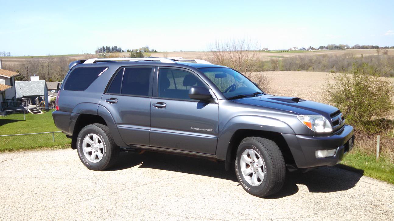

And so it begins...Before and After Running Board-ectomy.

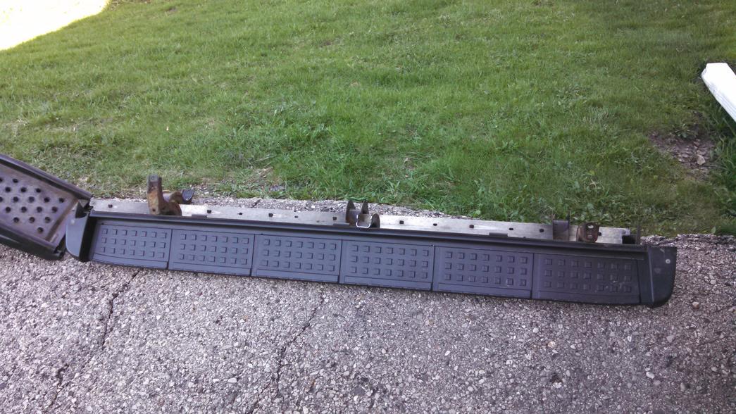

I have to get that job done too.
Pinch weld was alot easier after i cut it, tried it a while back with my 8lb shorty with slow progress then went to the 10lber that was too slow too and wasn't going to get the 16lb sledgehammer out because i would need to then use my body hammers out. 6" death wheel and a 32oz ballpeen made cake work of it.
So much room for tire now, thinking 34's after these 285s are done

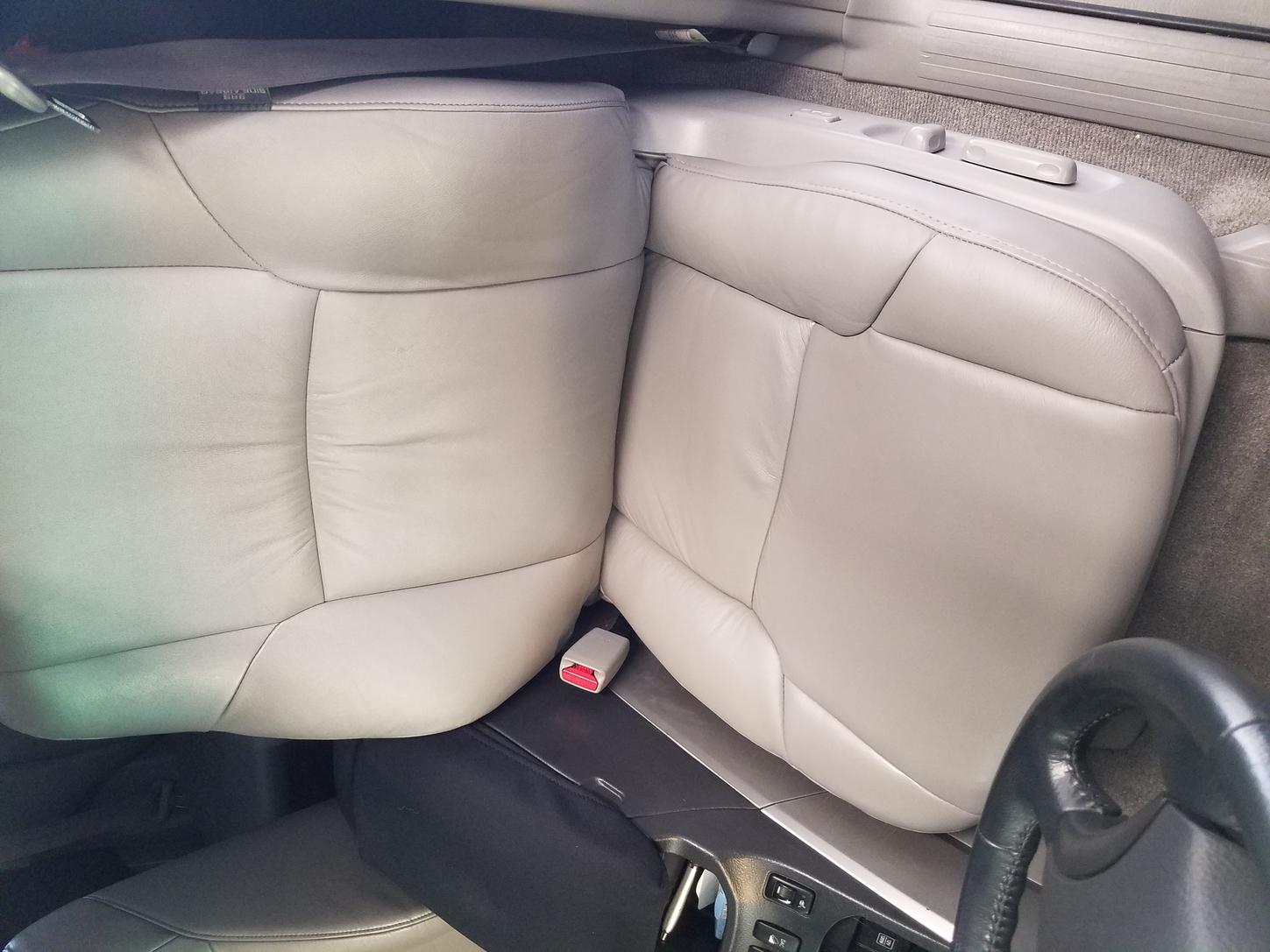

I stitched my cloth back together. Had a tear on the seat bottom door side bolster that was driving me bananas as well
I thought about it, or picking up one of the patch kits. This was $180 and gets very good reviews so figured would try it out. Glad I did, fit well and looks exactly like OEM
