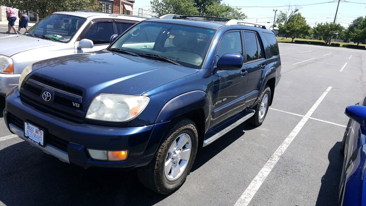

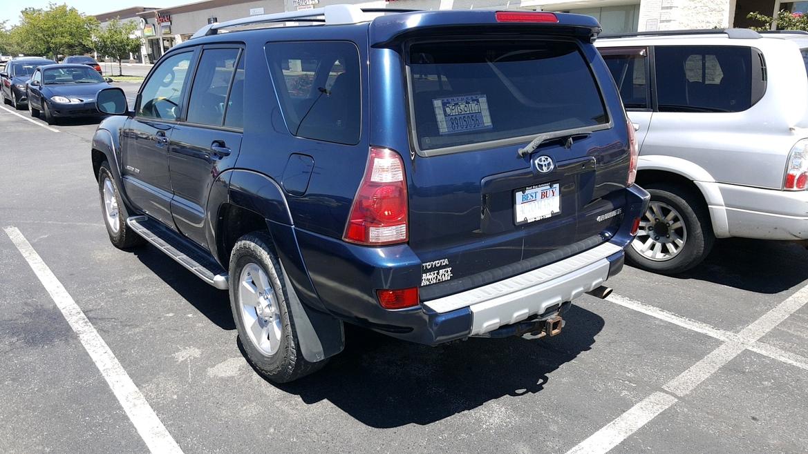

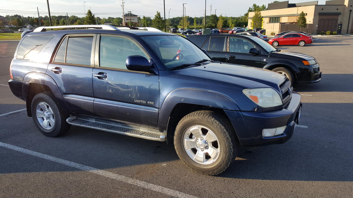

Bought this 2004 Limited 4runner.
As far as I can tell.it is stock. 171k miles.

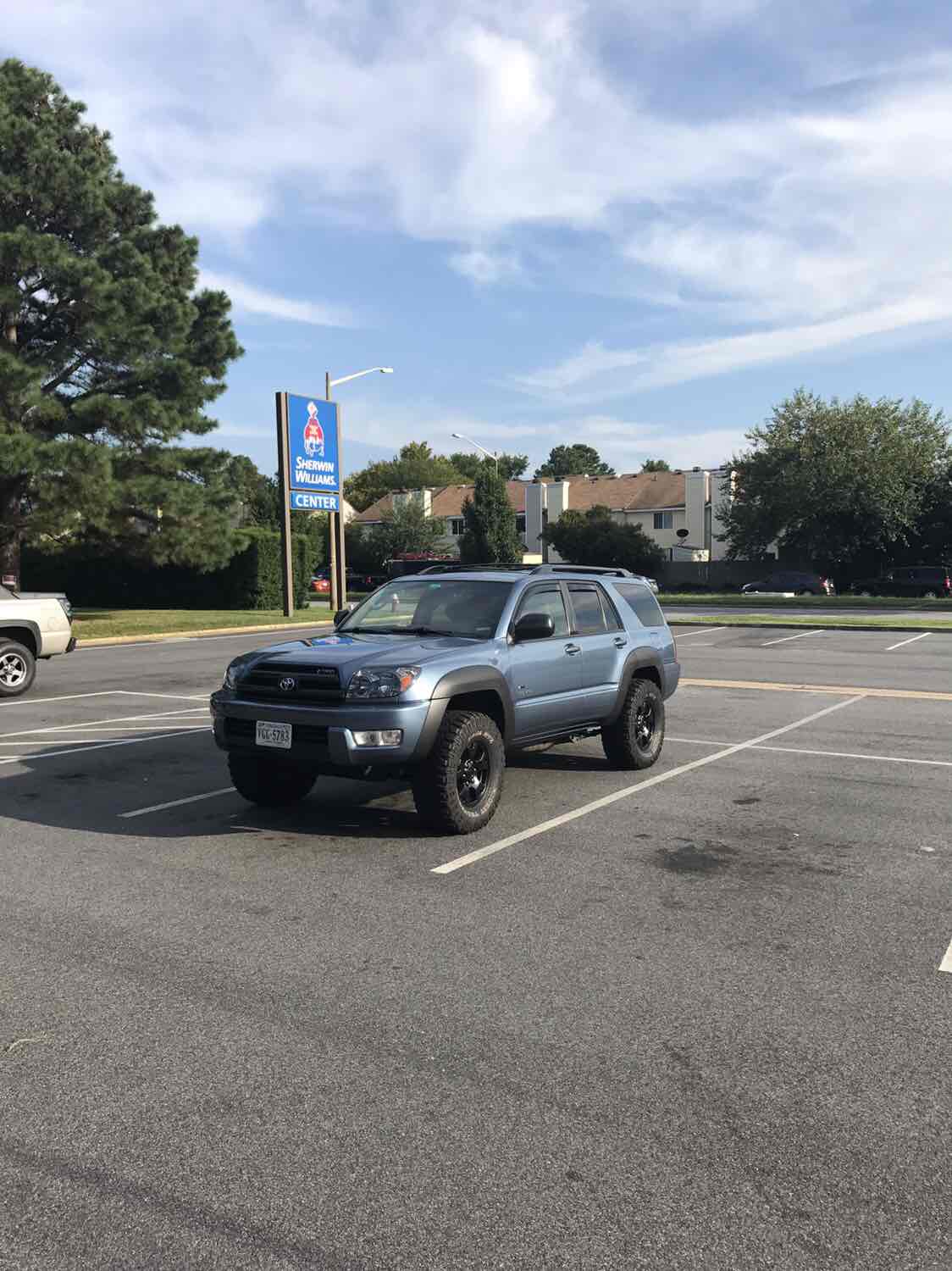

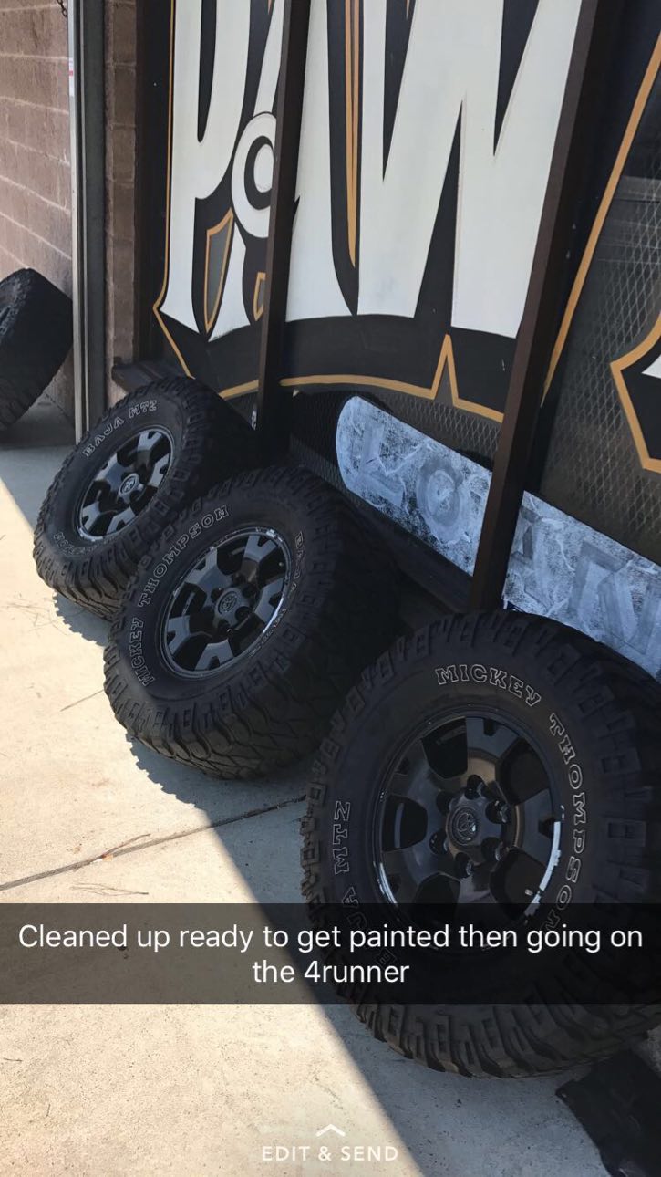

Found some Mickey T tires on 16in Tacoma rims for $350 on Craigslist and after about 2 hours of cleaning up and painting put them on the 4runner and I'm completely satisfied with the result. About to put 2in wheel spacers I'm getting from the same guy since it rubs on the UCA and I'm not about to trim them up. Hopefully the spacers will solve the issue

Looks great!

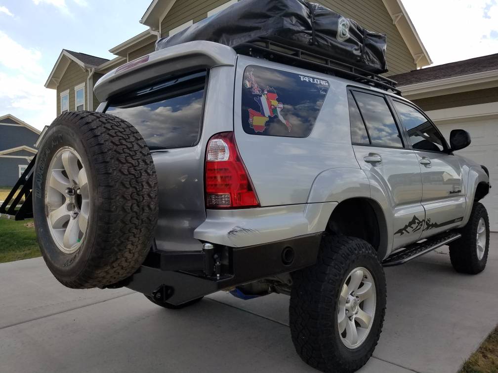

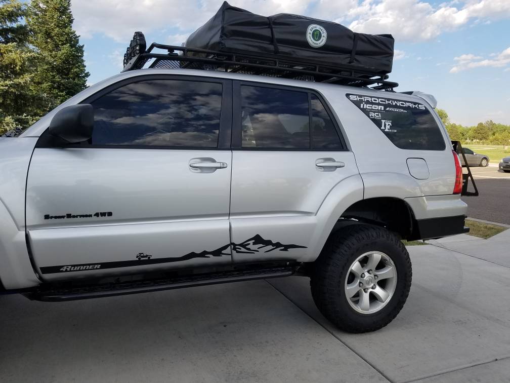

I Printed and placed new decals
New looks top and bottom

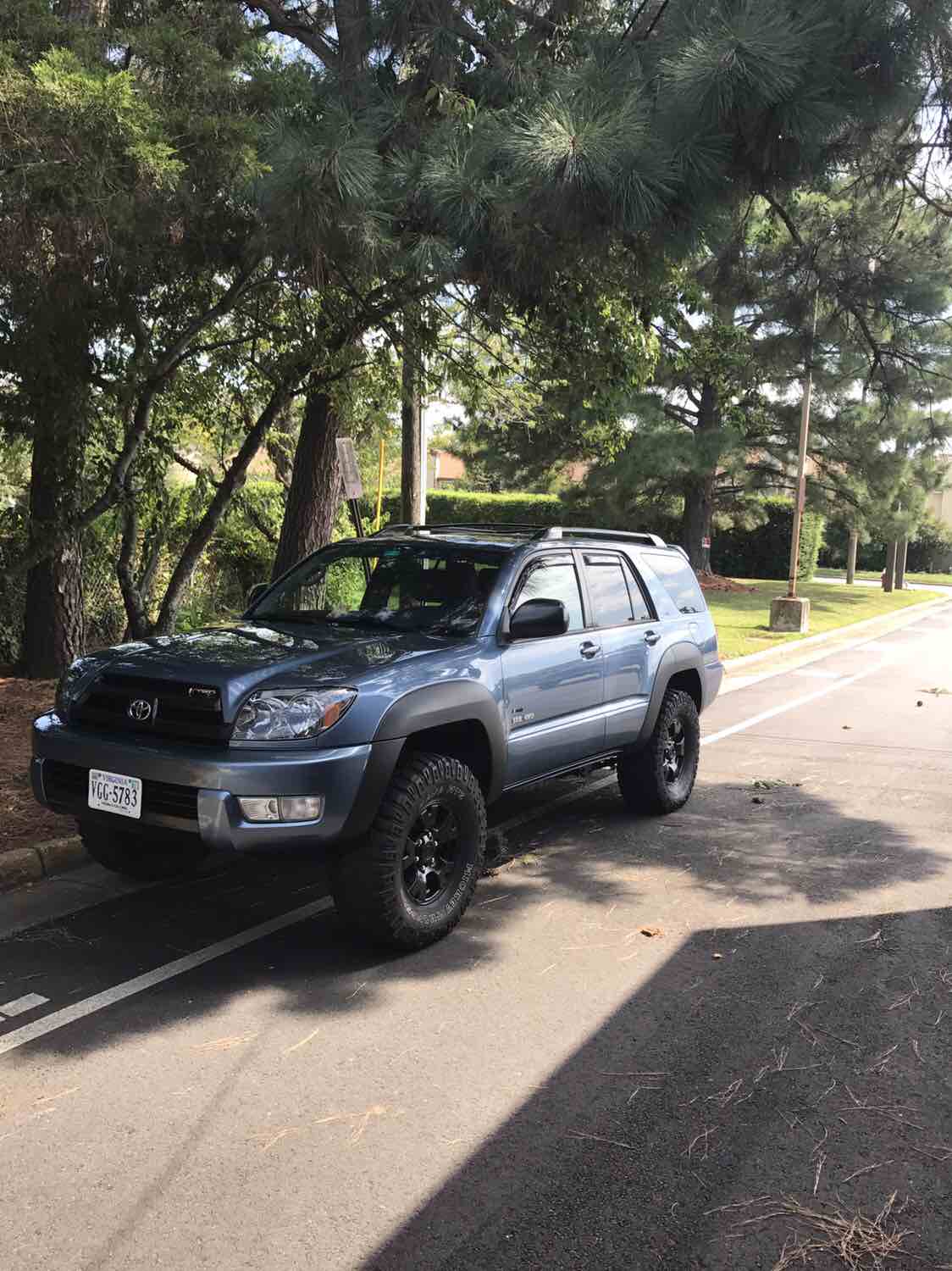

Update on yesterday's post:
Added 2in wheel spacers and solved the UCA problem, however there was some serious rubbing issues. Took a grinder to the fender edges and took out the fender well liner and it fixed my issues completely. Can't believe I got 305/70/R16s to fit on it with minimal work
