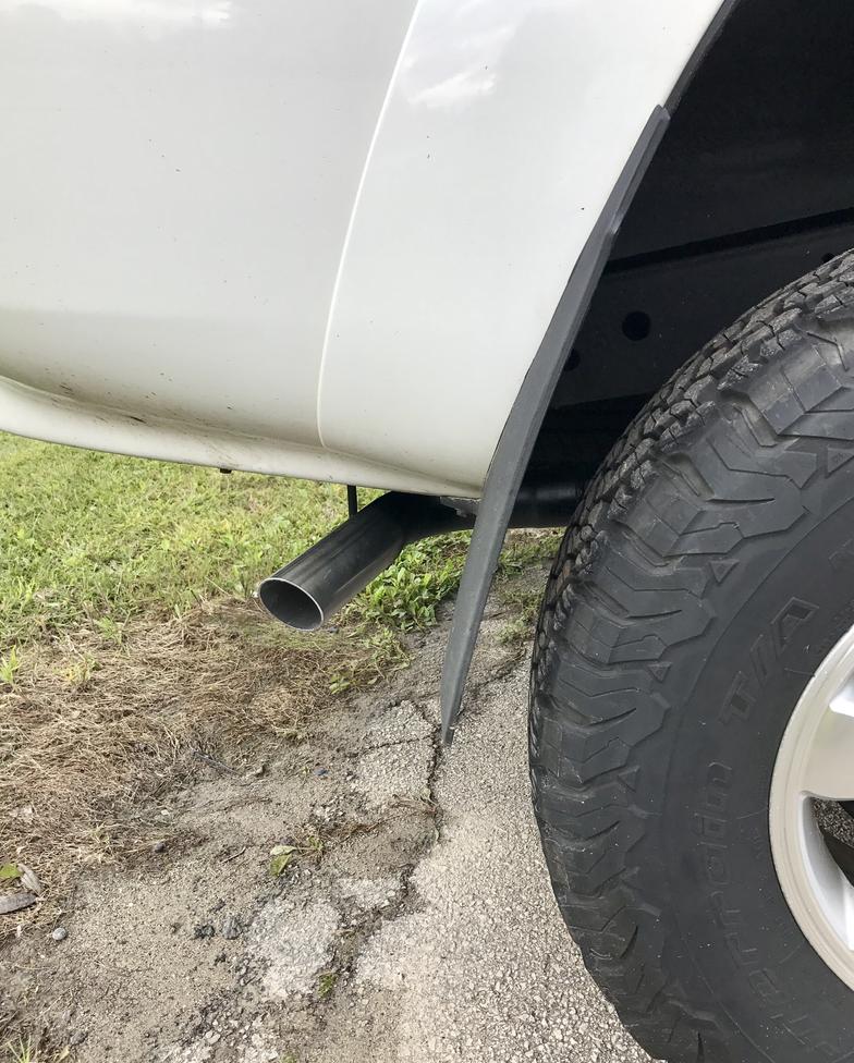

New tailpipe.
Resonator delete.
Routed behind the tire.

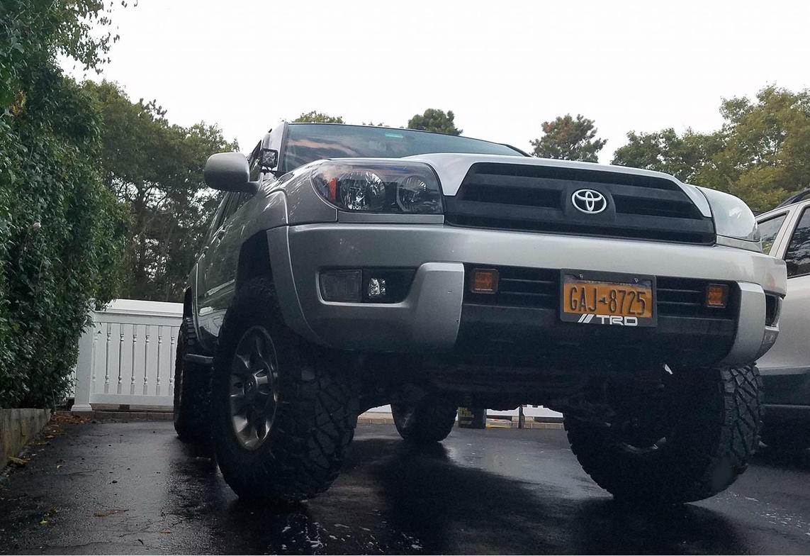

285/75/17 c load Nitto Ridge Grapplers on FJ wheels.. installed!

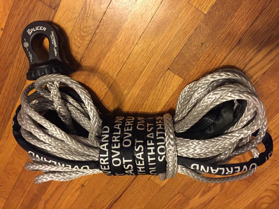

Got my 3/8" synthetic winch line from southeast overland in the mail today.
Amsteel Blue 3/8" grey 19600 lbs with Factor55 Splicer and rubber isolator

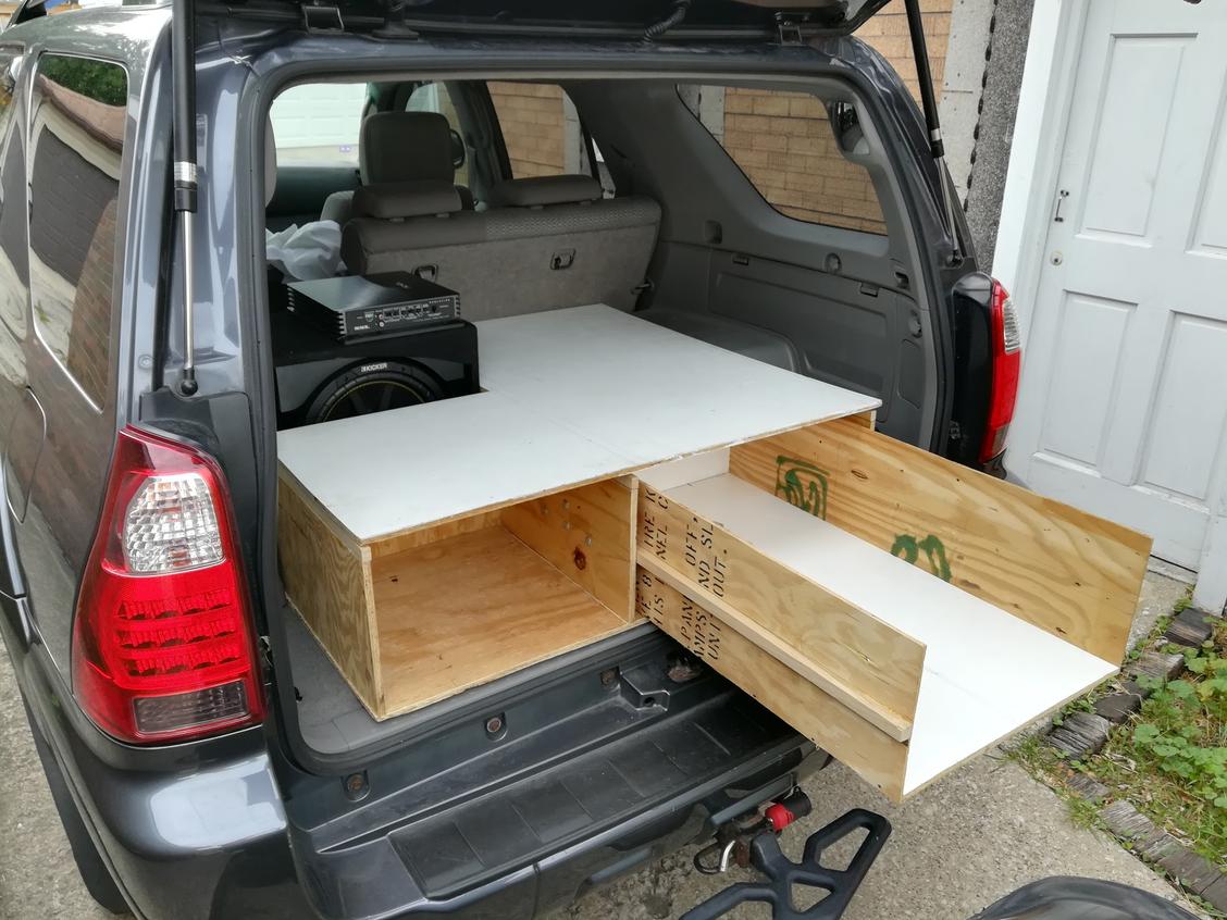

Test fitted the DIY drawer system...so far so good!

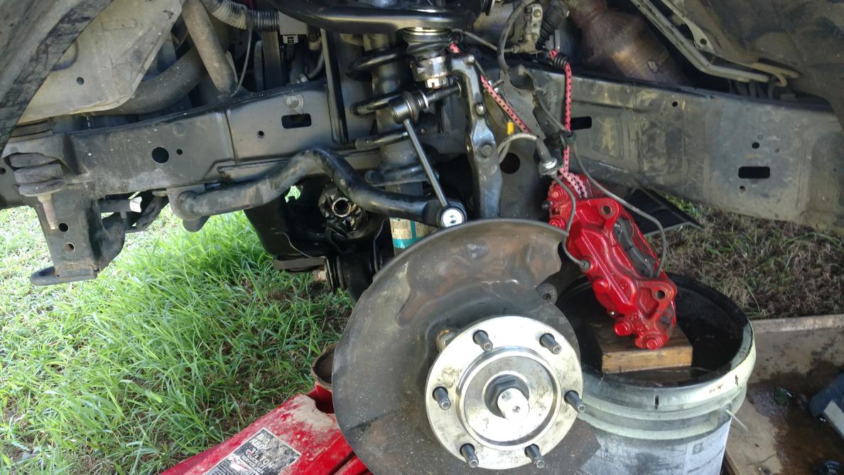

New lower ball joints. Pain the the ass. In the past I have used a real press. I don't have one at home though so did it with the C clamp type. It works, but makes a 45 minute job 3 hours. Oh well, hopefully never again.
For anyone wondering, the Moog LCA ball joints work great, seem well made, and are manufactured in the USA. $27 each vs $360 from Toyota.
