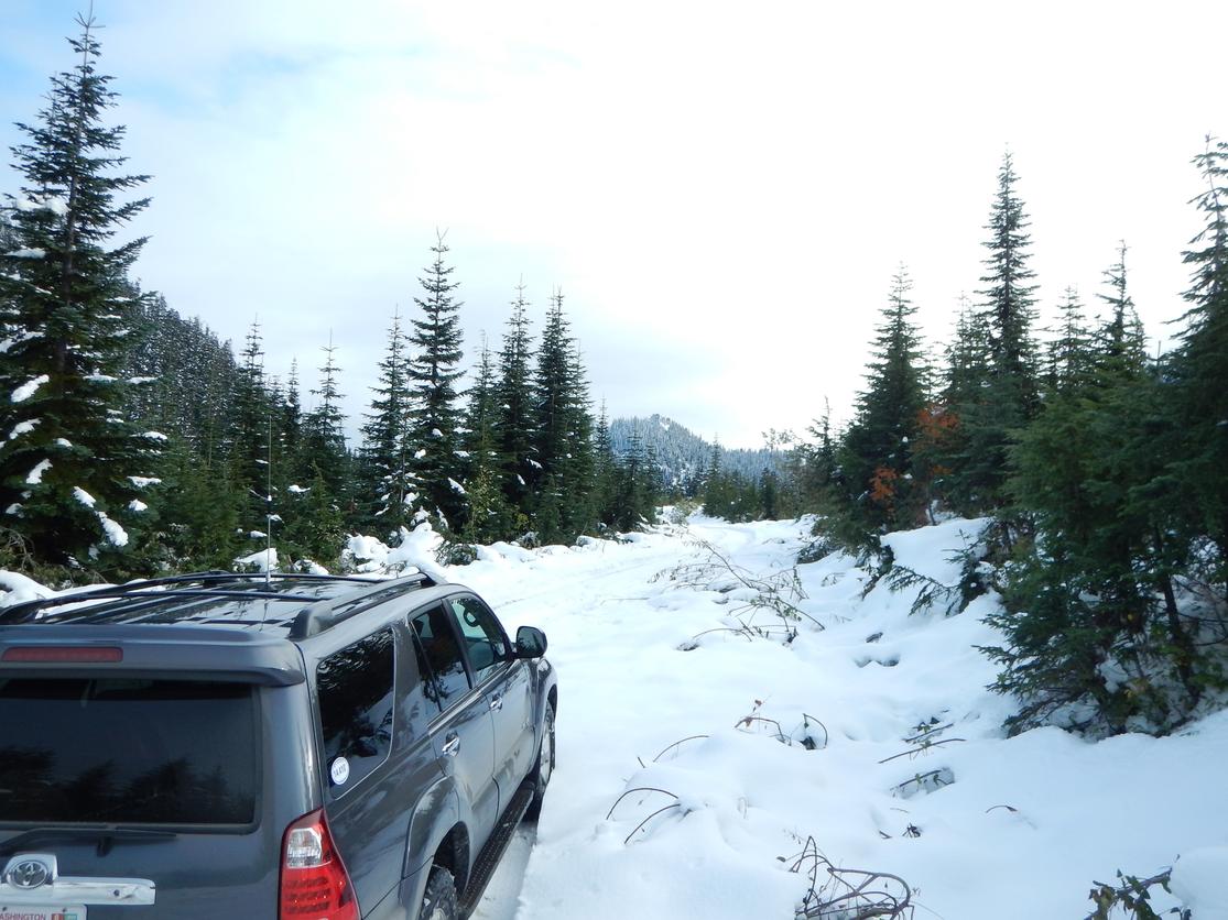

Took it up the dirt roads around Snoqualmie Pass east of Seattle. Didn't think it would be this much snow up there!

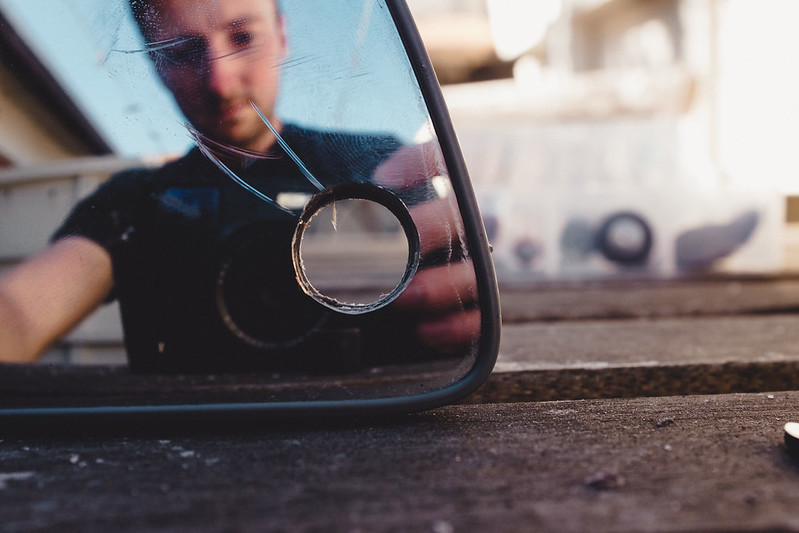

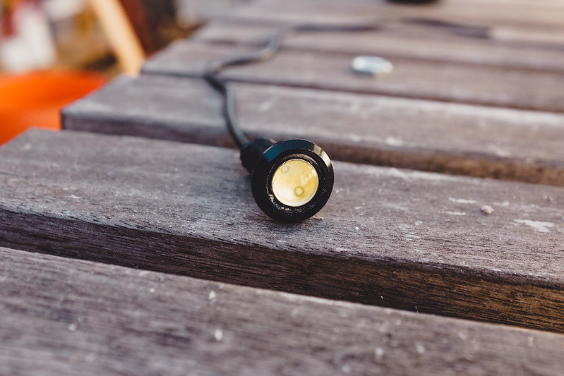

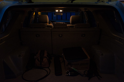

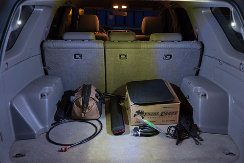

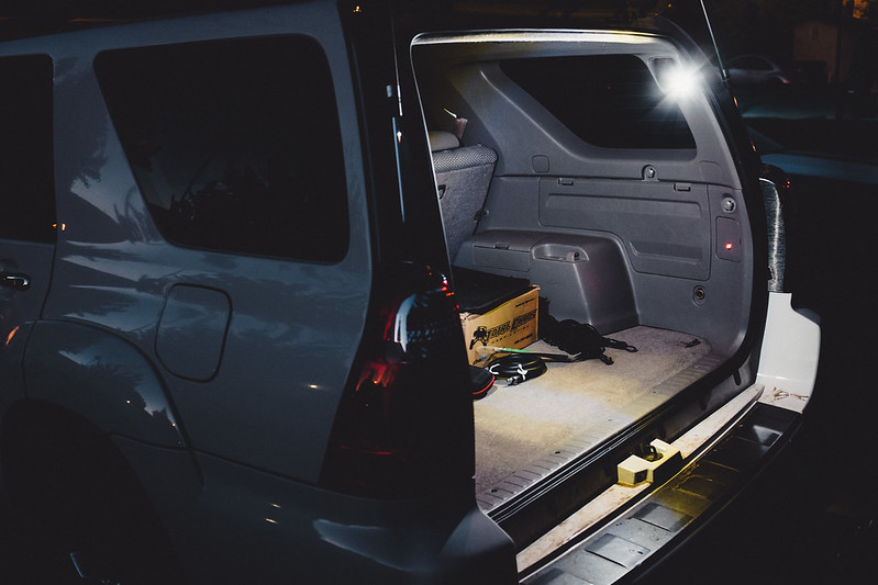

I've been wanting more lighting in my cargo area for camping trips, or anytime I need to do anything in the back at night. I didn't want to just put a LED bulb in the dome light, as I like all the dome lights to match, and I'm not a fan of LED's throughout the car. This all cost $22, and if I ever want to return it to original form, the 3 parts that i drilled can easily be acquired at a junkyard.

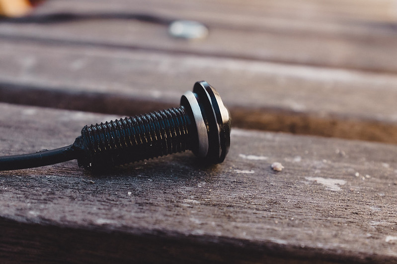

So, I got these bulbs on Amazon. $12 for 10 of them. They did come with a weird double flange deal, so I quickly removed that with a grinder.

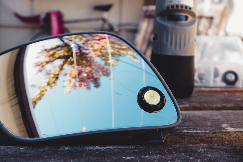

Next, I drilled out the mirrors that live in the rear pillars. A drill to start with, and them a Dremel tool to finish up.
Next was to mount a switch. Since these lights pull very little power, I spliced into the 12V outlet in the cargo area. I got this switch for $10.
After the switch, it was just a matter of running wires to everything. I used plugs so it'll be easy to remove for whatever reason in the future. Here is the final result. These photos below were taken with the same camera setting, so its easy to see how big of a difference they make.
