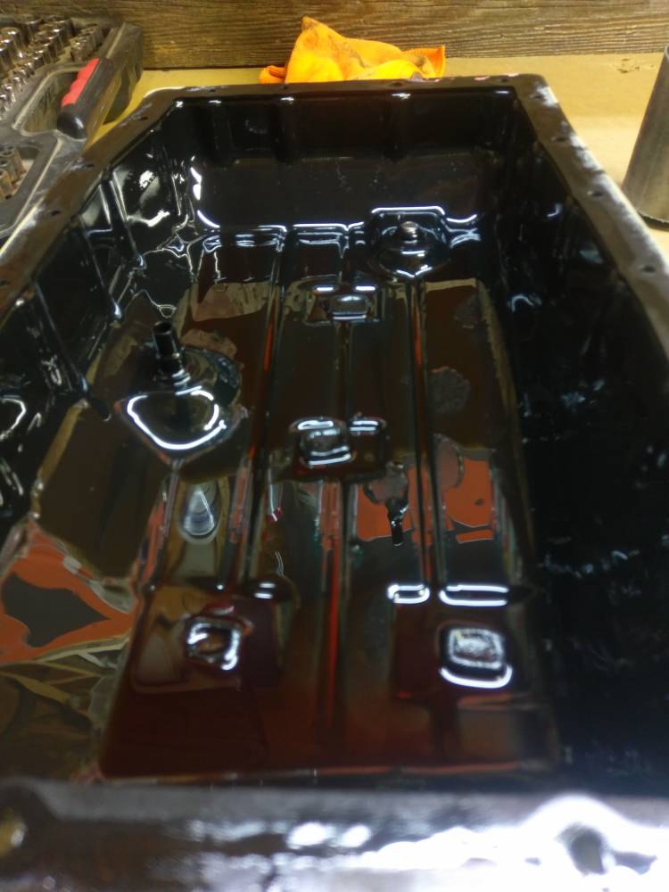

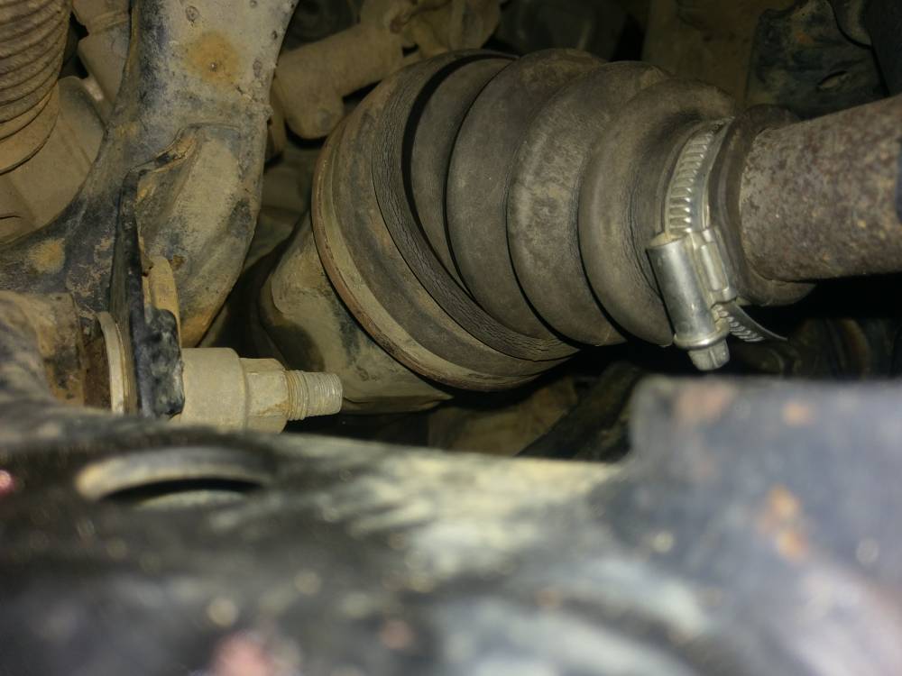

Not today but this week I did a major inspection of all suspension drive train and brakes. Most of the stuff that was replaced 50k miles ago is due for some attention. Wheel bearings good, driveshaft greased and good, upper and lower ball joints greased and good, upper control arm bushings may need to be pulled to be greased or just replaced. No calipers seized but the rear brake pads are gone and the fronts have a ton left? Maybe atrac eats rear brakes? Sway bar bushings and links shot, rear is staying off, front is getting new poly sway bushings and warranty the crappy moog links for now, getting better stuff next time around. Also needs new moog tie rod end driver side warrantied, and leaking driver front diff seal. CV boots not torn but getting hard and looking cracked ordered OEM to replace the beck arnleys there. Then I did a drain and fill on the trans, actually dropped the pan and changed filter and cleaned magnets. All looked good in there but fluid was barely red anymore even though I did the 12qt exchange 37k miles ago? It took 5 qts to top it back off. I'll plan on doing a drain and fill every 25k miles now I think to keep the fluid cleaner. All diffs oil looked clean and new and at level still even after all the water crossings this summer! I also measured to get material to make a custom rear bump stop drop with wheelers superbumps in prep for fitting bigger tires stuffed and not tearing my rear doors off, I think I could have used them before anyway. If you're still reading this you're a trooper, this is really just for my own documentation. :wave:
