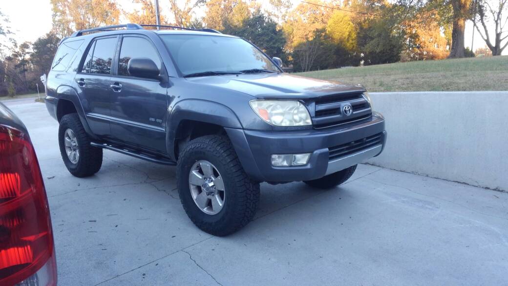

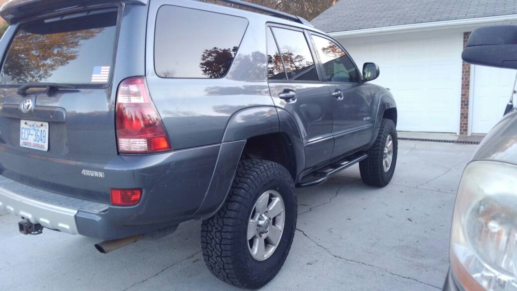

More pics. Had to trim the front bumper and looks like I need to trim a little more off the body mount.
Falkens?
Nice! I regret going with the smaller 285/70
You flexed it to bump stop yet? Curious how much it hits the top of the fender
Not yet just put them on yesterday afternoon. I was running 255/80r17s before this so I've already done some decent trimming but I can already see some other areas that need some more. Once I get some more figured out I will try and add it to my build thread.

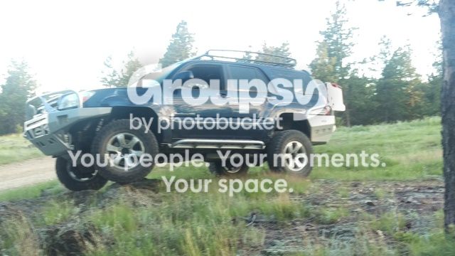

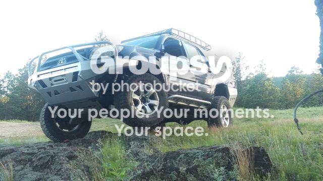

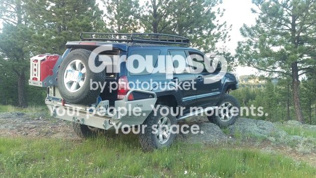

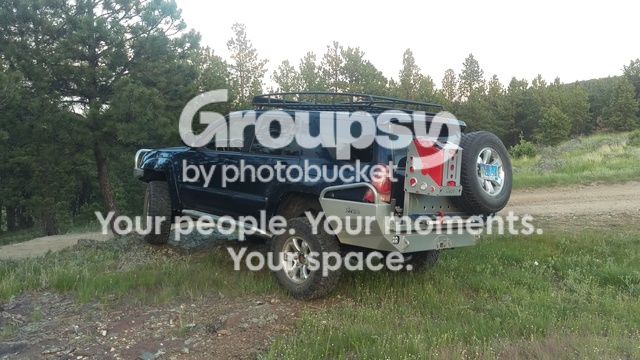

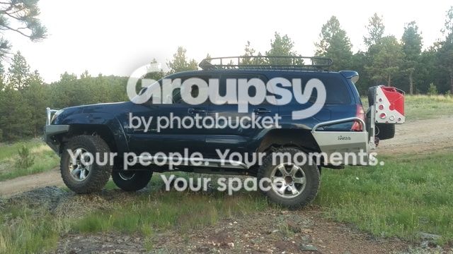

Went on a short ride in the Black Hills to let the new C4Fab bumpers and sliders get some fresh air. Not quite ready for the real trails yet so I took a few poser shots-

Wow! Really nice armor setup! I'm going to send you a pm about that rear bumper. Solid looking rig buddy!

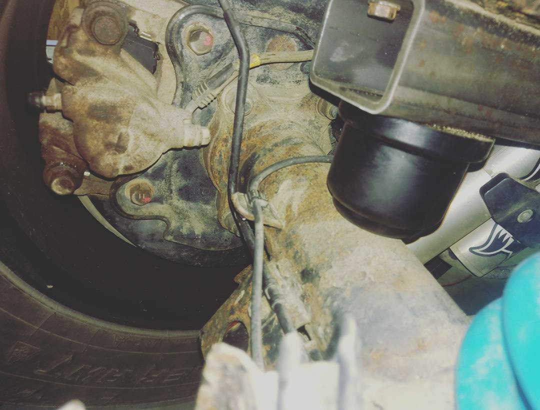

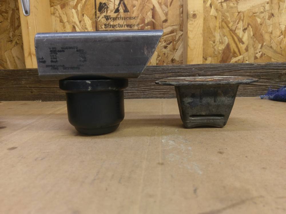

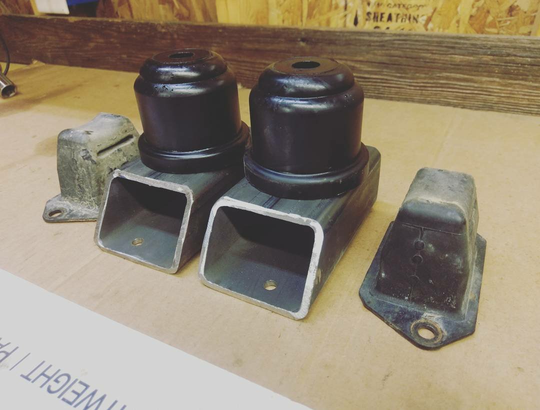

Made some bump stop drop brackets for my rear wheelers superbumps. I love them in the front but realized I was no where near touching the stock bumps or wheelers if I just added their rear kit so I saved a couple bucks and made some. 2"x3" tube fits well in the space, offset the bump about 1/2" rearward to center on the axle. I might need to add some small shims later on to keep tire out of the body work that I dont trim but hopefully this is all the uptravel I need to give up.
