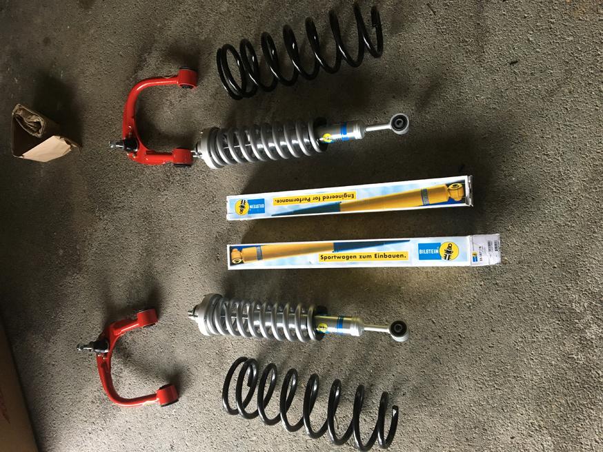

Lift kit showed up today!
It’s blistein 5100s all around with superflex hd rear springs and ebiach 620 fronts
Jba upper control arms
Not pictured is 2 1/2” top plate spacers and 1 1/4 inch spacer to level the lean
Sway bar relocate and differential drop from wheelers as well as 2” longer top plate studs
I’m trying to decide whether the 1/4” spacer will be really necessary or not

I have essentially the same set-up, I didn't use the rear spacer and there is no noticeable lean.

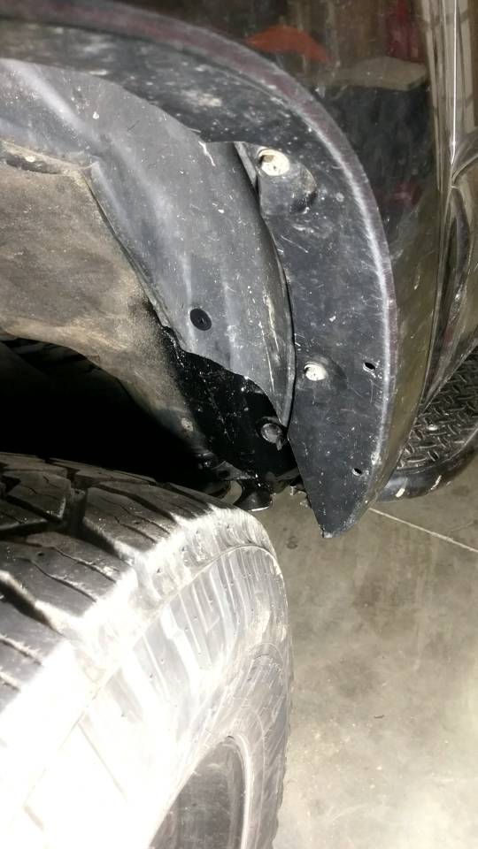

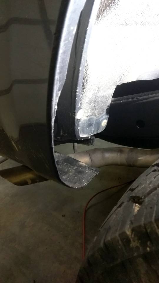

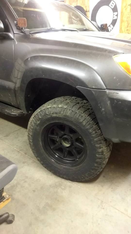

Got the clips to put front flares back on from Amazon. Had to epoxy a couple mounting points back solid. Finished the next round of trimming front and rear. Time to mount the tires!

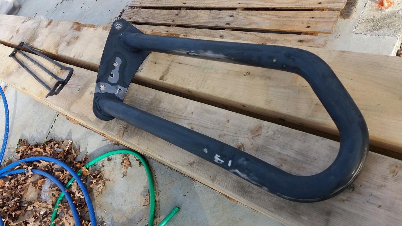

Took off the brush guard and started sanding off the last persons bad paint job. Started first coat poorly so I'll sand it again tomorrow.

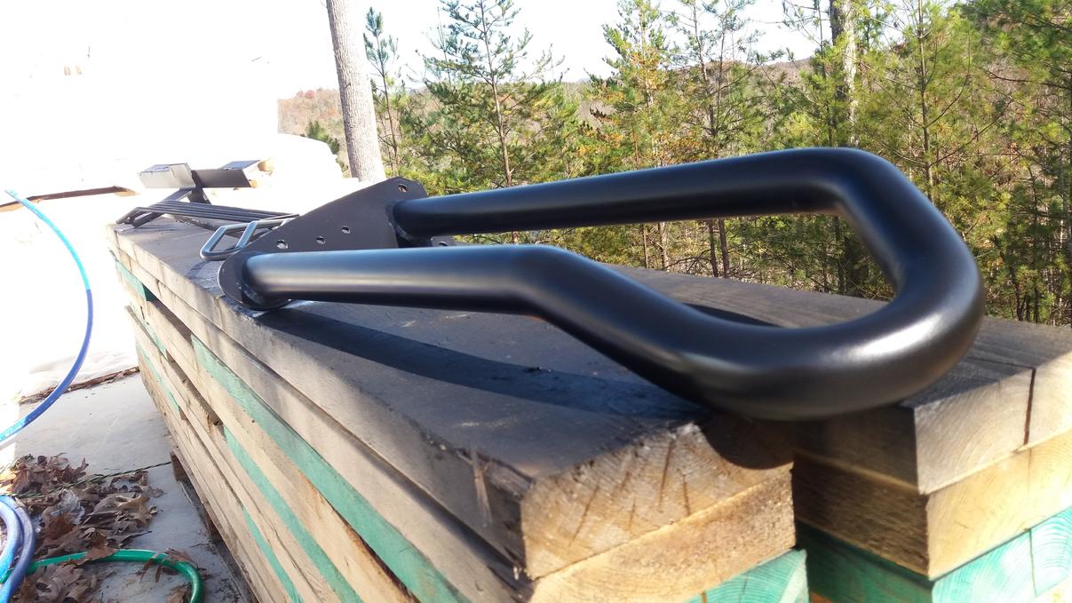

Much better on my second try. Ran out of paint, but so far so good. Worked so much better in the sun today with really light coats. Satin black rattlecan.

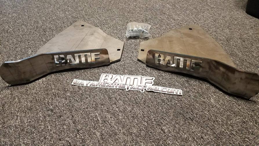

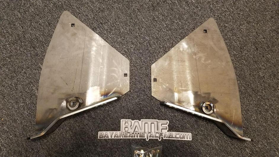

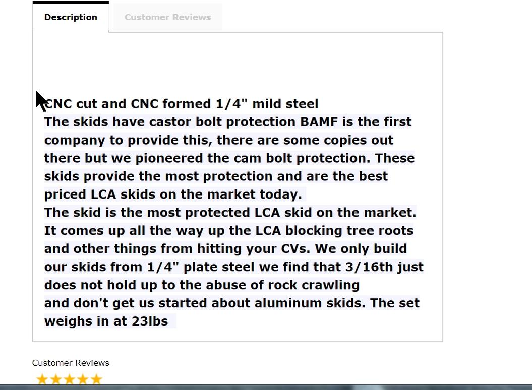

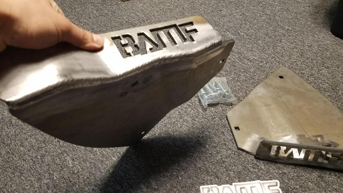

got some new armor in yesterday!
