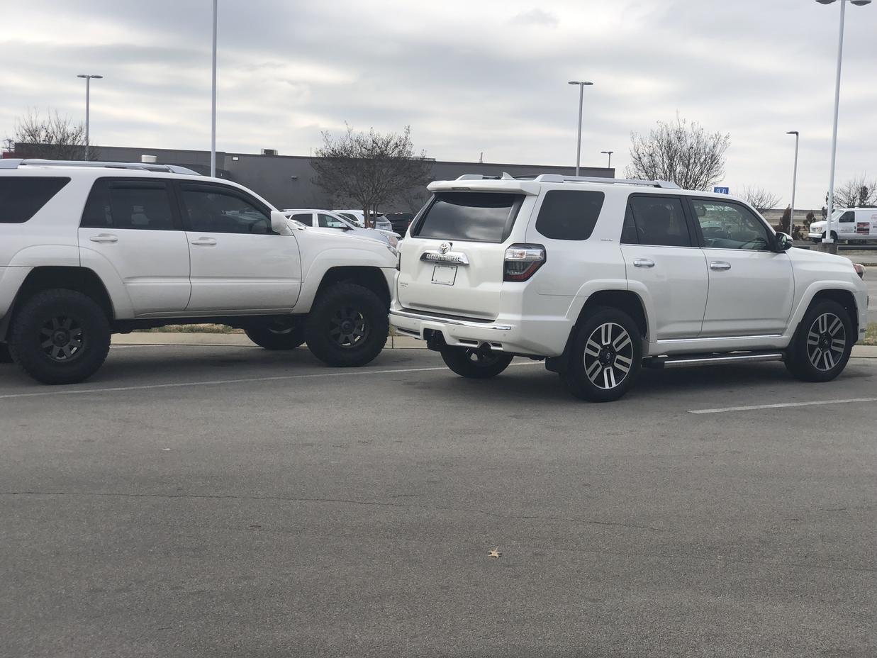

Finally got tired enough of the black to do dip my wheels again, PD Copper Metalizer. Only did 2 coats (after 5 black) and really liked the color (dark bronze) but wanted a little more pop and went too far. Oh well. Can always hit it with another coat of black and metalizer again before peeling.
Trading in wife’s Santa Fe tomorrow!! Will have the 04 and a 2014 white 4runners! Limited has the redwood interior, saw it and had to have it!

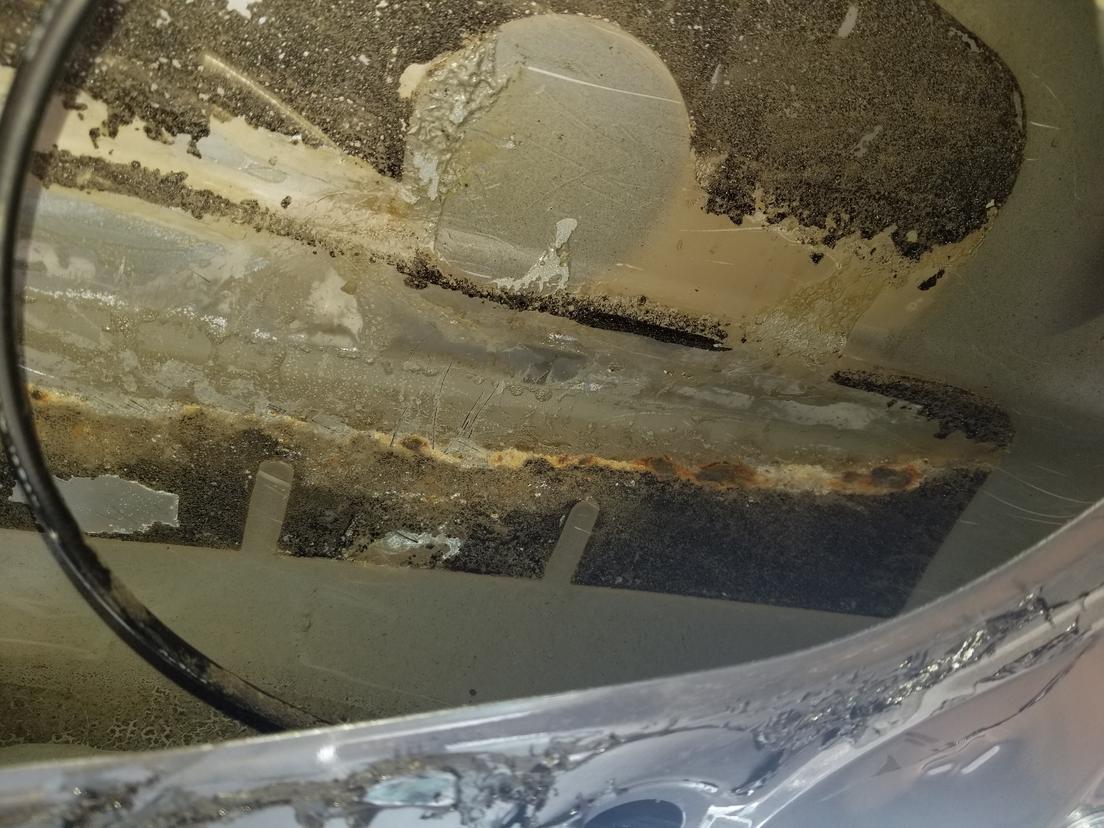

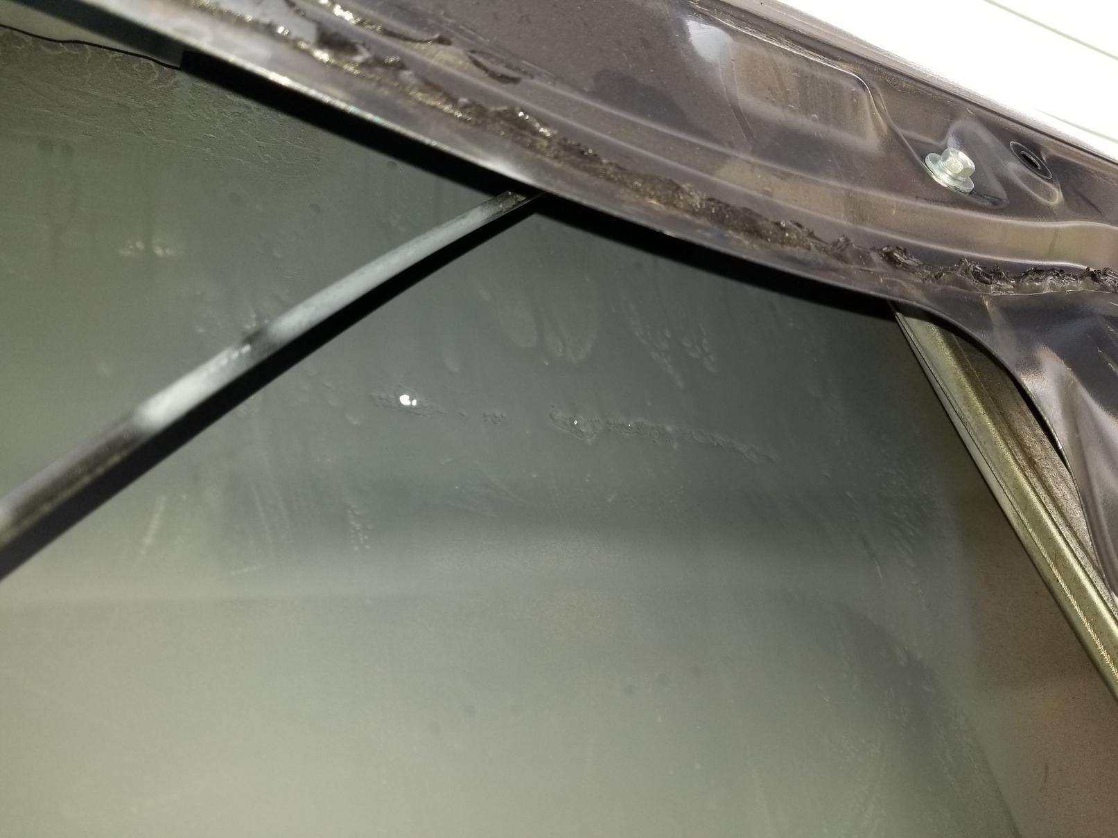

There has been a super small rust spot on my rear hatch, today decided to see the root cause, if it's just under the paint from a chip or worse.
This is a west coast car, in Portland, OR, no salted roads, waxed monthly and never in a wreck. I found the sound deading has been holding water and has caused it to rust out from the inside out. I sanded everything down to bare metal and painted with rust converting paint. I had a quote to fix it when we thought it was just a paint chip for $800. Scared to see what the quote to fix it since there is rusted through all the way now :-(
