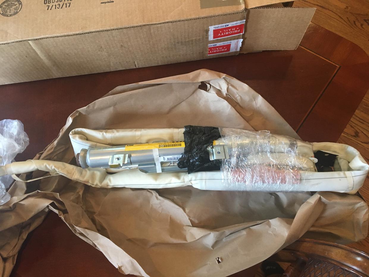

Just recieved my passenger curtain airbag in the mail. Will have it professionally installed as I am hesitant to install such a thing on my own. Purchased the rig off an insurance auction and this is the first step into making it into its former glory.

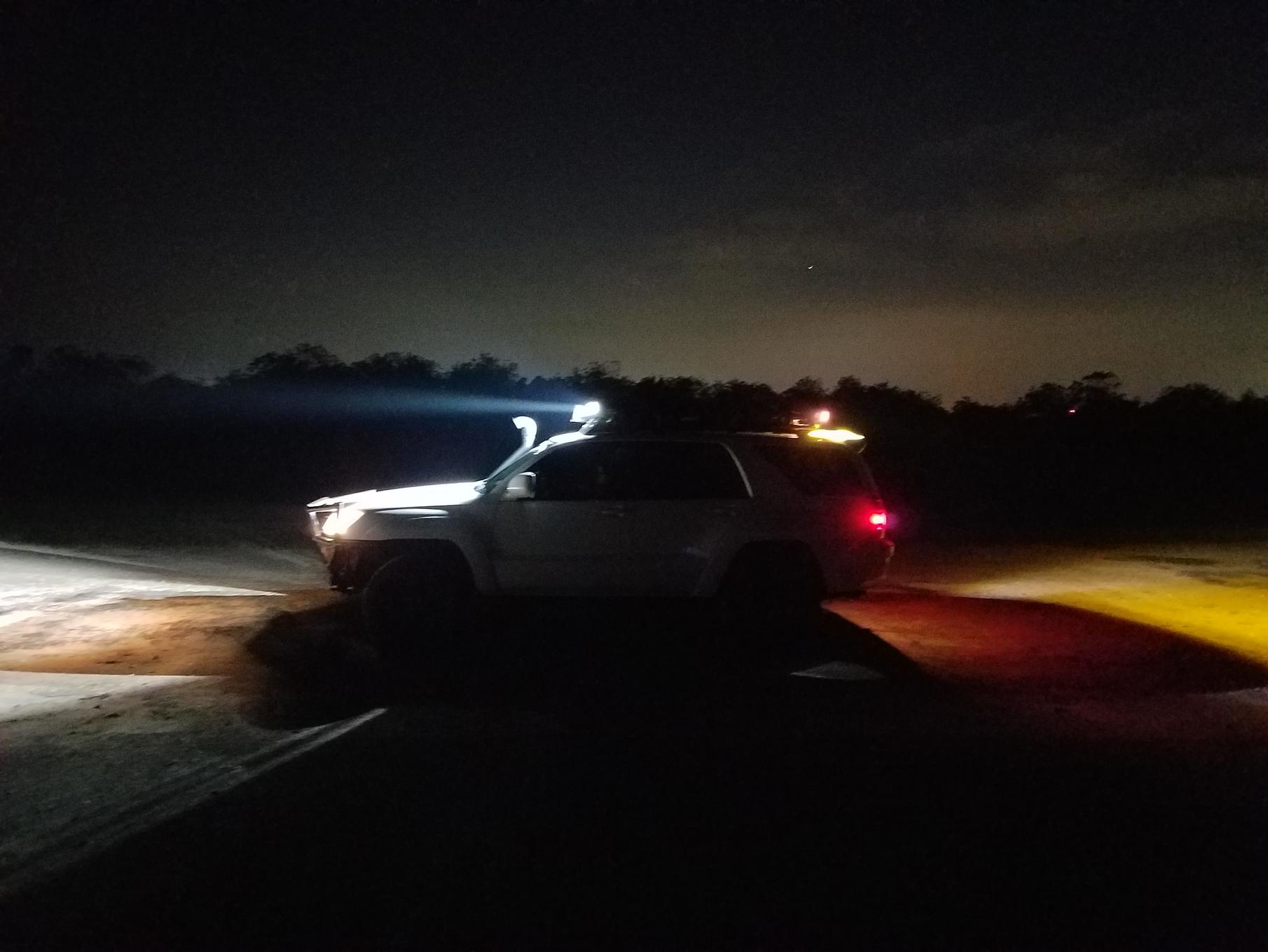

Before leaving for Florida i installed a super slim 14” light bar on one of my swingouts for more reverse lighting. It will eventually be wired where i can turn it on at will but for now it just comes on when in reverse. Very pleased with the output.
Stealthy!
That's awesome Morris. I really want to to do the same/similar. Did you just splice it into the reverse light itself or . . . ?

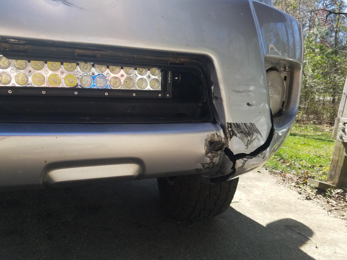

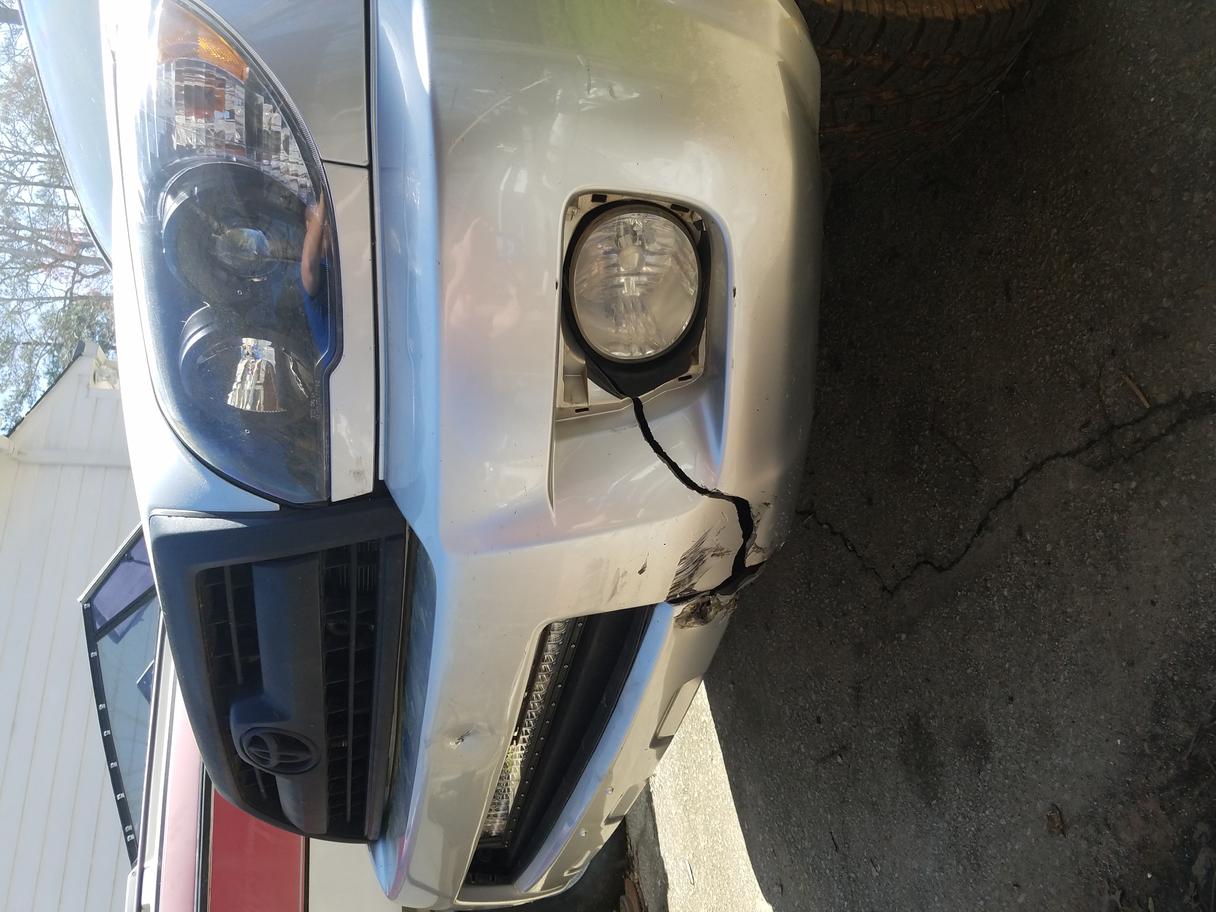

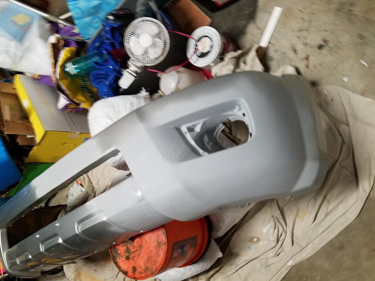

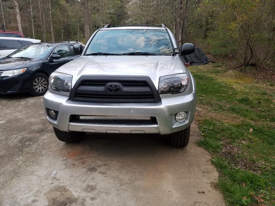

Bumper cover repair
I got in a fender bender a few weeks ago and I finally had the time this weekend to fix it. I decided to repair it rather than replace because I plan on getting a Low pro steel bumper in the near future and didn't see the point to get a new cover just to cut it.
I used a Dremel, JB Weld plastic bonder, drywall tape, 40/80/320 sandpaper, bondo, primer and duplicolor perfect match. I honestly would have taken me one day, but I have National Guard drill over the weekend so I worked on it when I got home. I should have taken alot more picture of the process, but I just wanted to get it done.

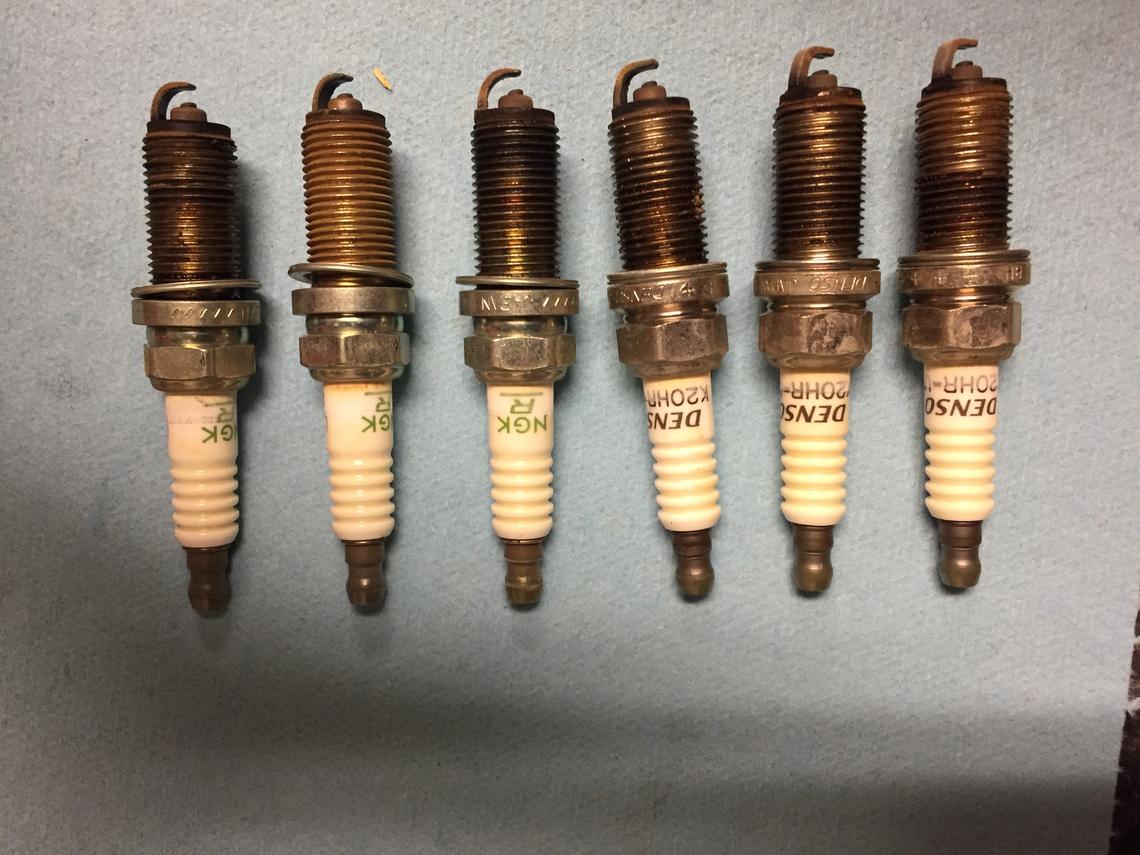

Spark Plug Replacement
I decided to replace the spark plugs because I wasn't sure if the PO had done so and there were no records. I'm glad I did! These suckers look like they are from the factory. If that's the case, they are 172k miles old. They were gapped at the time of removal .07... Almost double spec.

Not likely with 2 different brands in there or were you JK. Anyway, they were due......

Actually,I know its super weird, but Toyota did that at the factory pretty often, used NGK on one bank and Denso on the other bank. No clue why. When you buy new plugs at the dealer they will give you all 8 the same brand. The fact that there is 2 different ones makes it more evident that those are the original plugs.
