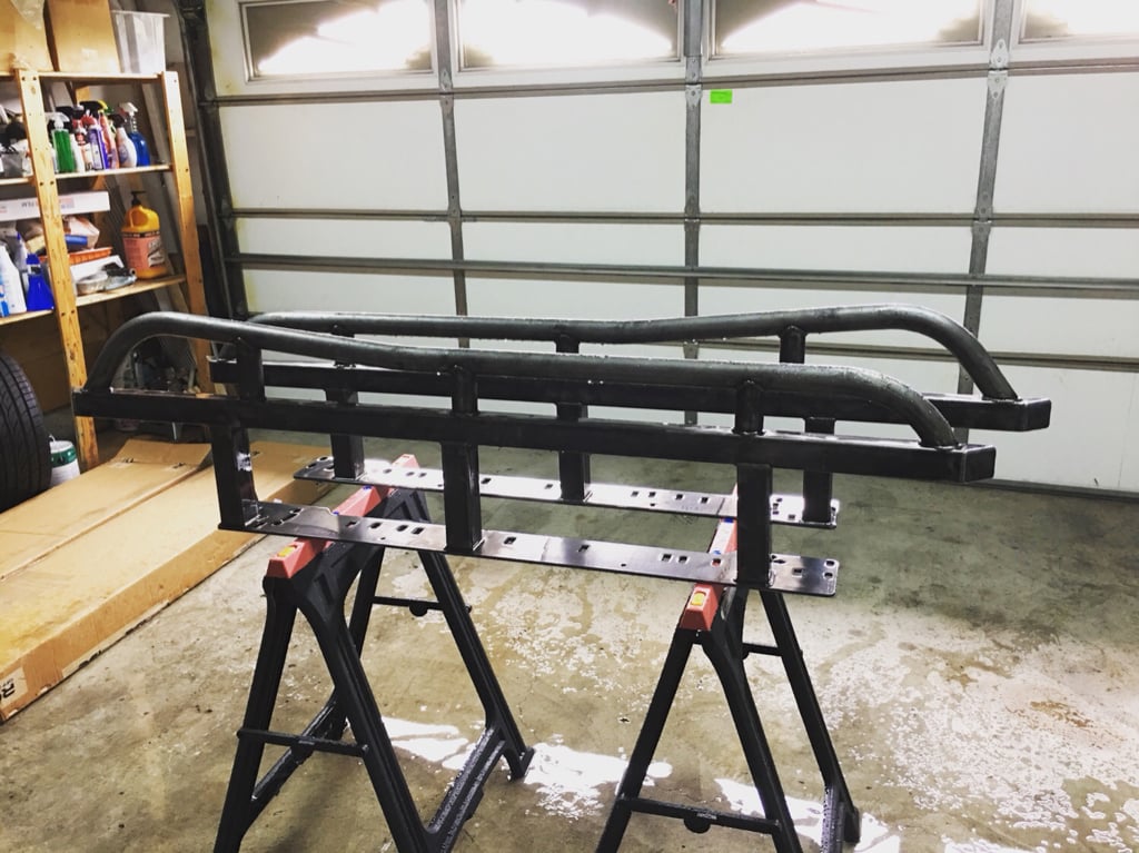

$715.50--they did 10% off at the Jamboree and no tax plus no shipping ($95) since I picked it up...ended up saving a total of about $175 vs if I had ordered online and had it sent here. My buddy bought a 5th gen so I had to go up there and pick his up--all the options they brought were standard setup with no lightbar cutout and black coating. His came with the 1x1" to clear his sharkfin which used to be a $30 upgrade so he saved a bit over $200
All in all total discount ended up being right around 20%

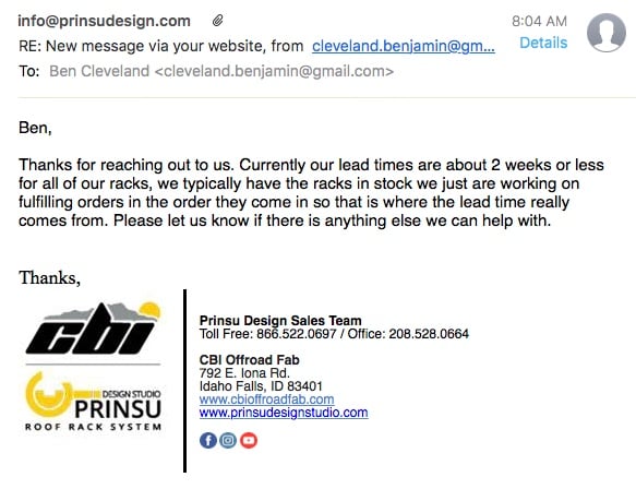

They are still selling racks. I had emailed Prinsu and CBI to confirm lead times about a week ago before I realized I could wait for the Jamboree to see if they had them in stock. All ordering is still done through the Prinsu website and they said lead times are 1-2 weeks (though it could be less). They had two of each rack at the Jamboree and sold about half--mainly the Tacoma ones though. They still had at least one of all the 4R options though so if you ordered soon it should be in stock right now.
I ordered a standard black one, no light bar cutout on 4/28 and my receipt shows 5/21 expected shipping.
That’s great to hear. As much as I like front runner and eezi awn k9, you cant beat a good solid rack for half the price of those.
Prob going to be placing my order in another month or so.
That's exactly what I have/what they had at the show and they left with one of them left in stock. Fingers crossed it ships sooner than that
That’s a response I got 2 days after emailing through their website.
Sounds great to me. And 2 days response time from a reach out to the info email on their website is pretty good. Seems like CBI is on top of things on their end.

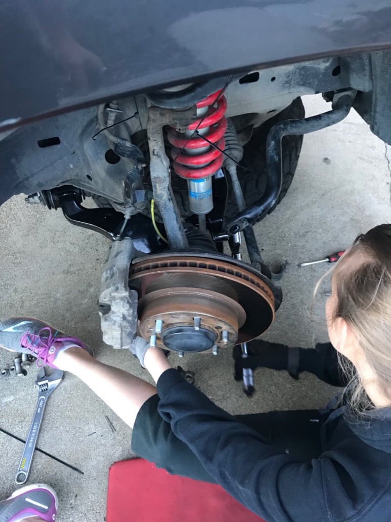

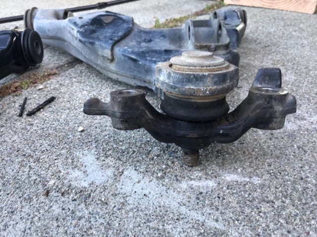

Wife bosses up and installed new LCA’s, inner/outer tie rods and sawy bar links with only a little help from my self! It wasn’t fun but wasn’t that hard either. With a torn rotator cuff I’m a little out of commission. Arb skids are next...
I received my all black no light bar rack 3 days before the projected ship date on my invoice....CBI’s shipping game is strong!
Did you go OEM on the LCAs or Moog?
