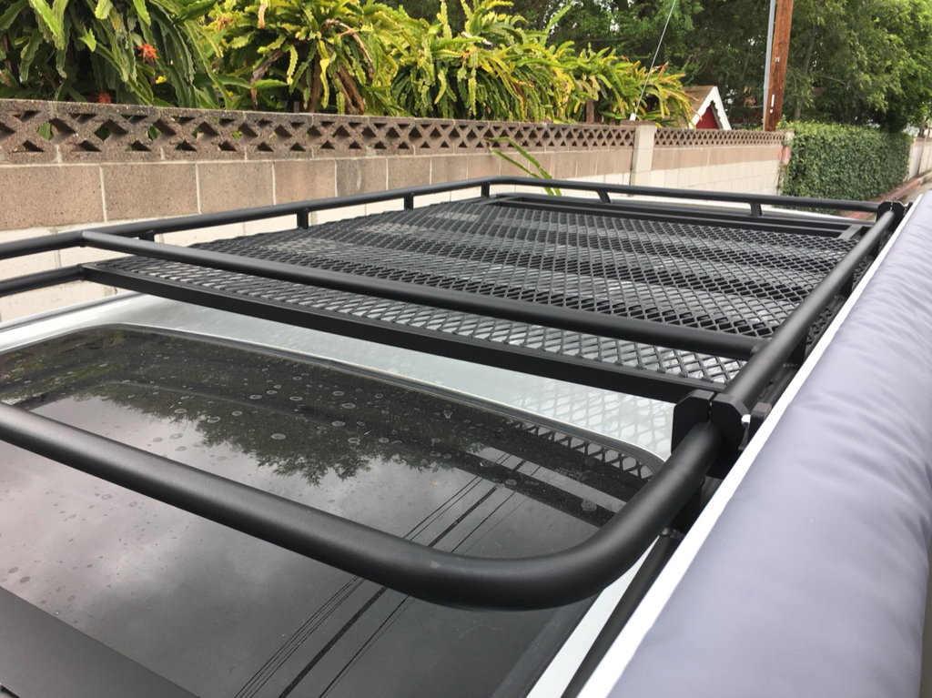

Got a text from a local fabricator that my rack was ready. Also installed my arb 2500 with gzilla mounts. I’m super happy with the results.

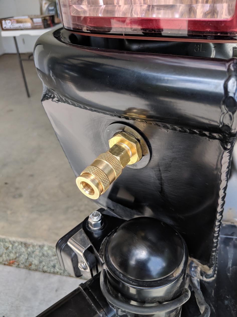

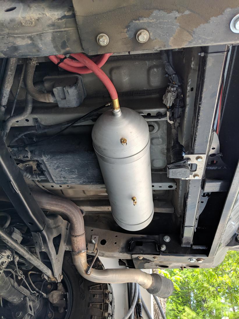

added a 3gallon air tank where the stock spare goes, hooked up to the arb compressor under the hood. Mounted a quick connect air chuck in the rear bumper.

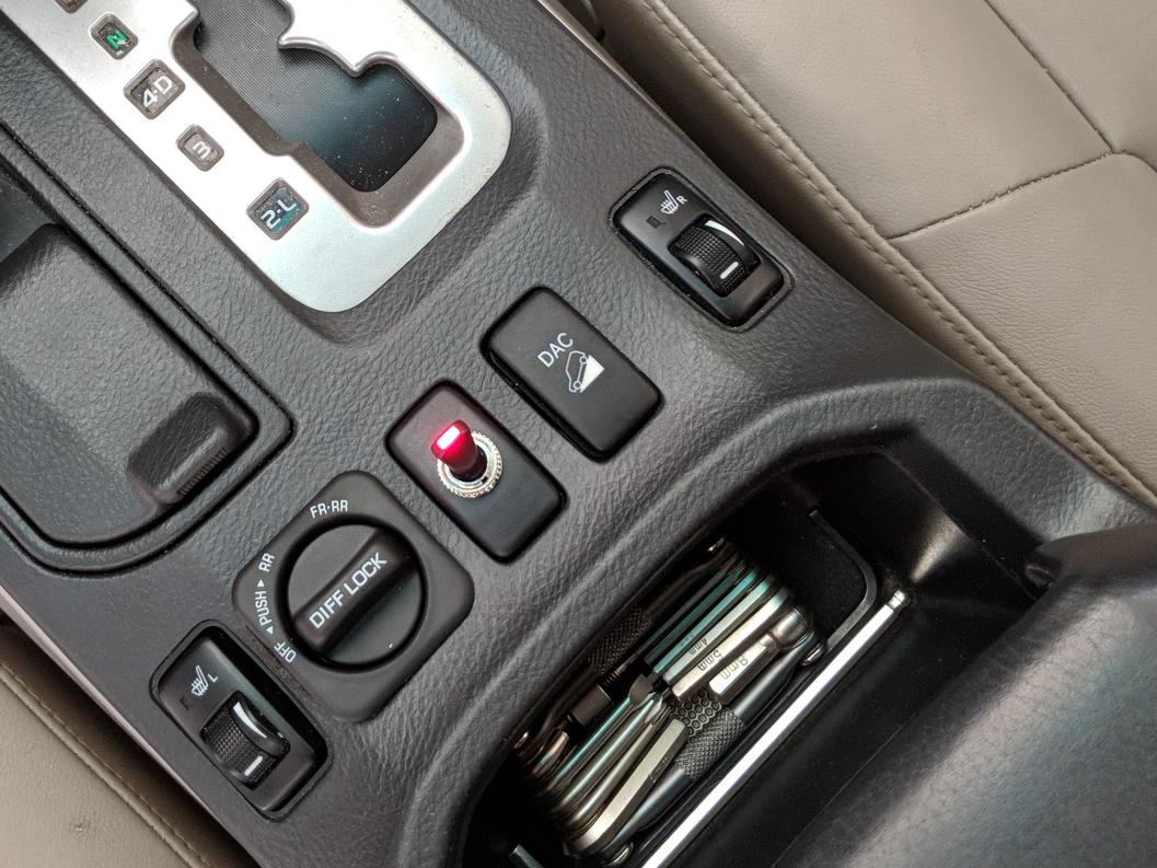

also added a diff lock actuator for the arb lockers from a land cruiser. the arb switches were just kind of big and ugly. took a bit of work with the dremel but it worked out ok.

I've been contemplating what to do with the space where my spare used to live, that tank looks good there. I may do something similar.
