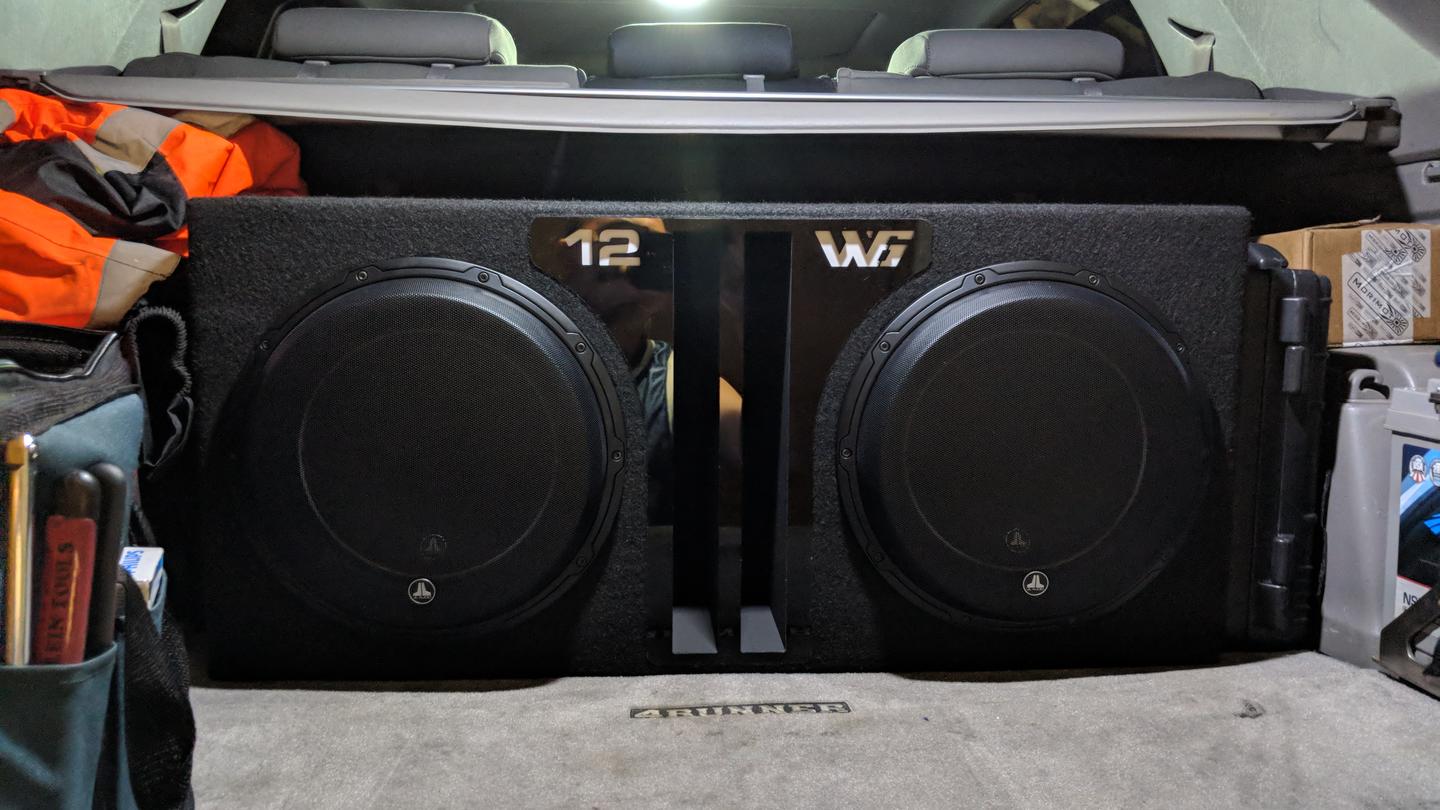

i know you must hate me since i went ported instead of sealed
added some grilles to the new woofers, now my subs are protected from surround rubs.

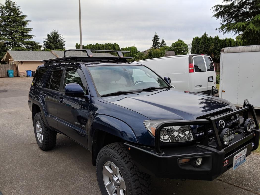

Would love to see more pics of the rack, what do you think of it? I know it's only been a day but first impressions?
Like it a lot so far, really solid. Its heavy, get a friend to help lift it.
The rear mounting holes for the base were an absolute PITA to get in though but now its all good. The washers they supplied did NOT fit down inside the foot, I had to file them flat on either side to get them to fit. And there was a shit ton of dried Loctite on the bolts that had to come off, messed up one of the mounting hole in the roof, glad I had a tap to clean it up.
Only a little wind noise at freeway speeds, I'll fix that some day but not that bad.
I also was able to modify my old Yakima spare tire mount to fit as well, so bonus there. A couple of new holes for the mounting bolts and 4 steel clamps from Lowes.
And the sun roof pops open just fine too, just clears the bolts.

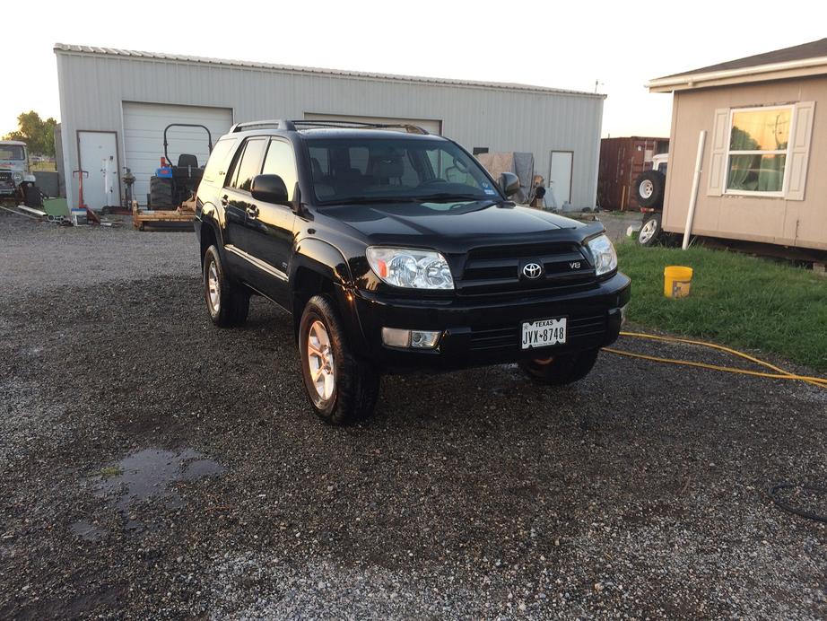

I gave my 4runner a wash today after installing my weathertech bug deflector.

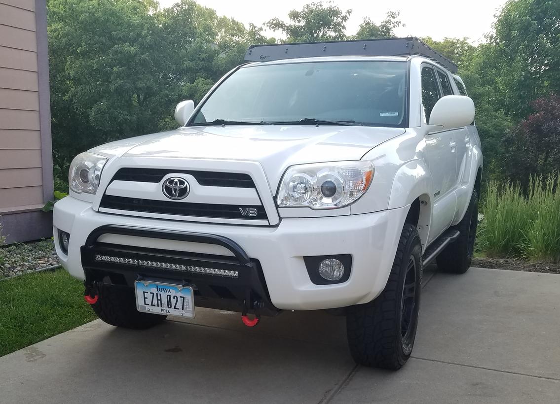

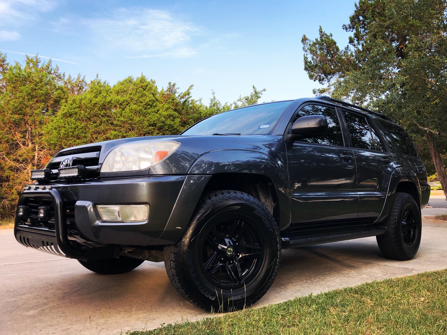

4th Gen C4 Low-pro install w/winch & other goodies.
A big shout out to Michael at Adventure Motors (https://adventure-motors.com/) for doing the install. They are a great group of people doing great work on Toyota rigs. I can't say enough good things about them and highly recommend them for sourcing or building out a rig.
Just picked up the 4Runner today with a C4 Fabrication Lo-Pro winch bumper install with LED light and license plate mount (06-09 4Runner | C4 Fabrication).
Also had Adventure Motors hook me up with an ARB diff breather kit, ARB on-board air, and a CB install. Ready to get out on the trails!

That looks really nice, the W6’s are my favorite JL sub. Bet it sounds great.
sounds alot cleaner than the 2 15s i had. i got about 1600 watts on 1 ohm load from my amp, its plenty loud and clean. cargo space is about the same when i had the ported box for the 15s.

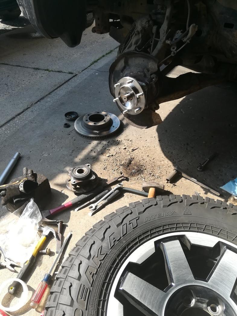

Replaced Wheel Bearings
Replaced both side wheel bearing assemblies. Driver was on it's way out and passenger was past due. No more bearing noise! These were a PITA to get off...broke 3 flat heads and a chisel but they eventually came off. Now to diagnose this squeak when I turn left....

5th gen? If so what is you mileage and driving type? See alot of dirt?
Sent from my SM-N950U using Tapatalk
Nope, 2007 SR5 with 5th gen TRD Off Road wheels. It sees a decent amount of dirt and mud. I have had the CV's replaced a while back and now the bearings. Only thing I can think of now is something with my brakes which I will be replacing soon as well. 138k miles
