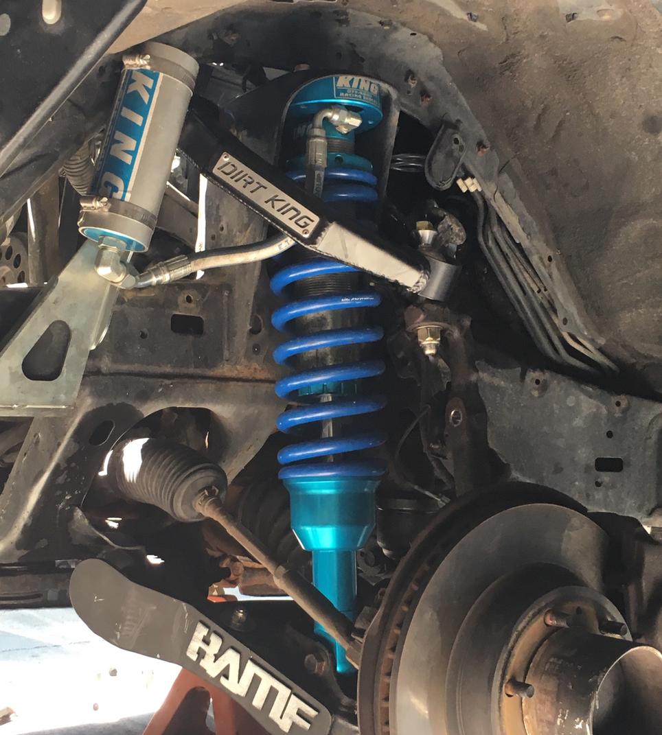

New fun stuff
Added some good stuff this last week
Kings
Dirtking UCAs
Prinsu
RCI front skid and sliders
BaMF lCA skids and other random goodness
