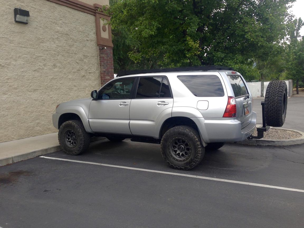

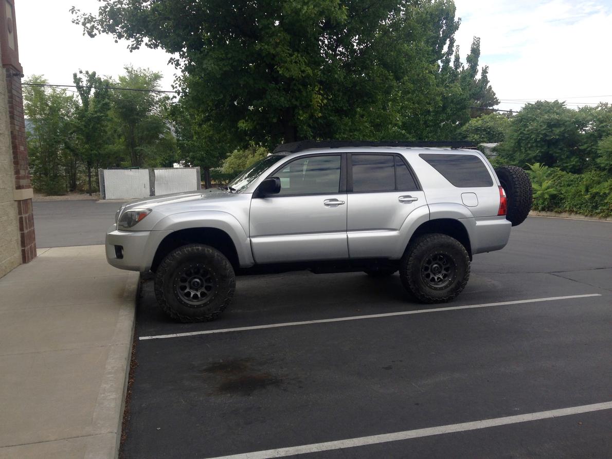

Finally got my Wilco Hitchgate Solo High Clearance tire carrier. Now to mod it, bringing in closer to the 4Runner, and get my bike rack on there. Installed with my matching full size spare tire/wheel.
Just as an FYI, I originally planned to move mine in closer, but then realized I wouldn't be able to carry any fuel/water cans if I did. With the can holders, there's not much room between the cans and the hatch.
Good point. Which hitchgate receiver hole are you using? I'd like to use the second hole, but there doesn't seem to be enough material on the back of the factory hitch for the hitchgate to be secure. Your hitchgate looks much closer to your bumper then mine. I wonder if the "solo's" hitch sticks out further?
Nice rig btw!

how are you going to mod it? I have my eye on one of these instead of a full rear bumper.
I'm considering 2 potential options, with one idea being far more invasive than the other. The "easier" route would be to cut the hitchgate receiver tube shorter (following the factory angle), and drill a new hole. This will also require having to weld in a new filler plate inside the hitchgate receiver.
My other more invasive idea would be to cut the receiver off the hitchgate, leaving me with just a swing out tire carrier. Then cutting a rectangular hole in the factory bumper that the swing out portion of the hitchgate would go into. I would then bolt it to the frame.
All that being said, the easiest thing to do is what "YetiX" did, and just put a rotopax, and highlift jack behind the wheel to fill the gap.
Ideas, ideas.....lol
Regardless of what i decide to do, the hitchgate solo hi-clearance tire carrier is very well built, and rock solid once installed.
Nice rig btw!
Thanks! I am using the second hole. There is barely enough material to grab so the Hitchgate is secure. You just have to mount it carefully and make sure the wedge stays in place. I've dragged mine off-road, slammed it on drops and it's held just fine.
