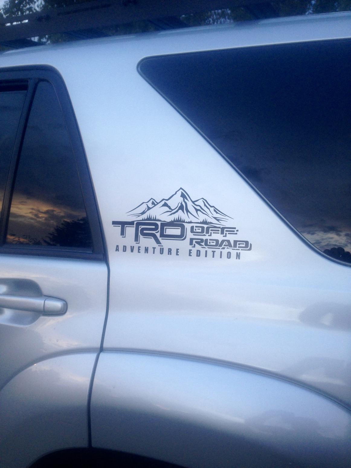

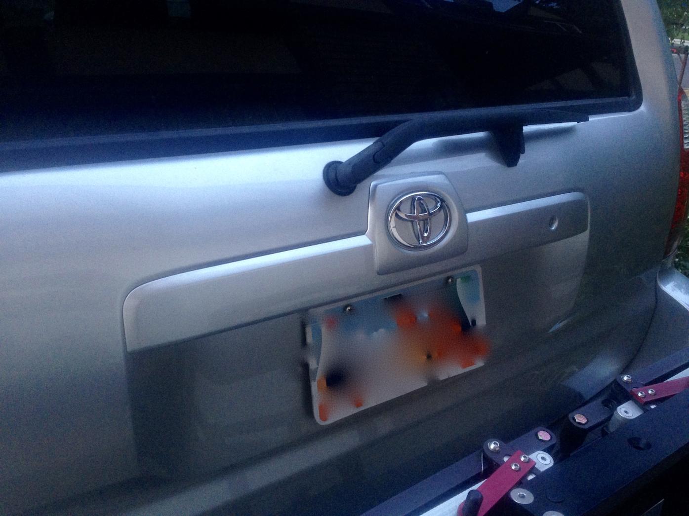

No more Chrome! And new badging.
Changed out the tailgate garnish to a color matching one. No more chrome! Also got some new badging.
