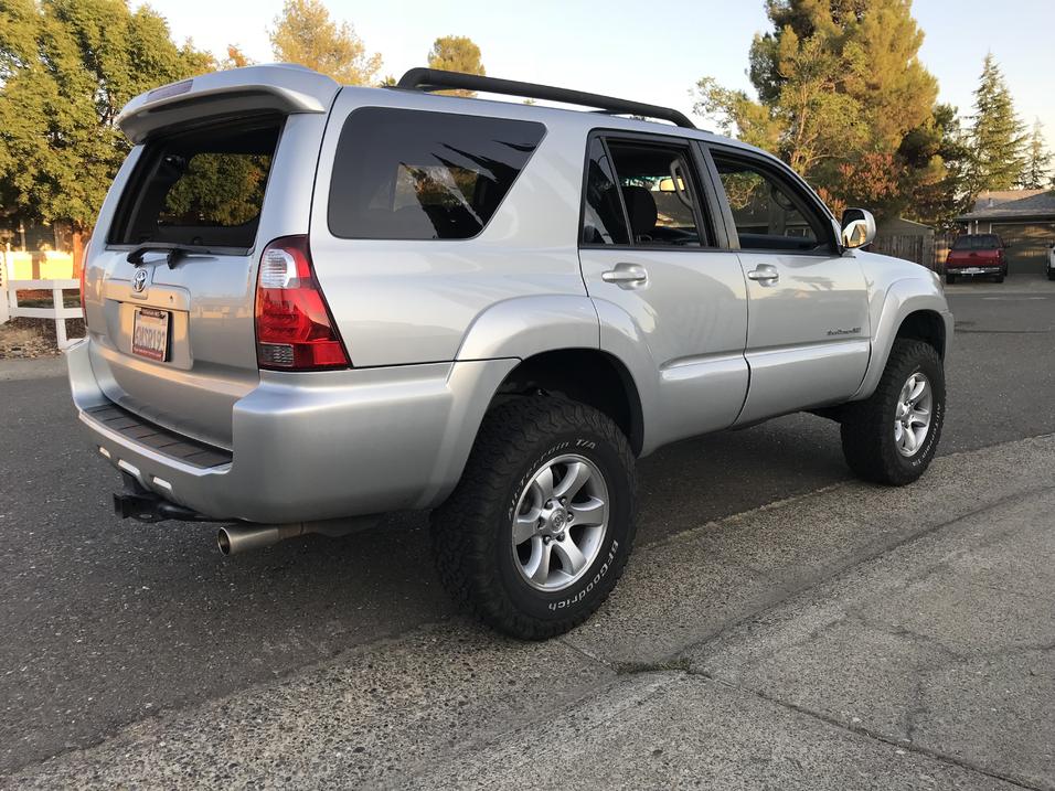

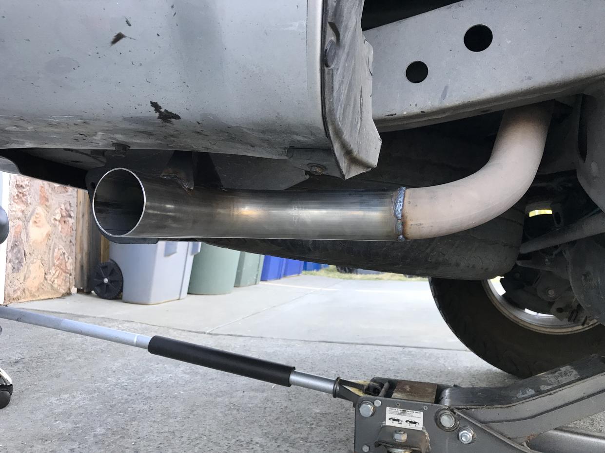

Have been wanting to do that so I can roll the rear window down while moving. Any change in sound?
Not only does it help or fix the rear window fumes issue, it also makes it so you can use a rear hitch cargo carrier and not melt or set things on fire lol. Which was my purpose of doing this originally.
If there is a change in sound its extremely minimal and im the only one who notices it, But it might be slightly louder and deeper sounding.
The whole job took all of 5 minutes and the hardest part was wondering why I put this off for so long. lol

once you cut it off behind the resonator, what tubing did you use for the side turn? i have a v6, and am considering doing this because i drive with the rear window down often/for my dog...
I’m about to do that mod as well. Only I picked up a mandrel bent piece of 2.5” stainless tubing off eBay for $25. I plan to polish and weld to the exhaust. Will post before and after when I’m done
That's pretty much what I did. I painted it with flat black engine enamel because I don't like shiny things.

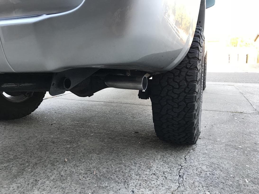

Getting all the cheap mods out of the way haha. Resonator delete made it a TINY bit louder but nothing really noticeable. Did it more for the side exit and to not smell exhaust fumes with the back window down. Also picked stainless so it'll never look like poop, just my welds will :cool:
