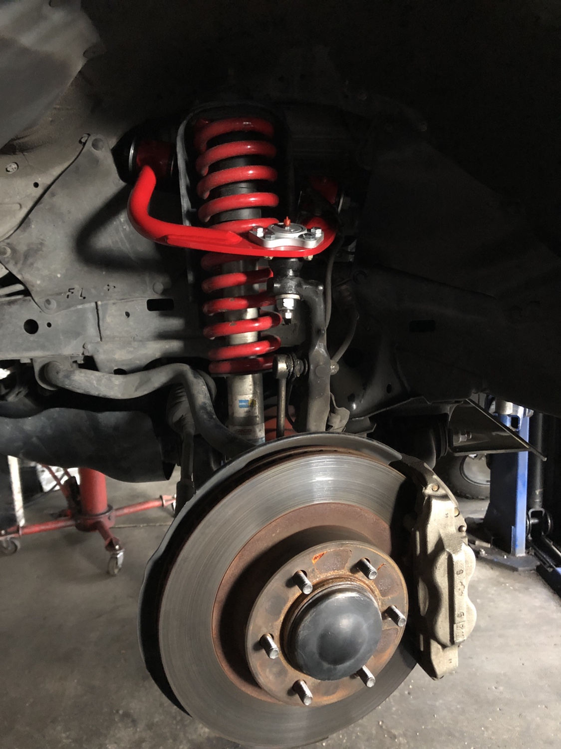

Installed new JBA UCAs. Look nice next to the Dobinson springs.
